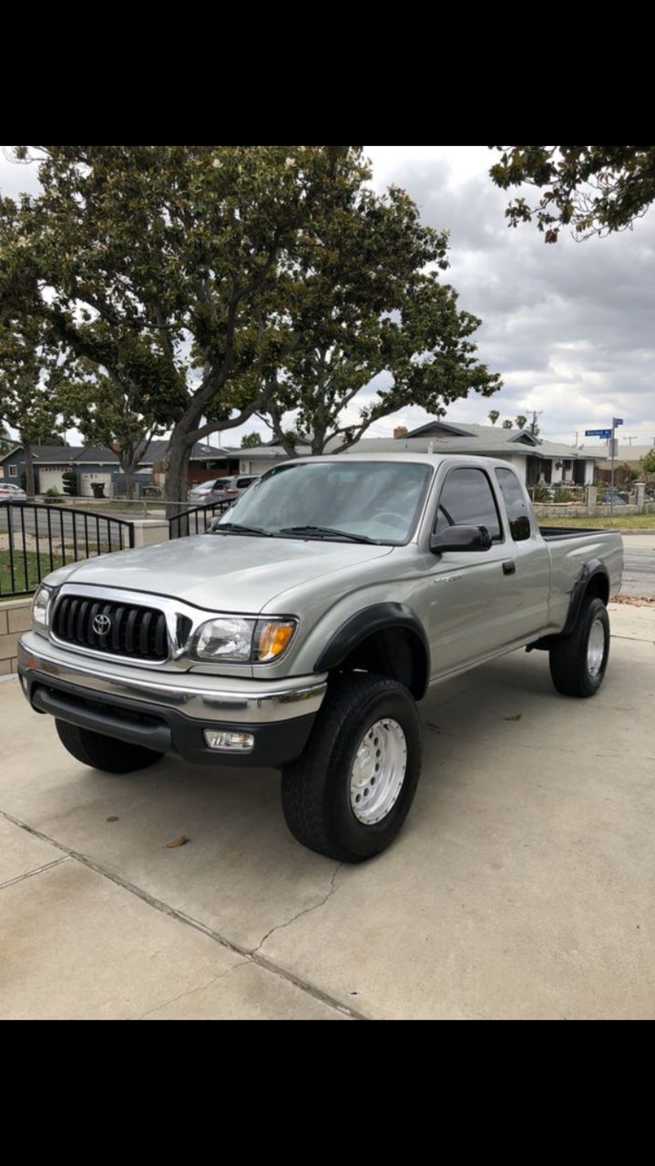

    My 2002 Tacoma 2.7l automatic has 217,000miles on it. What can I do to make it last another 200,000miles? I only use chevron gas, Mobil 1 full synthetic 5W-30 high mileage oil, Toyota factory oil, air and fuel filters. Oil change every 3,000miles, add a bottle of Chevron complete fuel system cleaner every 3,000miles, air filter every 15,000miles, fuel filter every 30,000miles, and coolant every 60,000miles. Any more recommendations or thoughts? Just trying to do the most I can to make her last a long time.

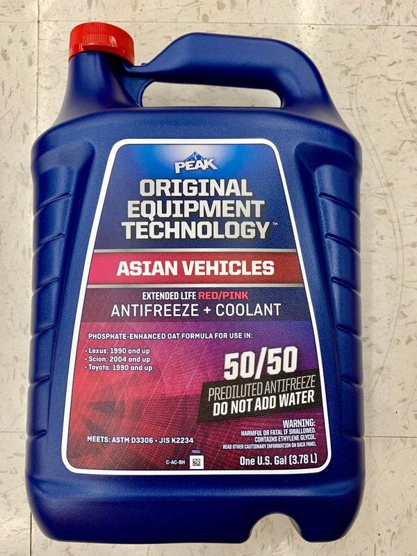

    What coolant do you run?
    My experience, and that of techs I've known and trusted for decades, is that Toyota vehicles really do like Toyota red coolant the best. It's one of those cases where OEM is better, IMO.

    This is the coolant I picked up for my truck. do you recommend a different one?

    I recommend the Toyota-brand red coolant (pre-diluted or concentrate if you can still find it). The aftermarket brands are "probably" OK, but I don't have experience with those.
