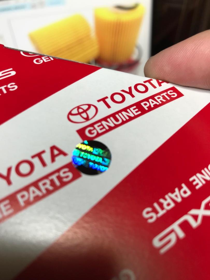

    If using OEM Toyota filters, they should be genuine if below hologram in on the box.

    Good point on the hologram thing. I never noticed the boxes on the oil filters even had them until I bought the filter at wally's

    a side note on that, they can be copied as well. All the tech to forge a filter and box, surely a little hologram too.
    -Sucks that it is like that.
    Menards offers Bosch filters for about 5$ -usa made, good quality for another option

    Difference being, it's extremely difficult to prove a filter and/or a filter box is counterfeit without a time consuming and expensive material analysis, however a simple scan from an inspector's wane can confirm that a hologram is counterfeit.
