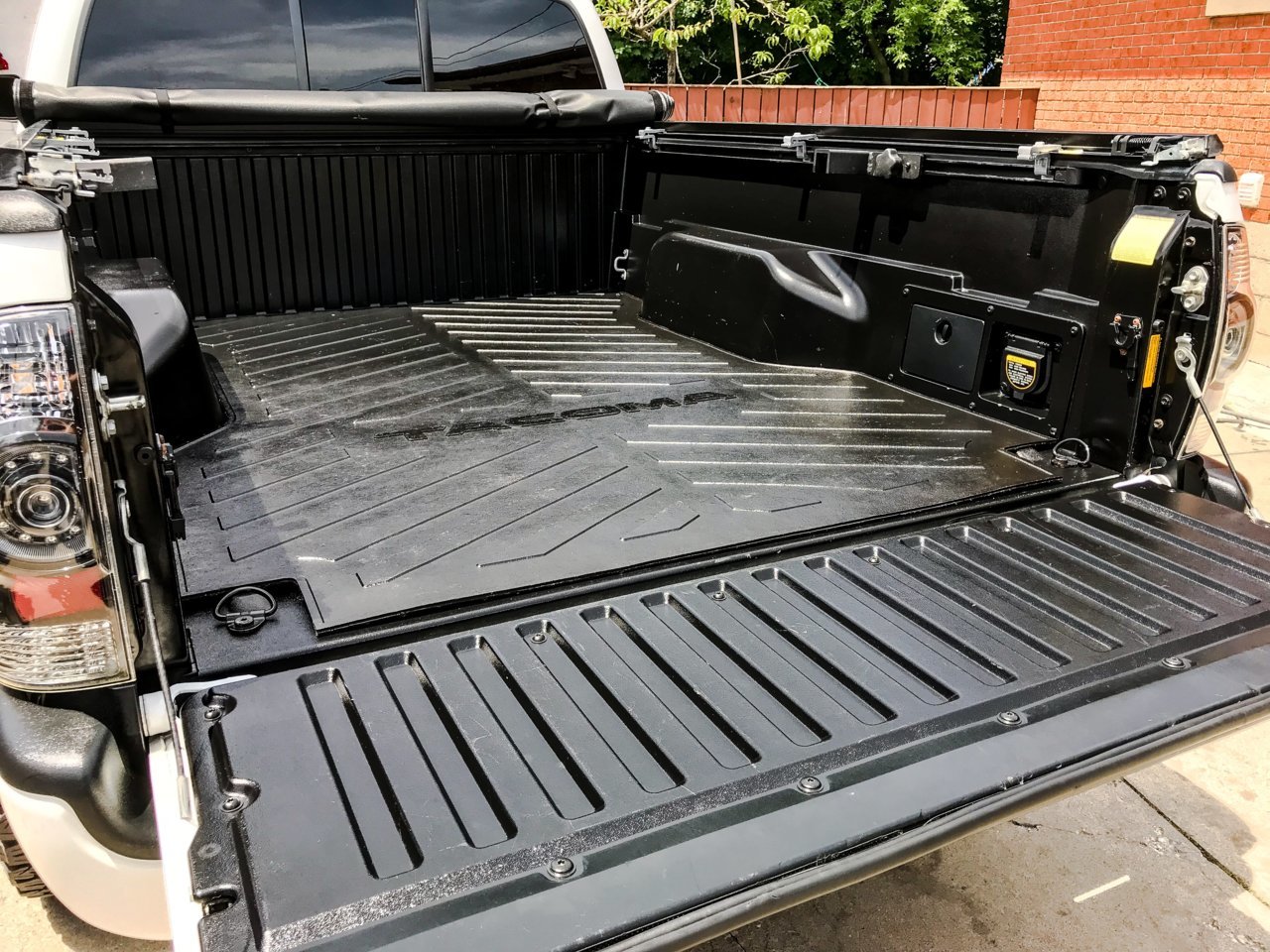

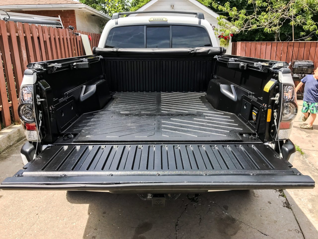

    Bw s256 turbo with 3 in glass pack dumped pre axle raptor liner bed and top rails and fenderflares and rocker panels. Hunter side steps. Plasti-dipped upper fenders and emblems. satin black spray paint here and there inside and out. 5100's set to 1.75" up front . C channel front bumper. Maxxis bighorn 255/85/16
    Hey sorry it took so long. I sanded everything down with 220 grit and wiped it with denatured alcohol. I did 3 coats on the floor of the bed and 2 coats on the walls of the bed. The only chips it has is from me hauling some metal tubing. I will say on the body it sticks great where it was sanded but I taped my lines off and then sanded so that I didnt accidentally sand where I didn't want to and all the edges have chipped because I couldnt sand all the way to the tape edge without messing up the tape. My clear coat has started getting pretty bad and one day I will raptor line my whole truck hopefully

    Hopefully you found a better way to do it than by hand?
    Getting in the grooves of the bed floor would be “tough”.
