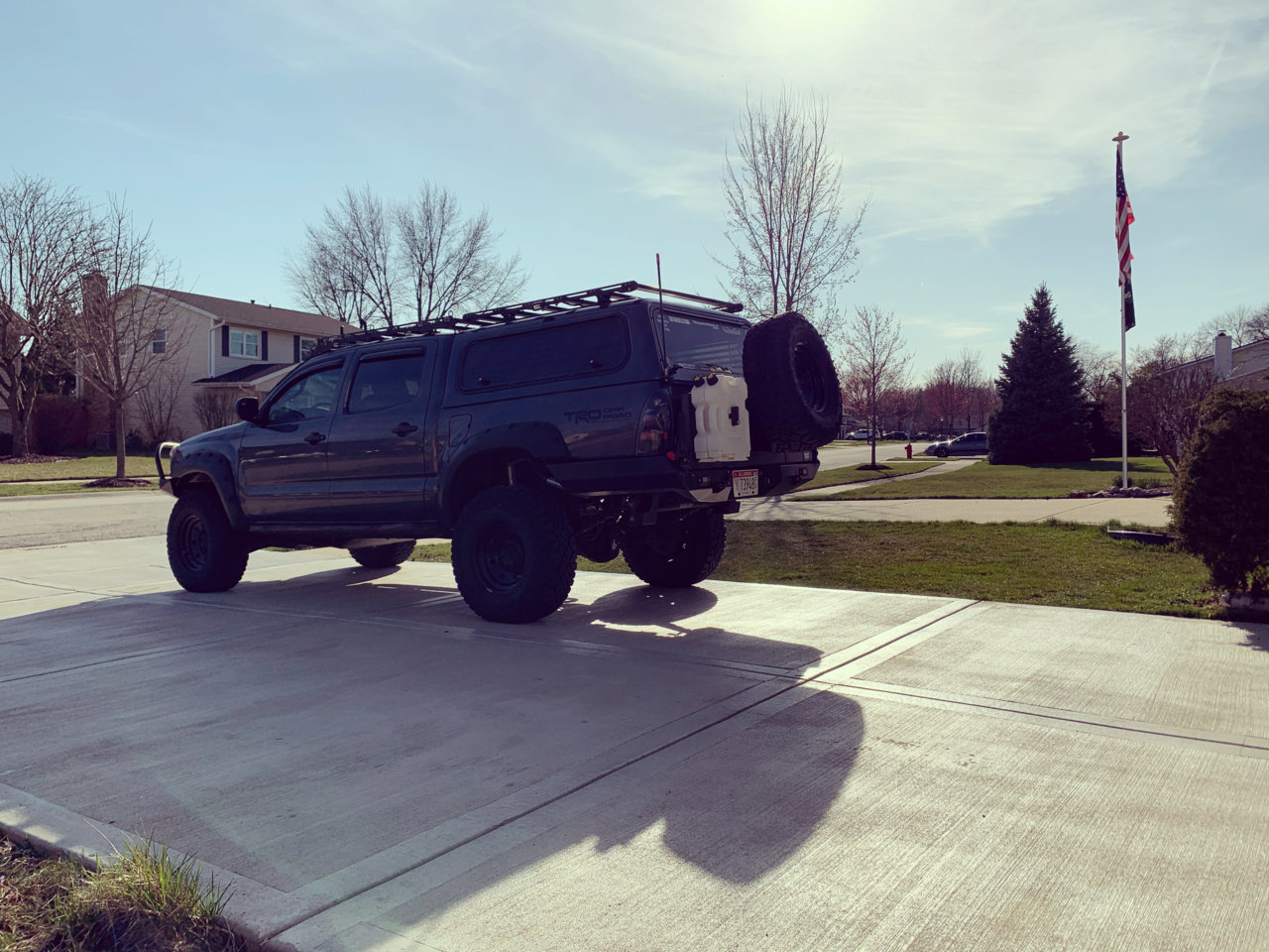

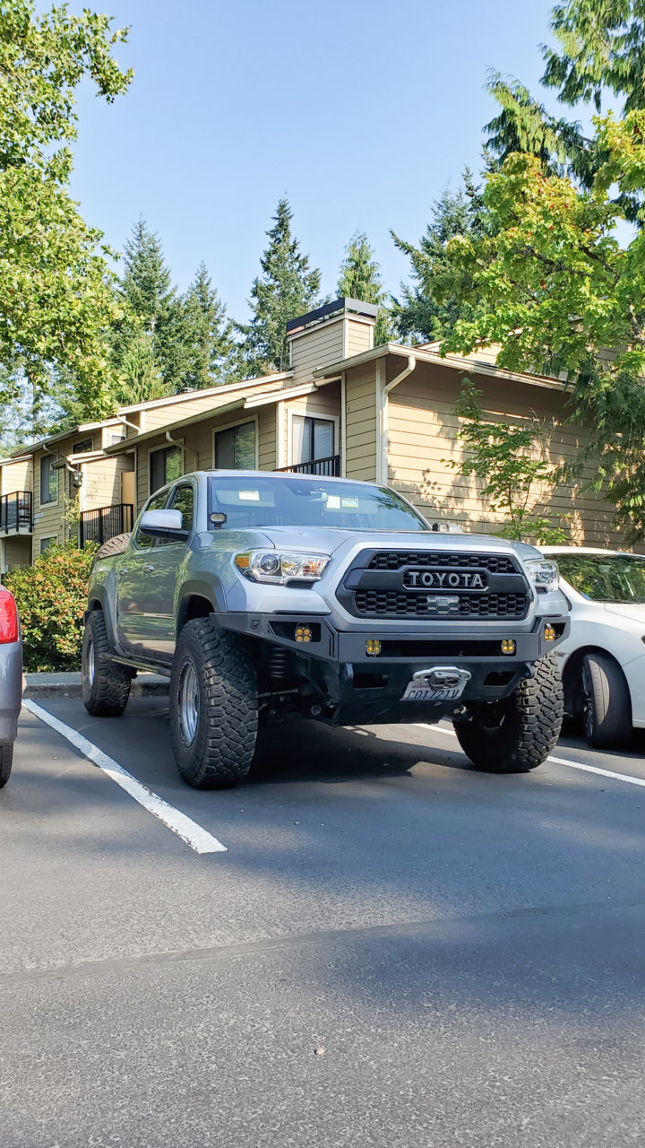

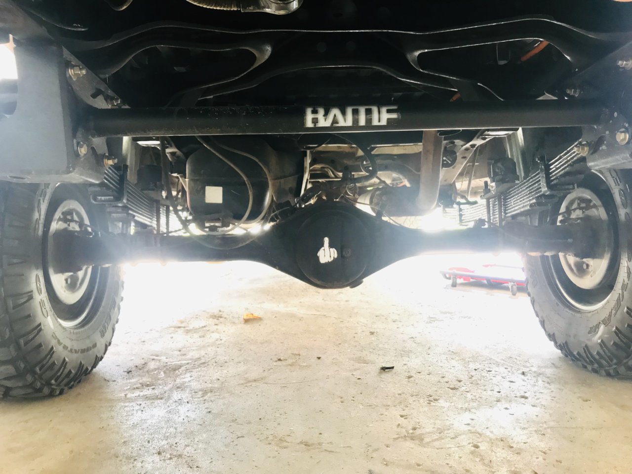

    Calculate your weight you carry every day. I had HD Dakars in the rear and I was about 600lbs daily driving. Upgraded from the Dakars to Deaver stage III u402's:
    506CA95C-65BB-437F-9294-35A8A2A09901.jpg 848D961A-73AC-414E-BB32-7062727BFD22.jpg
