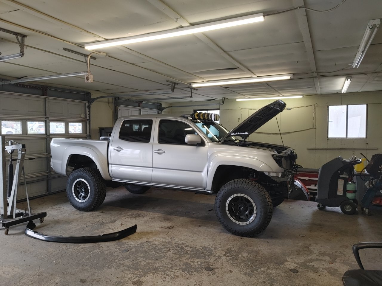

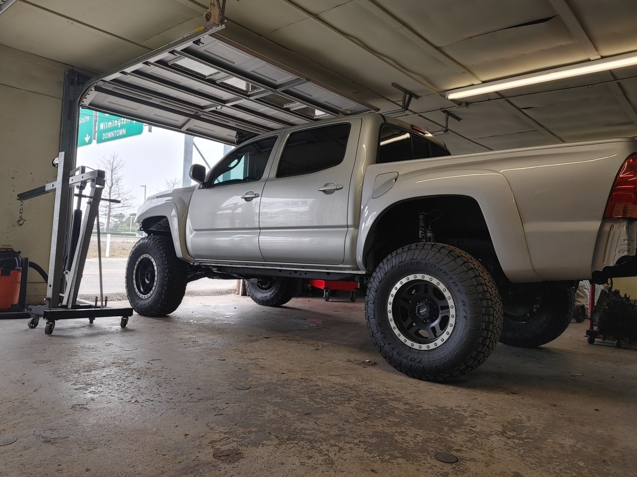

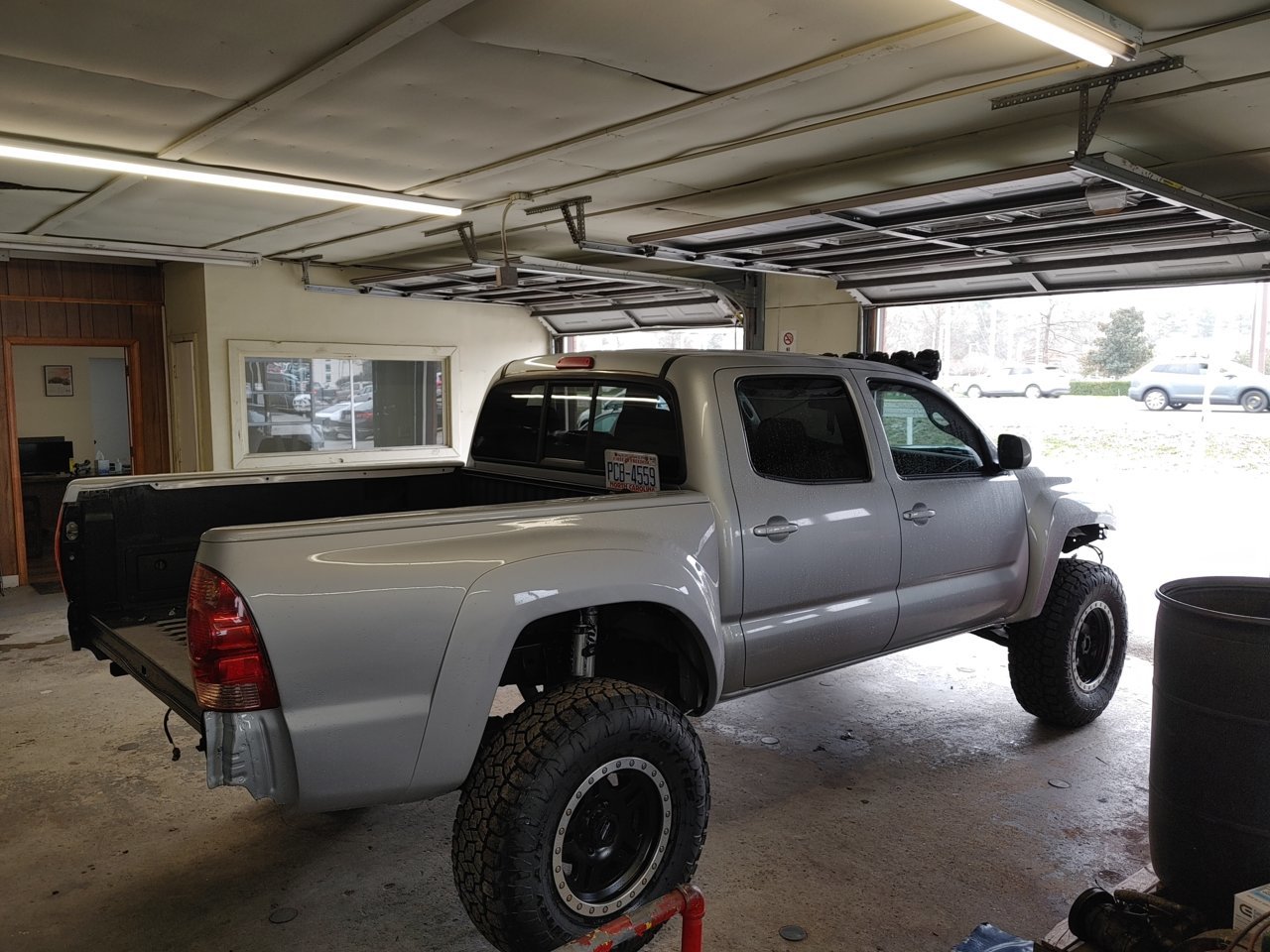

    I need a different rear leaf pack.
    Im running ome dakars, heavy. My ass end sits so high and I have no way to measure how high over stock I am.
    Running 35s and fiberglass.
    I carry 0 weight 99% of the time. I will say the few times Ive been loaded down with mulch I drop at most and inch and it rides great.
    I feel like I cant enjoy my expensive front suspension when the rear is kicking up every bump I hit.
    Im looking for something off the shelf, i got a quote from alcan and they want 1300$. Im sure theyre the best but I can settle for 2nd best.
    I feel like Im 4 inches over stock in the rear at this point. I want no more than 3 and a good ride unloaded.
    Help?

    Take a tape measure and start scouting parking lots.

    Take a leaf out of the heavy pack. free.

    Remove a leaf or 2 depending on how many the leaf pack has.
    it’s free and it’ll soften up the rear.

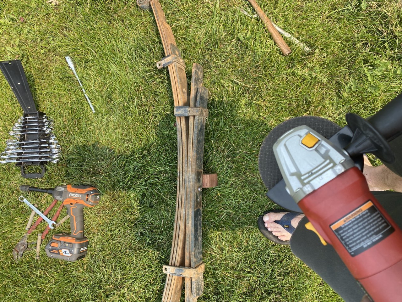

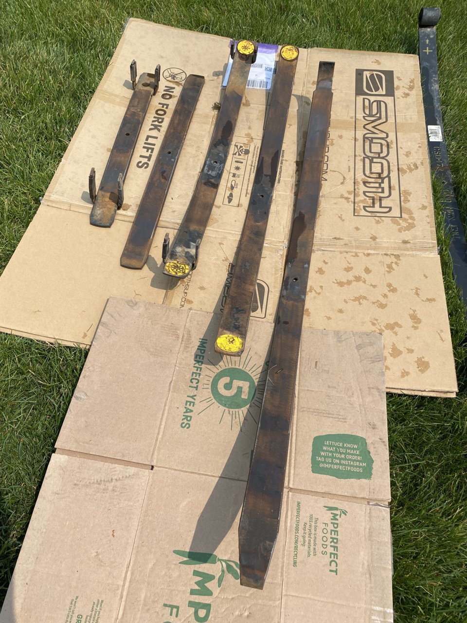

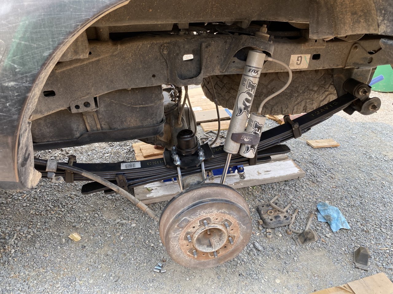

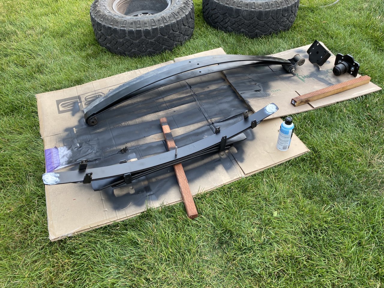

    I have Dakars (old version) and pulled the 3rd leaf which is similar to the current medium Dakar. Ran them this way for 4 years before adding the leaf back. I was happy with the way they rode, the truck was just getting heavy for that setup. If you have the AAL with the leaf pack definitely remove that.
    Clean them up when you pull the leaf and they'll look good as new.

    Awesome, will try tonight. Will I be losing lift in the amount of the thickness of that leaf? Or should I remove 3rd along with long overload? Im trying to lose lift and soften it.

    Your initial question was about measurements.
    Center of hub, vertical, to the edge of fender is a good reference. Using the hub center takes the wheel/tire size out of the mix.
    So measure yours as is and ask here for folks with stock suspensions to give you their measurements.

    Removing the 3rd changes the spring rate. I guess I lost about 1/2" to 1" when removing but never measured

    Hub to fender won't give him comparison to a stock truck since he had fiberglass fenders.

    Im running fiberglass fenders though.
    And thats 3rd from top correct?

    SoCal
    13 DCSB TRD OR v6 Auto
    the 3rd and 4th leaf (from the top main leaf that has eyes on both ends) on your heavy pack should be the same. Pull the 3rd leaf from the top and this nets you a dakar "medium" pack.
