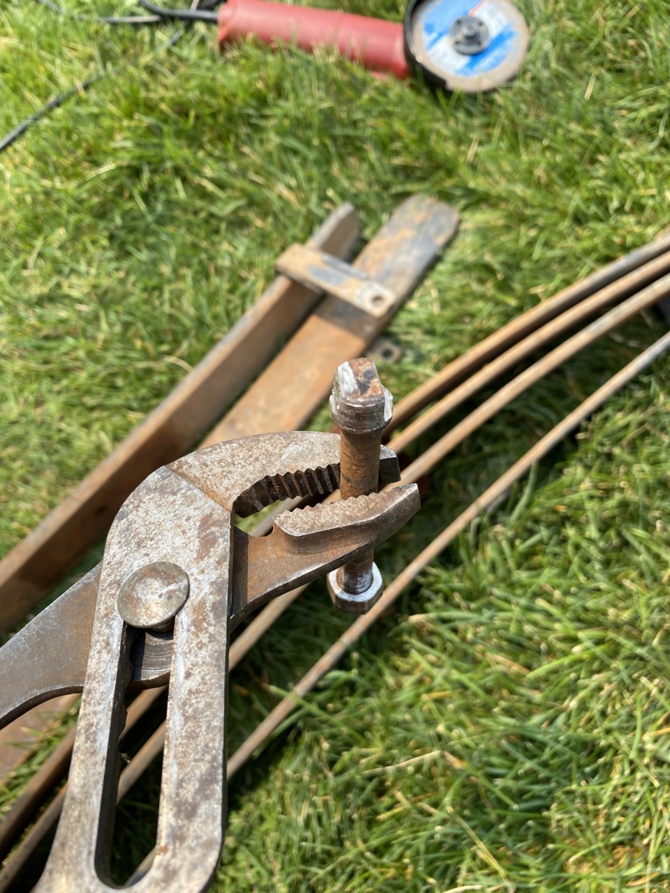

    Did you have to modify anything on the pack just to remove 1 leaf?

    I had to cut 1/4" or so off the centering pin on the leaf pack.
    You may want to pick up a new centering pin...I had to notch the pin when I removed it most recently because it was pretty crusty. I made two cuts on the round end so I could hold it with channel locks so it didn't spin on me.

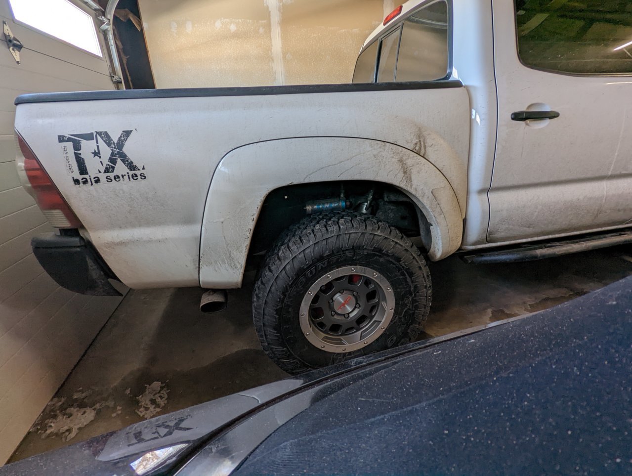

    Top of axle tube to bottom of frame rail is 8.25" stock and is the easiest way to remove all other variables to figure out your height.

    With 12 inch shocks I have 9 inches of shaft showing static. Cant wait to rip a leaf out

    Goddamn dude, that's so incredibly high. Def pull a leaf and you could even pull one of the overload leafs if you wanted, that's what I did when I still had dakars.

    When you have custom fenders, the way to measure and compare lift is top of axle to frame distance.
