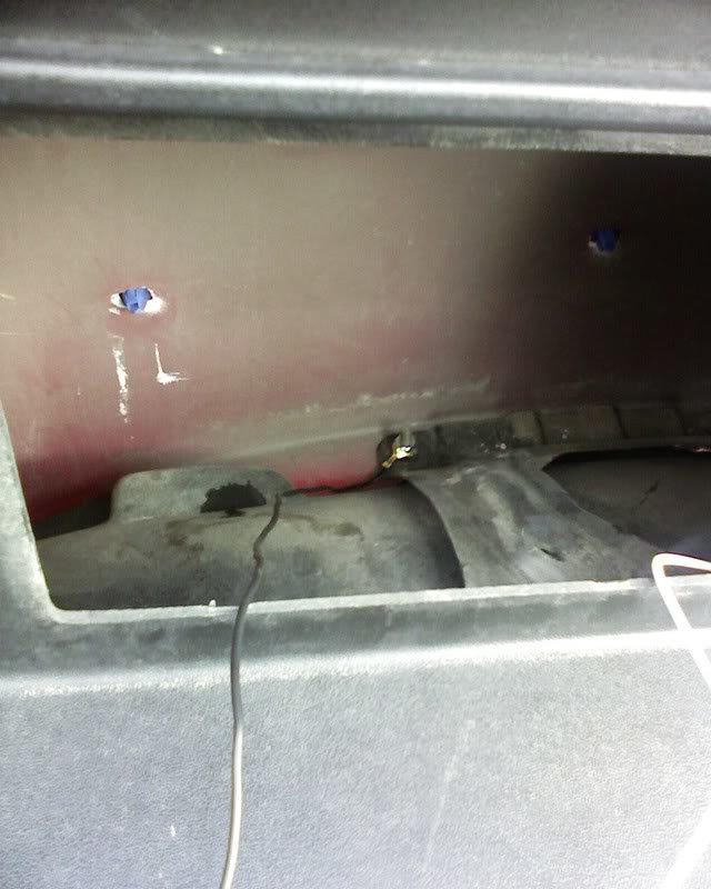

    Hey guys. Looking to install some OME fender flares on my 07 reg cab. Already bought them and have them. i see the holes where the flare lines up and bolts on. But i don't know what to use to get them on there. The holes don't seem to be threaded. Do i use some sort of fastener??

    I accidentally took a picture of it. here:
    You'll see theres these blue clips. go to toyota and pick up a million.
