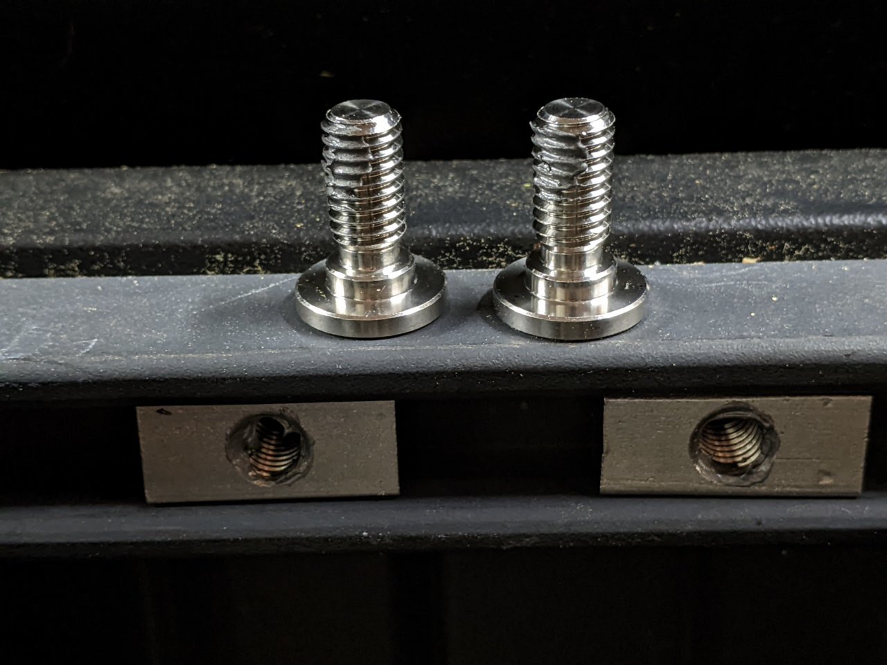

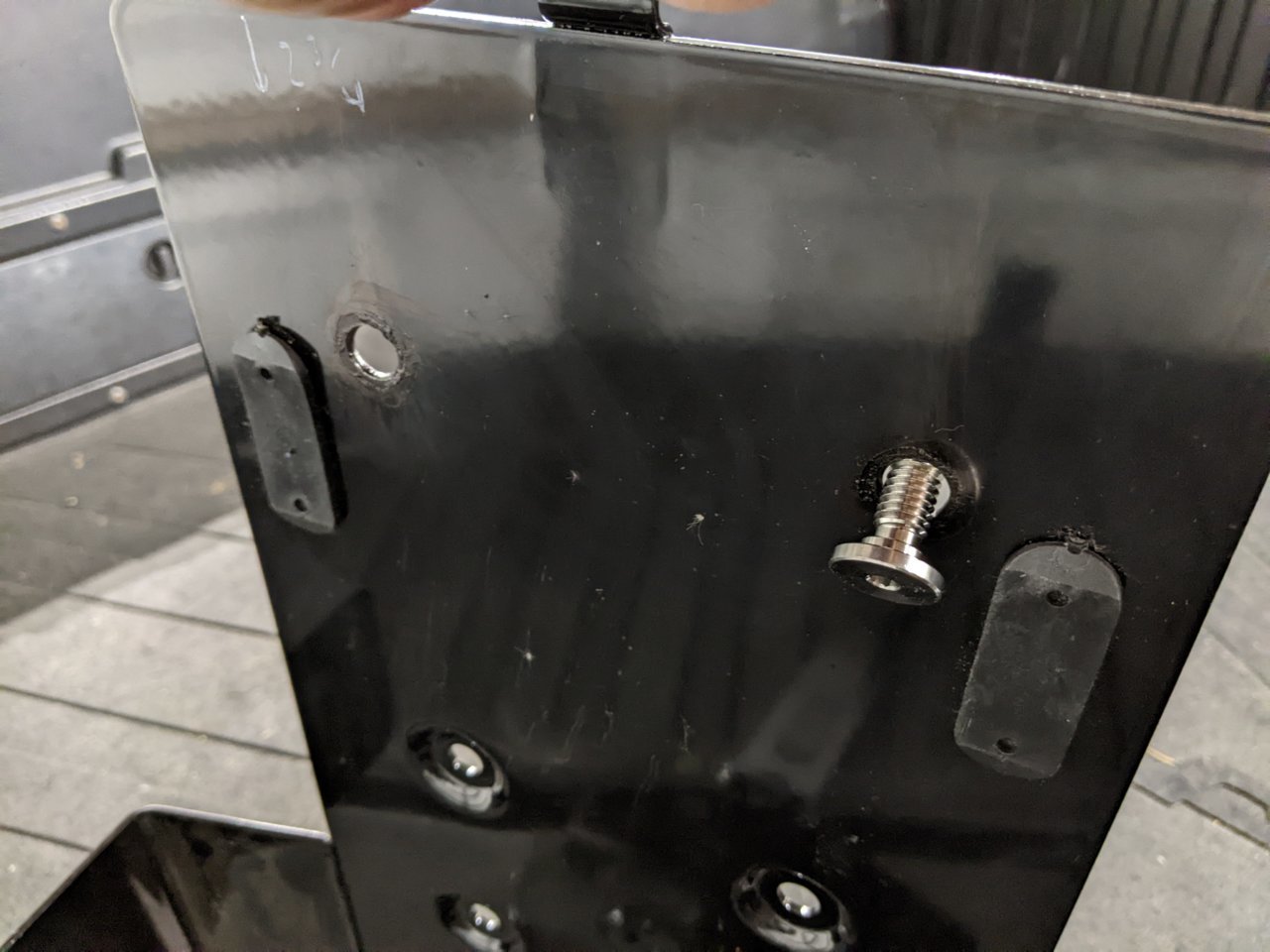

    I ordered some generic stainless T-nuts on Amazon (https://www.amazon.com/dp/B07TYLVYPX) and used a couple for this. Also purchased from McMaster some ultra-low profile socket head cap screws l, 3/8-16x3/4 lg (https://www.mcmaster.com/91223A229).

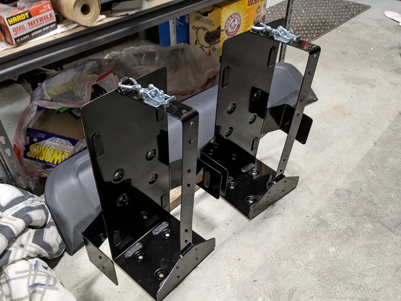

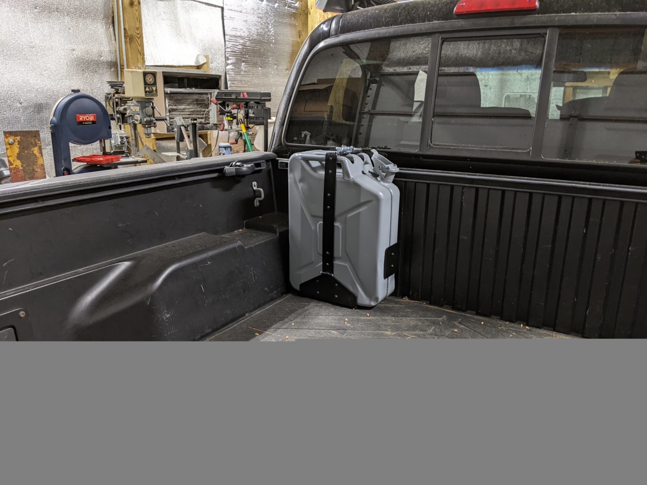

    As received, two front loading Wavian holders - confirmed to work on the NOS surplus jerry cans from Coleman's.

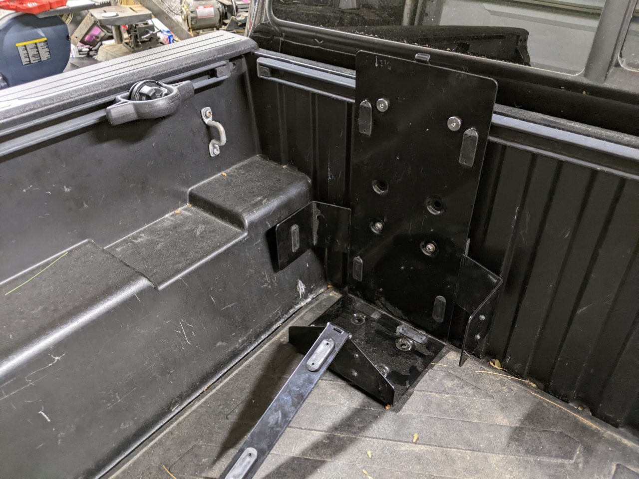

    After lining up and measuring, I popped two holes in the back plate with a 7/16 step bit. 2-3/4" from the top and 2" in on each side. This takes into account the can holder sitting on the bed mat.
    Critical step - apply anti-seize for any stainless-stainless connection to prevent galling.

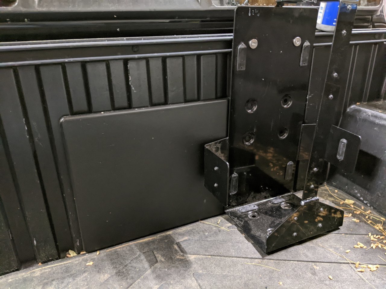

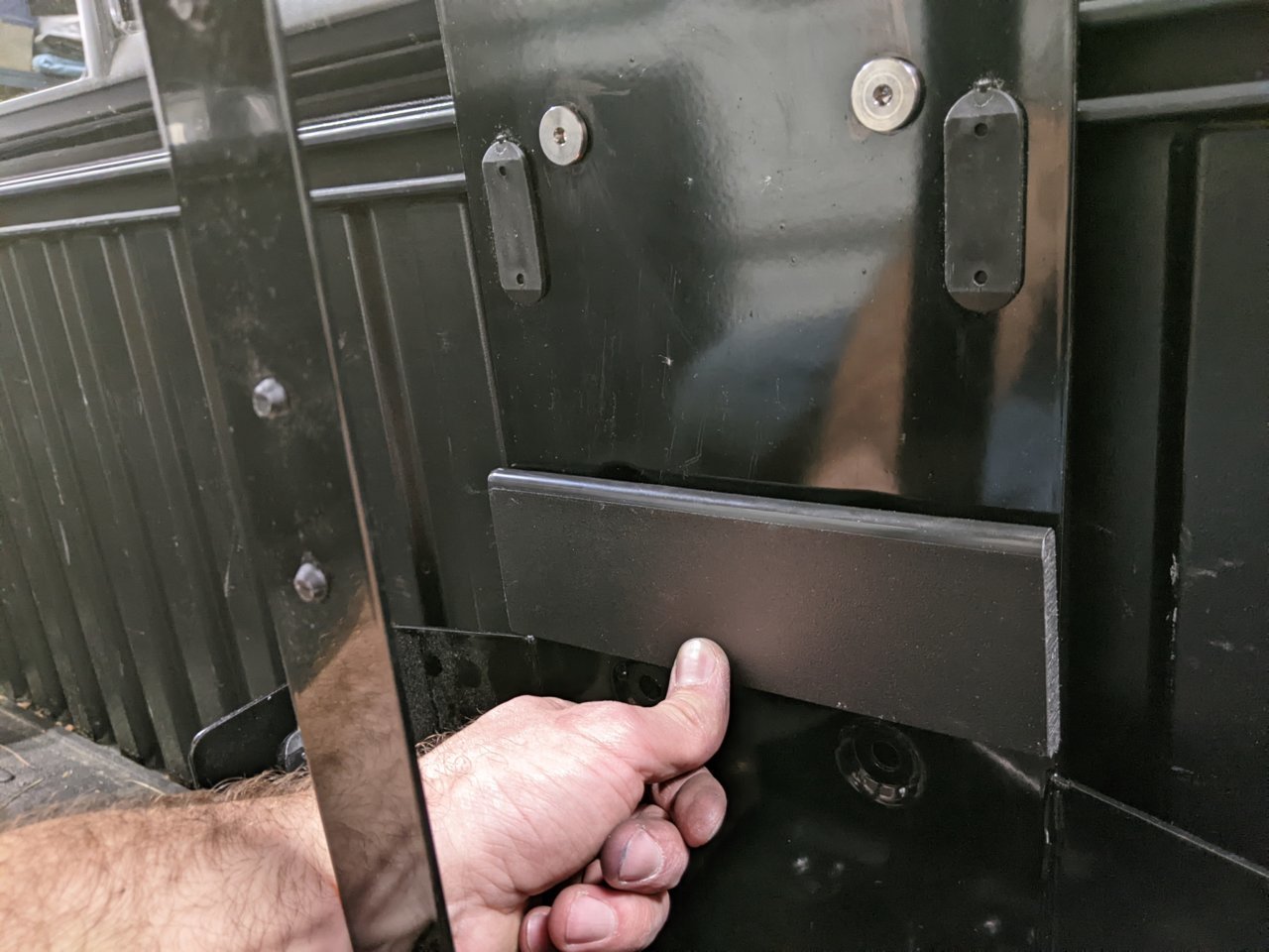

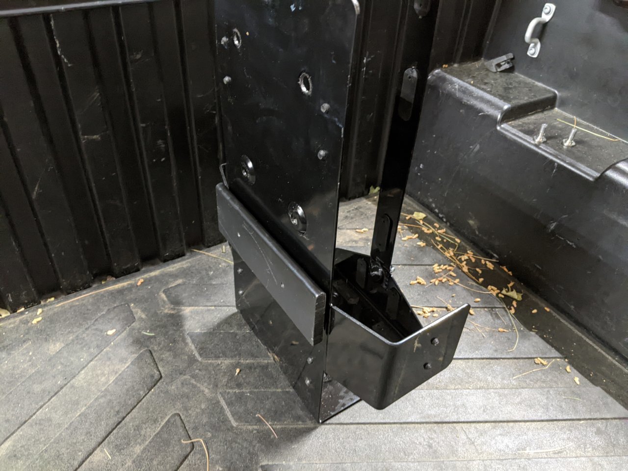

    After confirming the holes lined up, I took a cheap 1/2" HDPE cutting board (https://www.amazon.com/dp/B076G1797P) and used it as a spacer for the debossed holes lower on the back plate. Cut dimensions ended up at 2-3/4" width by 8-1/2" length.
    Drilled a few 3/16" holes for #14 coarse thread stainless screws I had from another project. Had to take the point off with the grinder to ensure they didn't protrude.

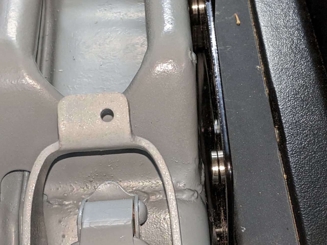

    When tightened to the bed rail, the top rubber bumpers on the can holder are pushed out slightly and provide additional clearance for the socket heads - plenty of clearance.
    Jerry can sprayed with some gray enamel and hardener from Ace. Finish is alright but the Wavian holder has a few spots that still rub - nothing to worry about for a 1952 gas can though.

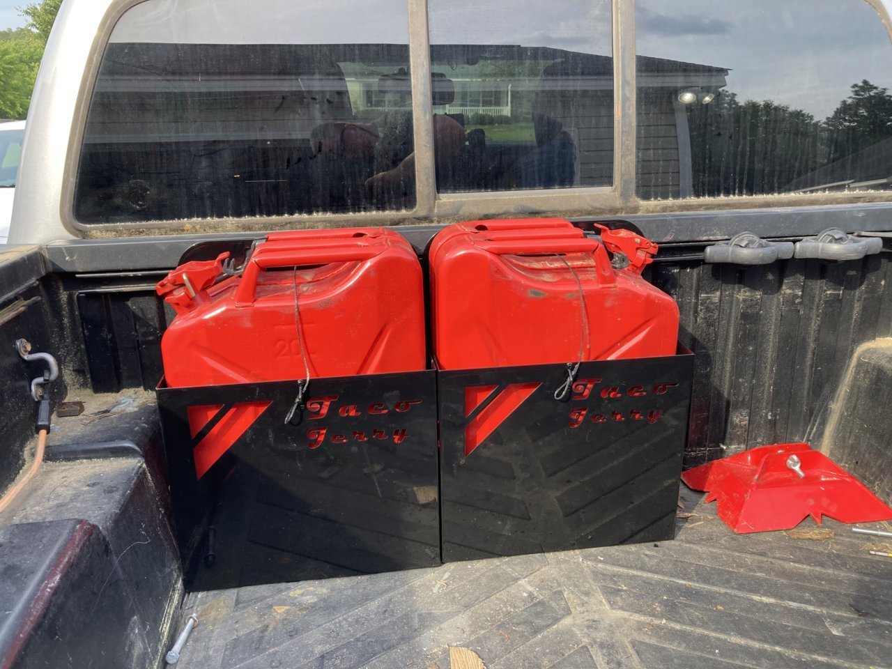

    You could potentially skip all the hardware mods and just go with a Taco Jerry! Just a thought. www.tacojerry.com
  5. Jun 26, 2022 at 2:35 AM
    Sheepnick1
    Sheepnick1 Well-Known Member
    Oct 29, 2019
    #309410
    213
    Nick
    2019 Tacoma trd off road
    Here’s a pick
