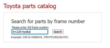

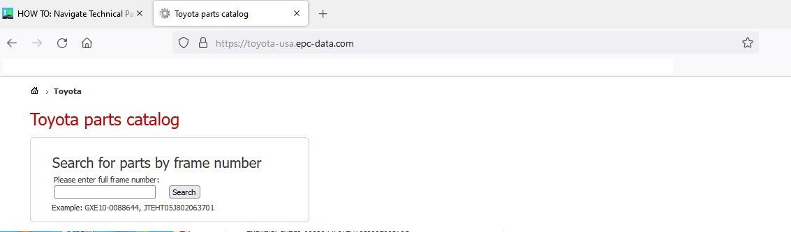

    I use the frame number (it's on the sticker with your VIN and tire pressure). Mine is TRN220L-TRPDKA
    Go to https://toyota-usa.epc-data.com/
    Enter the frame number

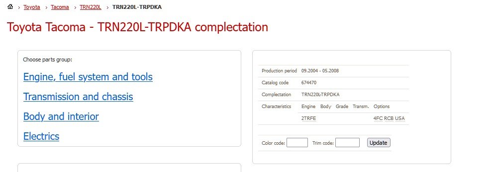

    This page comes up

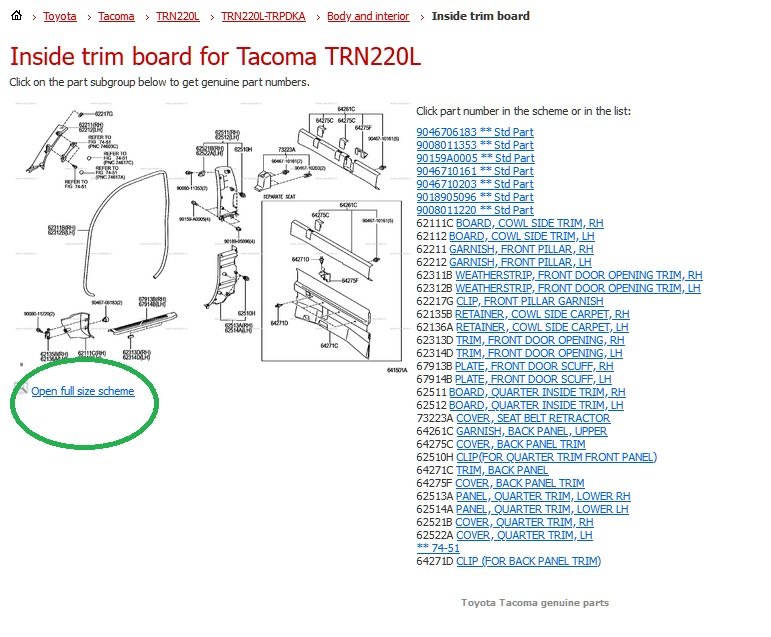

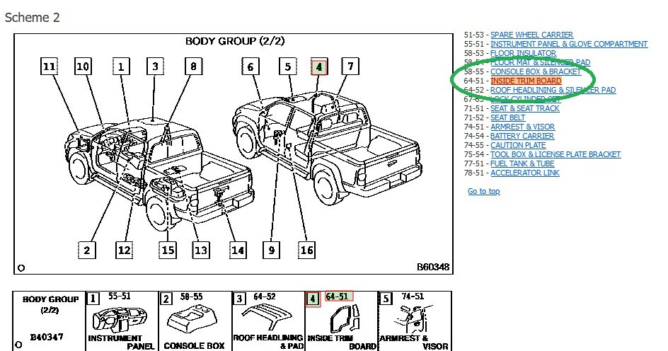

    Choose the parts group, I need the plastic nut that holds the kick panel by the drivers foot. So I pick Body and Interior. It's in fig 64-51, so click on that.

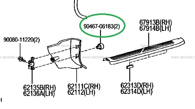

    It's kinda small, so at the bottom left, click Open full size scheme
    And there is the part number

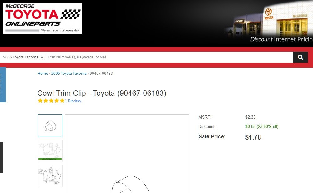

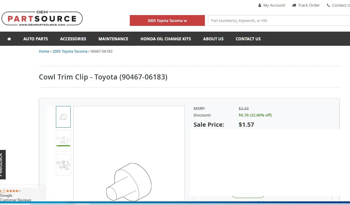

    I buy from OEM Parts Source, the prices are usually less then others and the shipping is about half of what McGeorge charges
    This is $1.78 at McGeorge and $1.57 at OEM. Not a big deal, but McGeorge will charge $35 for shipping and OEM will charge $14 (that's a big deal).

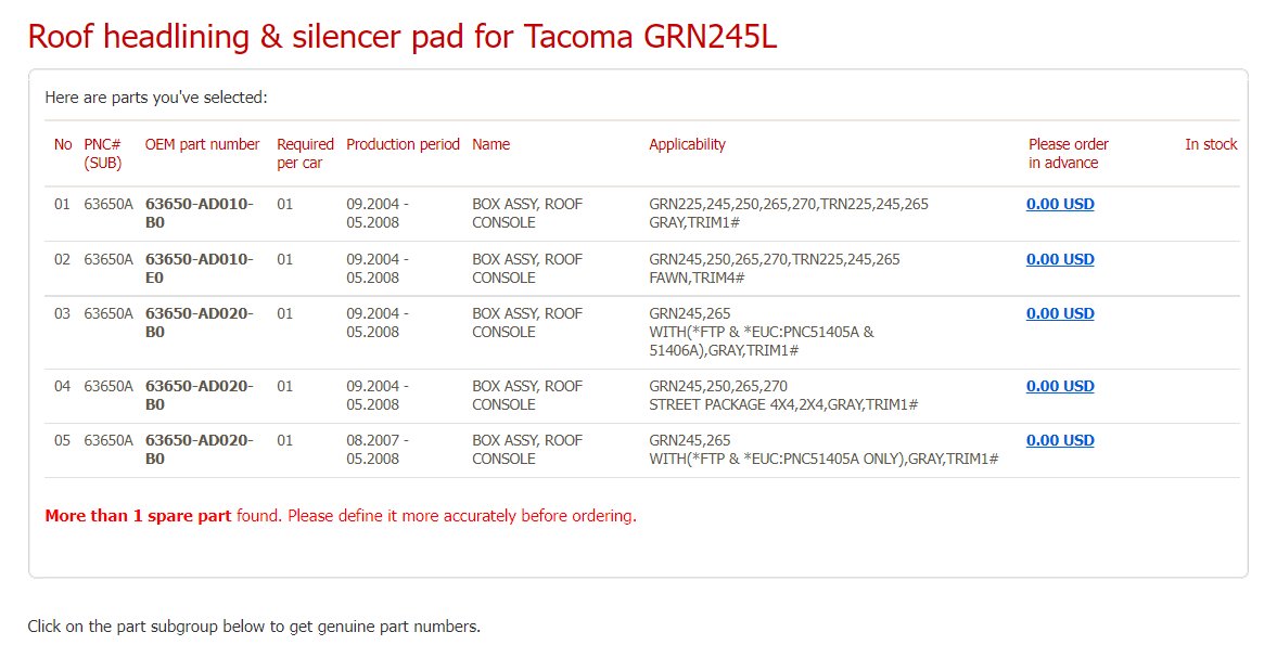

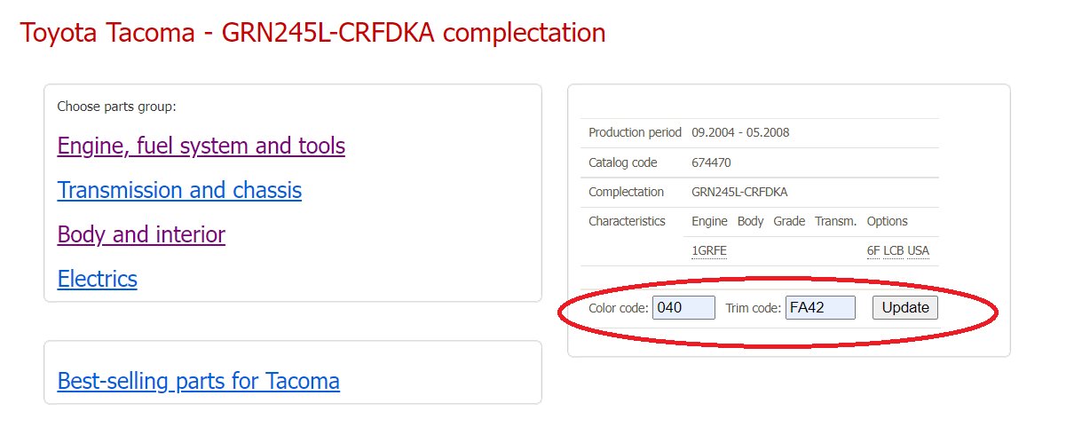

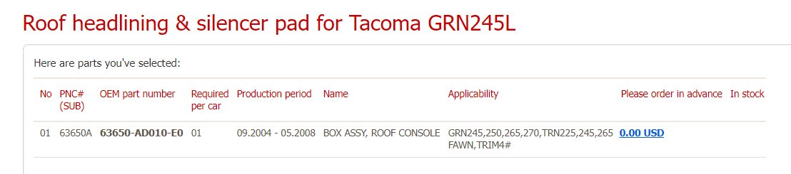

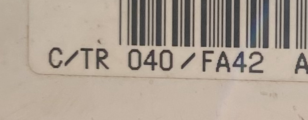

    One thing I'd like to add is you can add your trim code (and color code) to narrow it down even more. Takes this particular example from four options down to one.
    Daves300 likes this.
