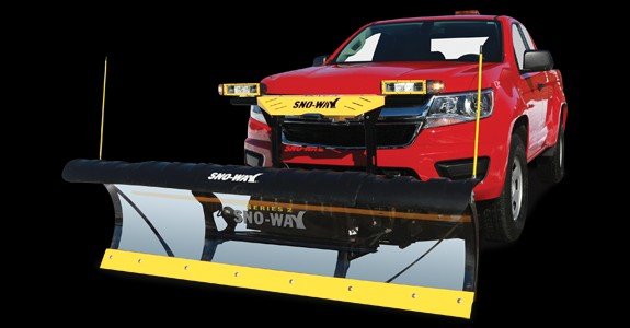

    Leon
    2024 Tacoma TRD
    For those of you concerned about blocking the intercooler... Here's a handy little trick... If you take that yellow piece of metal on the top that says SnowWay and flip it around ( two bolts) it makes a nice airfoil that shoves cold air straight into the grill and won't get covered by the plow blade. Or " Plowflomaster' makes an air foil that you can mount directly to the top of the plow blade.

    I plow with a SnowWay 22 series 2 plow. It works great on my 2024 Tacoma TRD Sport.
