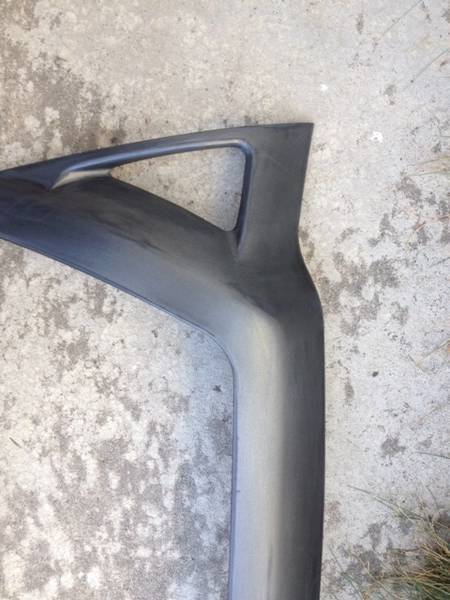

    I have the below standard Gray grill surround, aftermarket, that I need to paint MGM. Do I need to prime this or can I use plastic adhesion promoter and go?
    I was hoping to get away with 1000 grit sanding and some promoter. It is very smooth...

    I sanded my chrome with 100, 200, and 400 grit. Wiped it down with acetone. Then just used spray paint with super light coat. Finished it with clear coat in light sprays. 2 months of pa winter with salt and rocks and its holding up great. It's all in the prep work.

    The best answer is to prep and coat per the manufacturers technical data sheets for the system you buy. Its been 30 years since I painted cars for a living but as I recall most, but not all, systems required an adhesion promoter for plastics.

    Thanks Steel, your probably correct, there will be a lot of differing advice, I think I have decided to Prime it, as the plastic adhesion seem to state over and over it it is for bare plastic... So, I will wet sand and sand... and sand again....

    I could be wrong but I dont think there is anything you can do to paint chrome and have a durable, long lasting, finish. Stuff just needs to removed first. If I were to try I would clean and degrease, sand all the shine off with fine grit, clean again, acid etch the hell out of it, prime, and paint. And still expect it to eventually flake off. But like I said, its been a long time.

    @bootboiler - is that bare unpainted ABS or grey paint?

    There is gray paint on it...

    You are on the right track, no adhesion promoter. Clean and degrease, sand with very fine grit until every bit of the shine is off and you have a dull surface. Be sure to get into all the nooks, crannies, and edges. Clean and degrease again. Use a tack cloth then prime and topcoat if that is what your paint manufacturer says to do or just top coat. If the system requires a clear...clean and degrease, wet sand, clean, tack cloth, and spray clear.

    Thanks Steelhd, it requires a clear, so will follow your directions, thanks.
