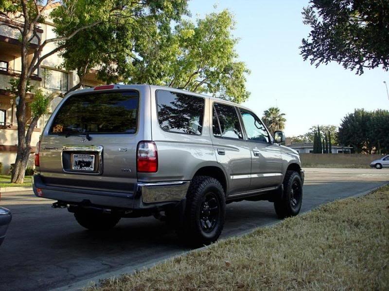

    i just washed n painted with high temp grill paint:D it was windy so i just did 1 coat. if you dont like it, strip it and start over.
