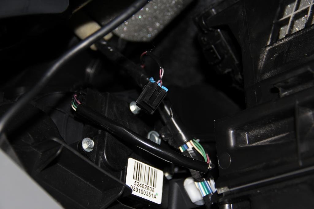

    Step 1: Remove the glove box
    Step 2: Locate AC Recirc Servo
    Step 3: Determine OPEN and CLOSED.
    + For this exercise we will say;
    OPEN = Recirc is ON (button lit)
    CLOSED = Recirc is OFF (button not lit)
    Step 4: Remove servo connector and tuck away
    That's it. Four easy steps and you are on your way to a stress free, and smelly free cabin...

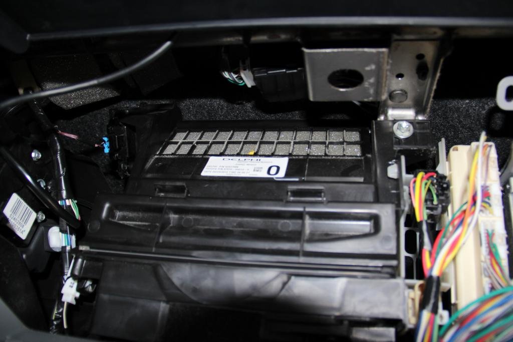

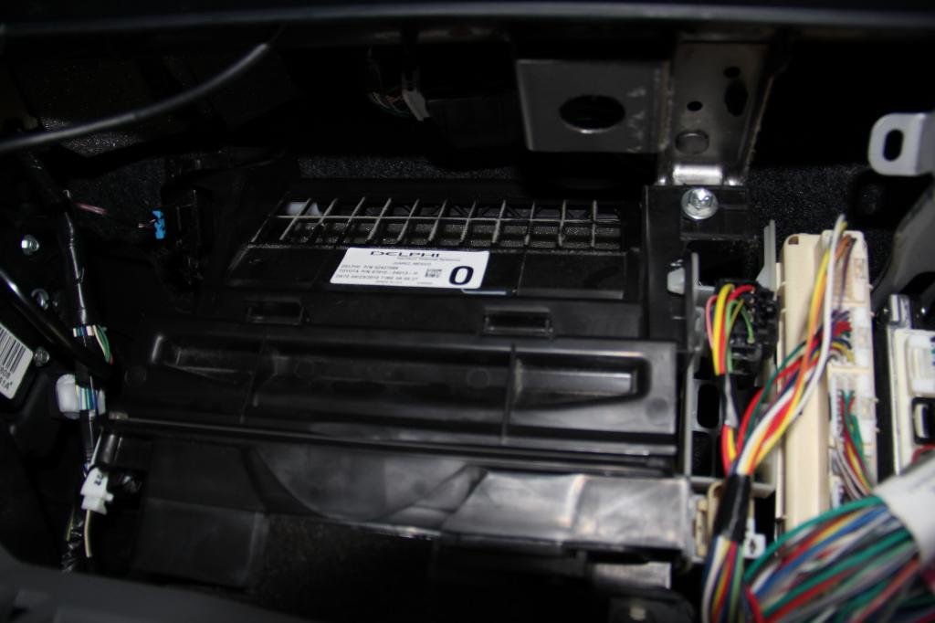

    CLOSED is the first picture shown in this write up. Notice the foam is touching the plastic grill. The foam will be closer to you meaning air will be drawn from outside the cabin.
    OPEN is the picture below. The foam will be away from you allowing the motor to suck air from the cabin.

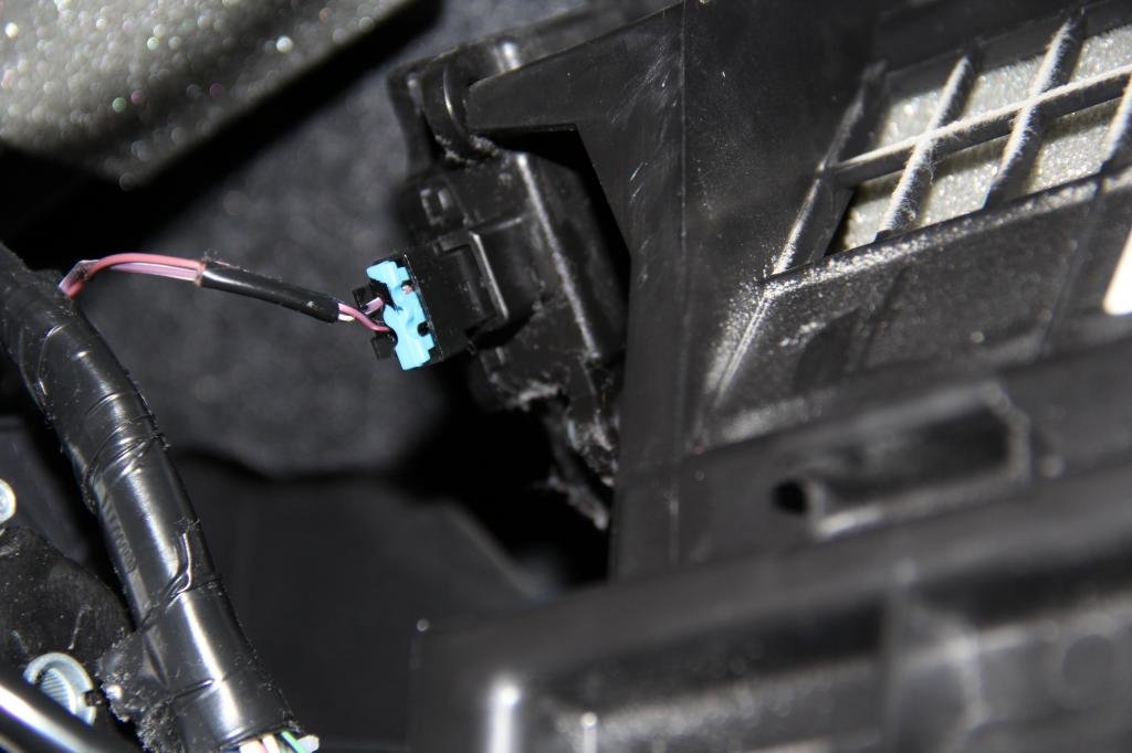

    Now in the picture it is a little difficult to see but the connector is where the BLUE piece is, but DO NOT pull the BLUE piece. The connector snaps on the DRIVER side (left hand side) of the servo.
    Be sure when you do this the servo is set to OPEN and the recirc button is lit.
    Using a small screwdriver, needle nose or your fingers, just lift the U plastic piece of the connector of the catch and gently pull. I recommend using your fingers so you don't go breaking anything.
