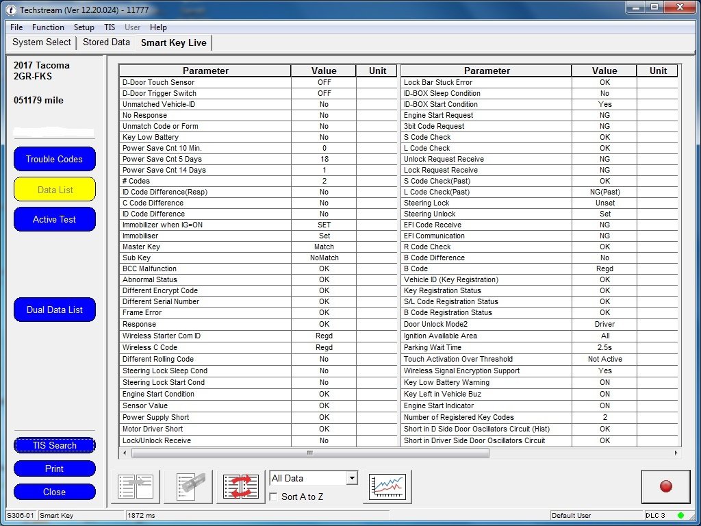

    Hi all,
    I have a 2017 Tacoma with Smart Key FOB. I lost one so I'm trying to program a newly purchased FOB. I have push to start. I purchased the latest SW on Amazon (https://www.amazon.com/DIAGKING-Tec...I&qid=1557800196&s=automotive&sr=1-3-fkmrnull).
    My problem is when I go to the smart key menu and it reads my data, there is no "Utility" button option on the side panel (see attached screenshot). I cannot program a new FOB. Any ideas?
    Appreciate any help...
  16. May 13, 2019 at 8:40 PM
    #36
    payrow
    payrow Well-Known Member
    Aug 8, 2009
    #20858
    500
    Los Santos
    '18 DCSB Sport
    My "UTILITY" button would not show up either. Turned off my antivirus and it came up. Give that a try...
