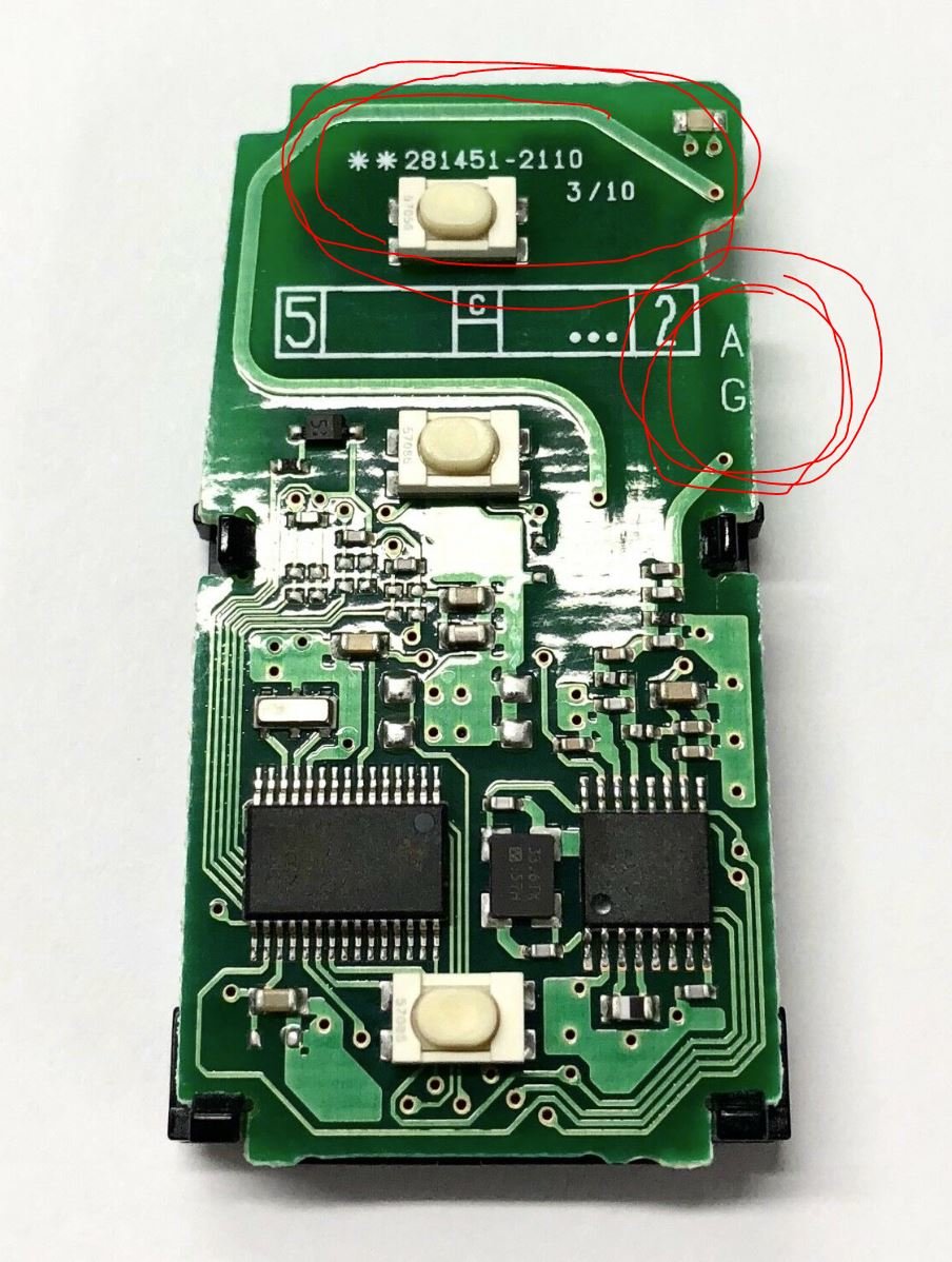

    Quick question. Does anyone know if a used fob from another truck be programmed to my truck? A local guy is selling his used one and I don't need the metal key itself, just the fob since my old one got washed.
  9. Aug 25, 2019 at 8:27 PM
    #49
    payrow
    payrow Well-Known Member
    Aug 8, 2009
    #20858
    486
    Los Santos
    '18 DCSB Sport
    On you, but if it's a working remote, I don't see why not. You can program up to 5 remotes to work with your truck. As long as the fob is the same as yours (Freq and ID). If it's the same Gen you should be good to go. Verify these numbers are the same on the one you
    intent to buy. A new one with an uncut key costs about $100 just fyi.

    Cool mine looks just like the picture you provided. Mine says 4/10 instead of 3/10 though. Thanks for the tip.
