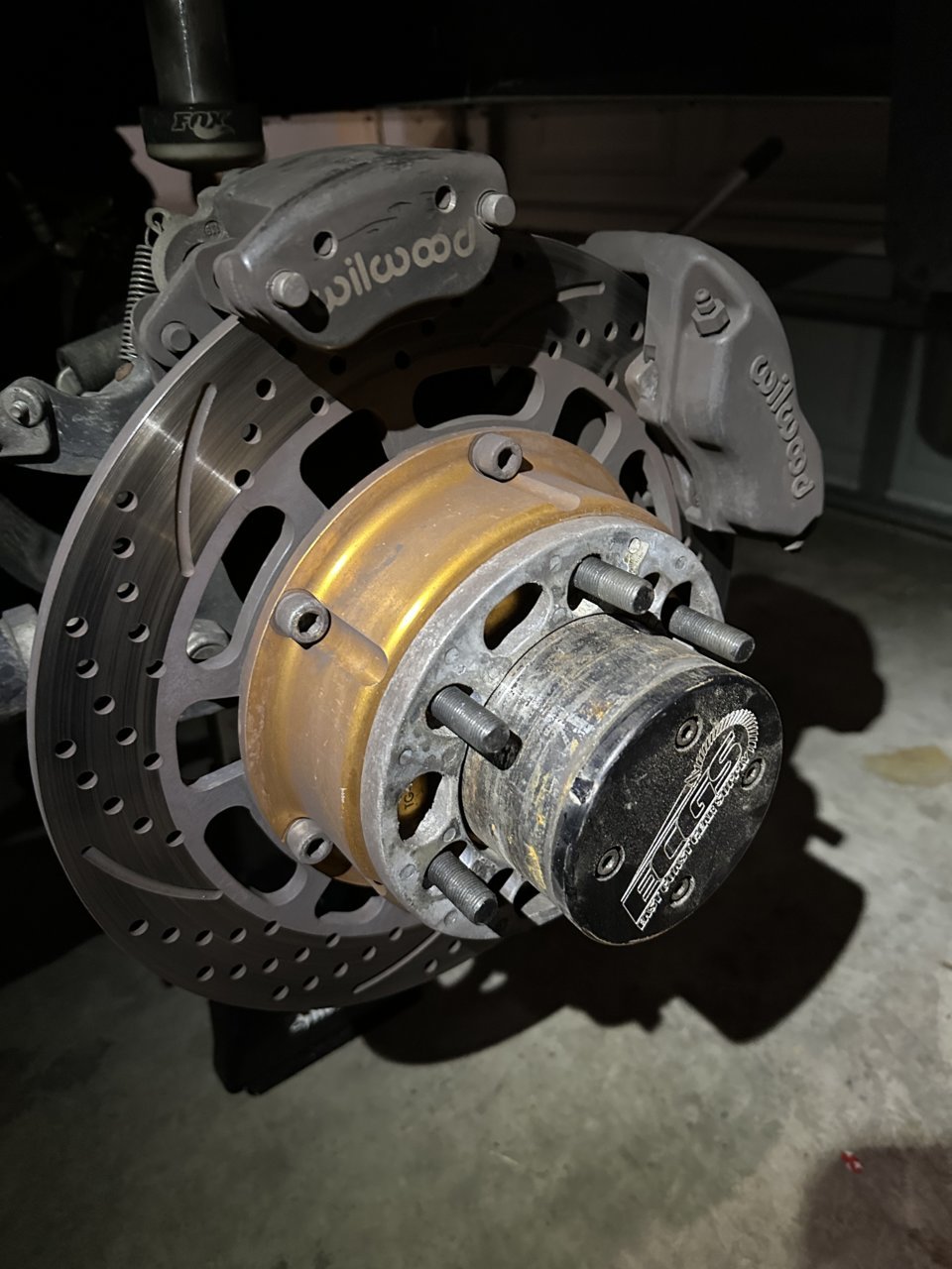

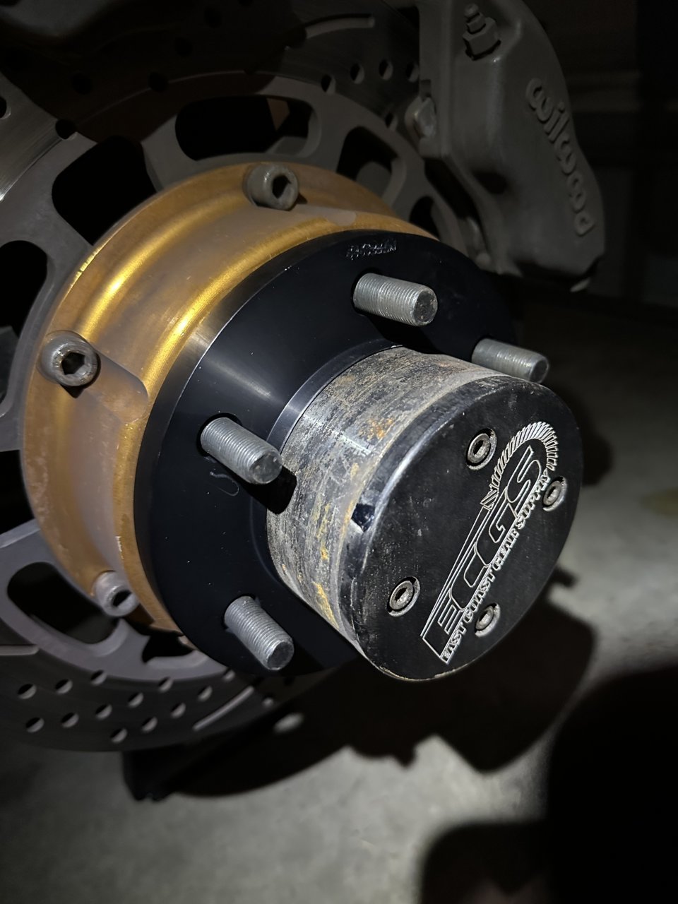

    Old thread, but I just got some custom slip ons from BORA. Aftermarket hub was 104.5mm so I had them machined to be hub centric for both the hub and Tacoma spec wheel.
    They were on my door step just under 2 weeks from order date. They are pretty easy to work with over email. Their website doesn’t let you do certain things but if you call to email them they will change the specs. Looks like prices have increased a bit.
    Old spacer
    New BORA
    Abused Taco likes this.
