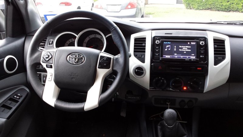

    Scuff sand it with some 600 grit sandpaper then wipe it down with some rubbing alcohol. Then spray 2-3 coats of primer following the directions on the can. After that spray the topcoat and clear coat following the directions on the can. I used dupli-color perfect match paints for mine. I also baked my parts in the oven at 200 degrees for ten minutes after the primer and after the top coat and after the clear coat. Here is a picture of mine. I did all of the silver pieces in my truck. And I vote blue. I originally did mine red and I didn't like it. It was just to much for me. That's why I decided to color match it. 20150516_184011.jpg
