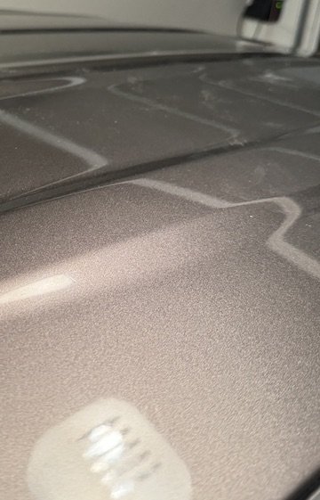

    I just bought a 2011 Tacoma TRDOR in Magnetic Grey Metallic. Overall, most of the paint is good and shines up well. However, the previous owner apparently ignored the paint on the roof of the cabin. So, it's pretty dull and even has a few "freckles" in the paint. I tried a bit of polishing compound and then waxed it. It's better, but still not great. Overall, I'm not worried about it looking good as much as not getting any worse. I'm mainly concerned about solar UV further degrading the paint and it eventually flaking off. What can I do other than a repaint?
    NOTE: Here's the roof view. The lines you see are reflections.

    Looks like it's still decent enough to vinyl wrap.

    It’s going to fade.
    might as well wrap white vinyl now before it does.

    Your pic makes the roof look damn good actually. Great that you're hopefully going to get ahead of it before it gets real bad.
    Just be aware that if you're putting a wrap or PPF on compromised paint there is a chance it will peel paint off when it is removed. If left on too long wraps can be tough to remove and/or are more likely to pull paint with them. Wraps and PPF also have a lifespan - they aren't a "forever" fix. Depending on the brand and quality you can expect to need to replace them roughly every 5-7yrs. And, best practice is to still apply a wax, sealant or ceramic coating over your wrap/PPF.
    Wraps and PPF have their place for sure and the technology has gotten much, much better. But personally I don't feel like I am wealthy enough or have valuable enough cars to justify the expense. Personally, I'd skip the PPF and just make sure I waxed it often or kept it ceramic coated.
