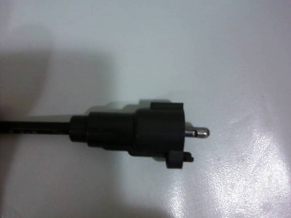

    Just changed mine a few weeks ago, same set-up. At the bottom of the plastic housing there is a small piece of plastic you need to push out (it's a small little clip, if you are looking at my picture here you will see it on the bottom). Then the entire housing slides up the wire and then you can pull the wire straight out.
    Note the clip can be locked on on the passenger or driver side. They were easy to get out if facing the passenger side, it is pretty tight on the driver side, so you might need a skinny screw driver or something to get in between. When you put the housing back on, check which side has more space and be sure to have the clip on that side.
