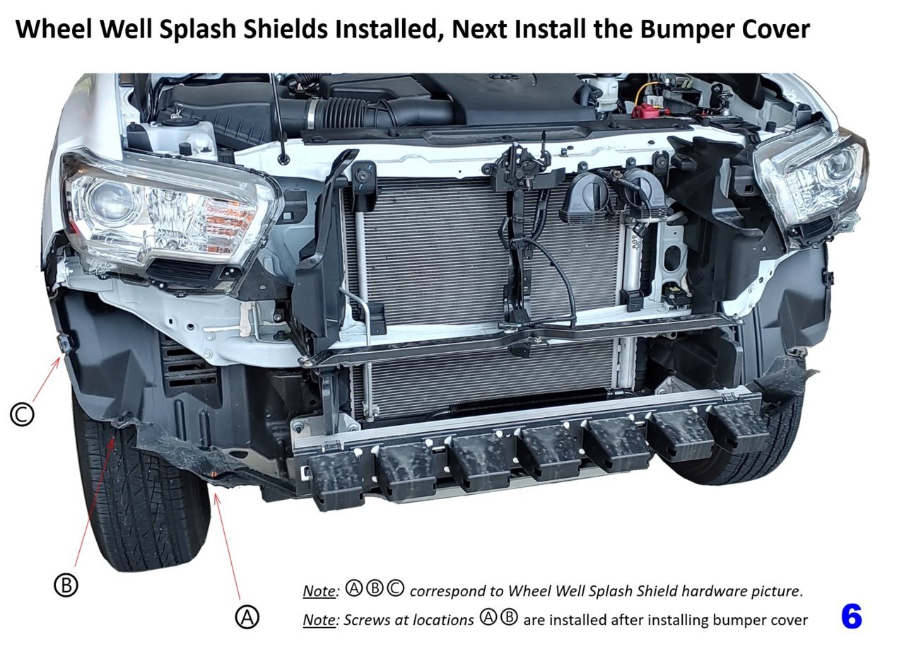

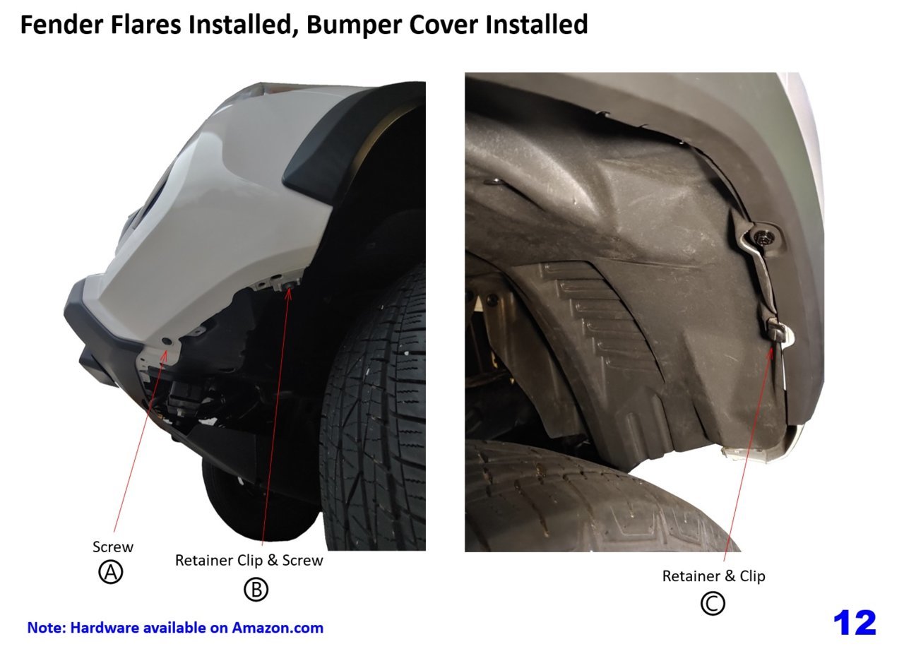

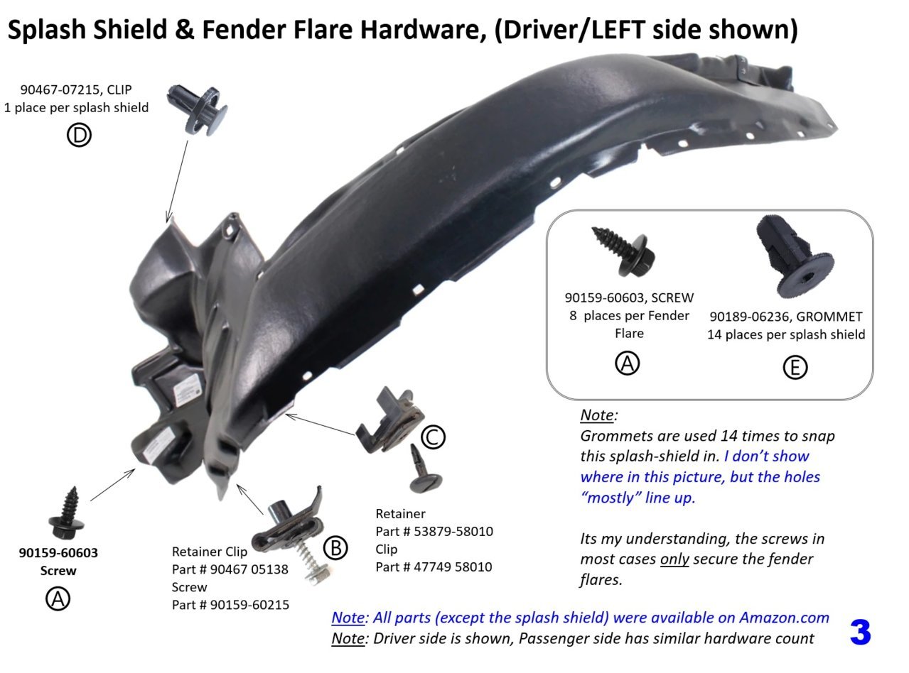

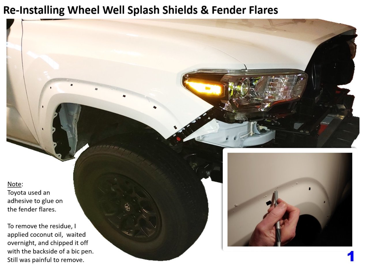

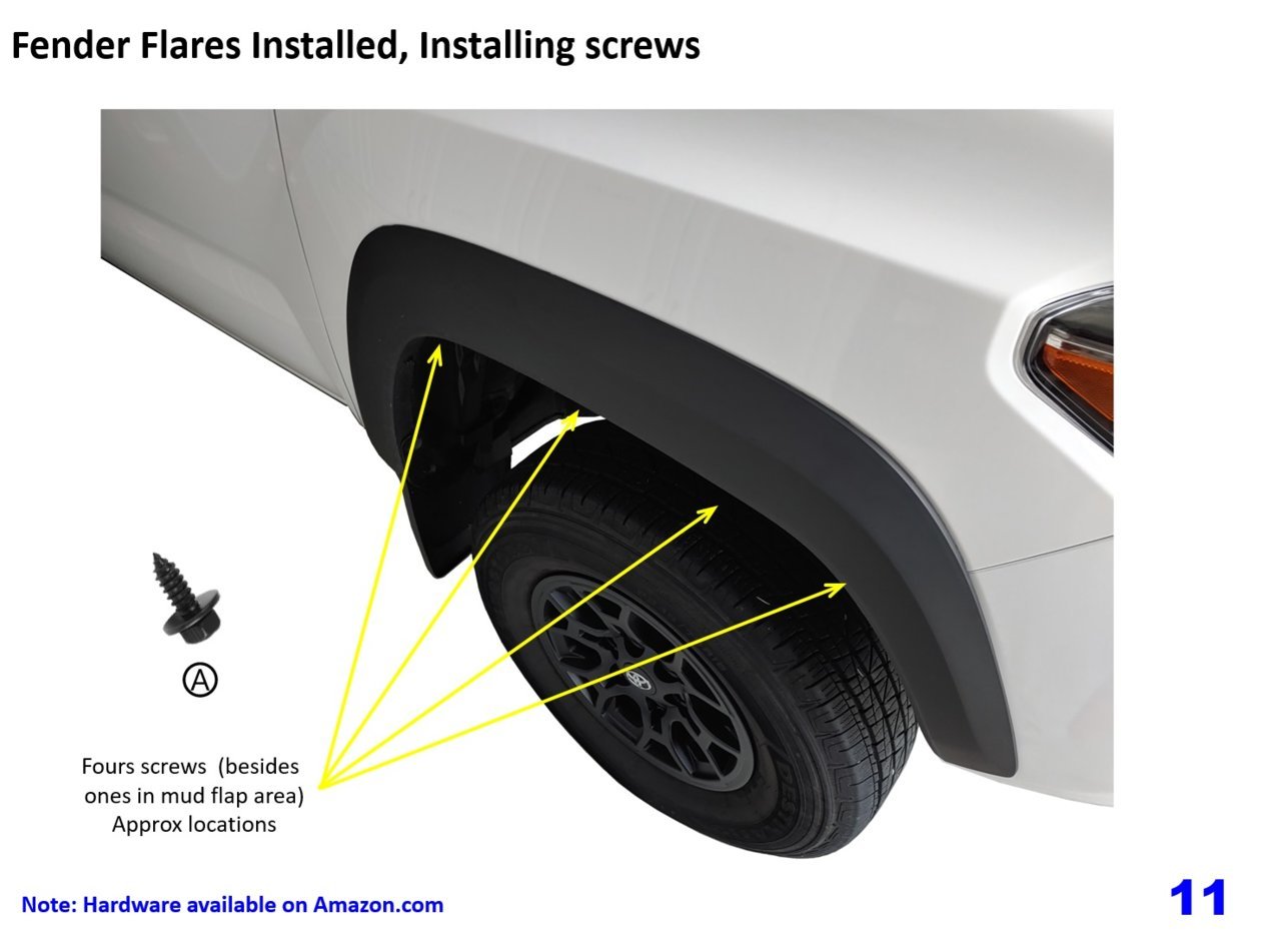

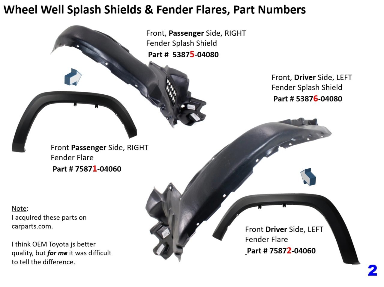

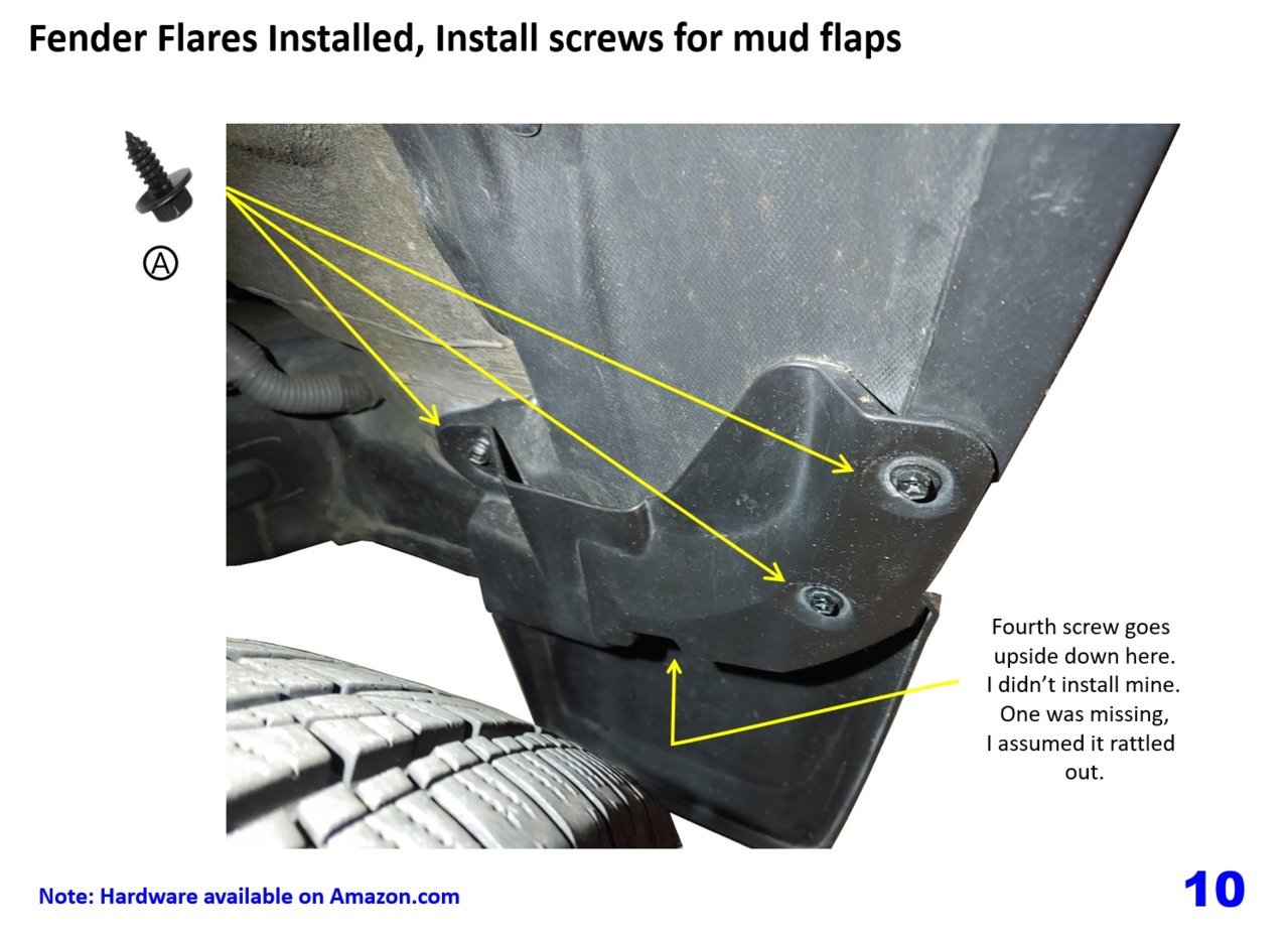

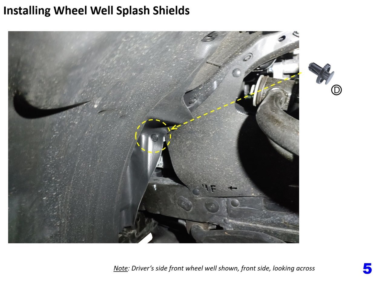

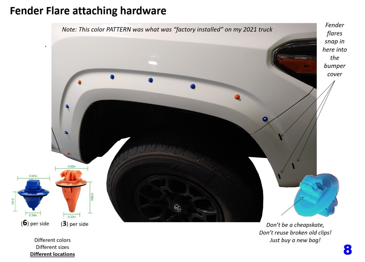

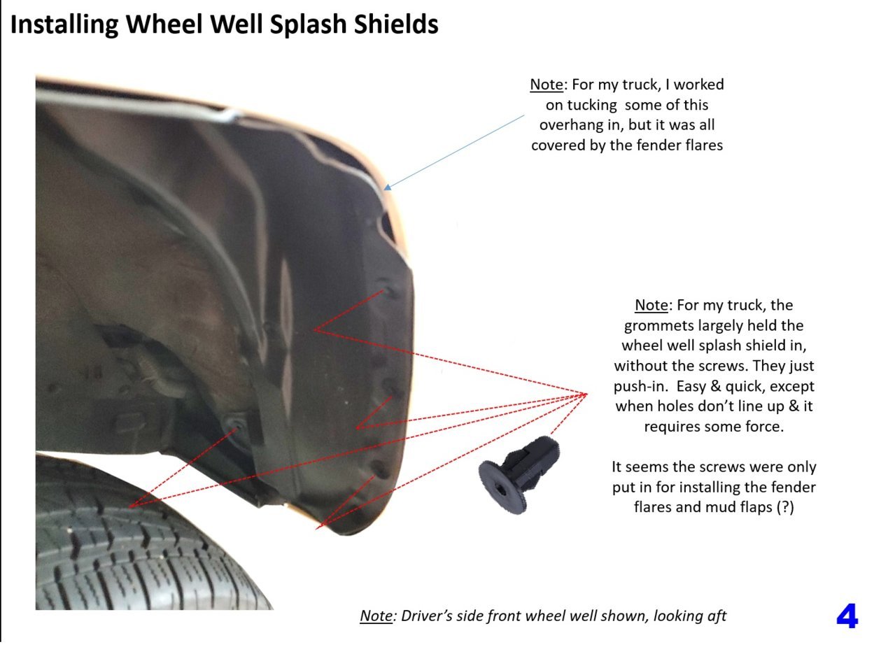

    Earlier this month, I did a bumper de-modification to restore the OEM factory bumper cover. on my 3rd Gen Tacoma (2021). So I needed to replace the wheel well splash shields & fender flares.
    Once I started the de-mod, I realized it was much more complex & I needed more hardware. Dumass. Then, I discovered these parts took 2 weeks to get, so the truck sat & I waited.
    Please don’t rely on these parts and pictures, please use the “Toyota Part-Center-Online” page for parts applicable to your Tacoma. https://parts.toyota.com/
    These pics are the way I personally did it not Toyota. Also, beware, this isn’t step-by-step.
    So if this helps someone… enjoy!
