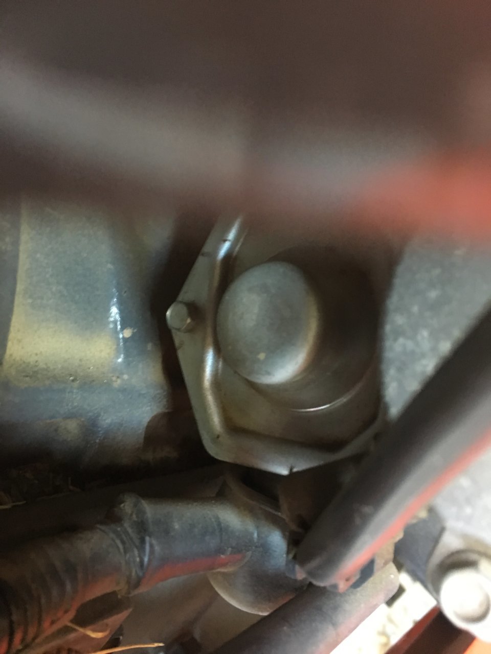

    I noticed my Kubota has a Denso starter with this type of solenoid also
    Benny123 likes this.
