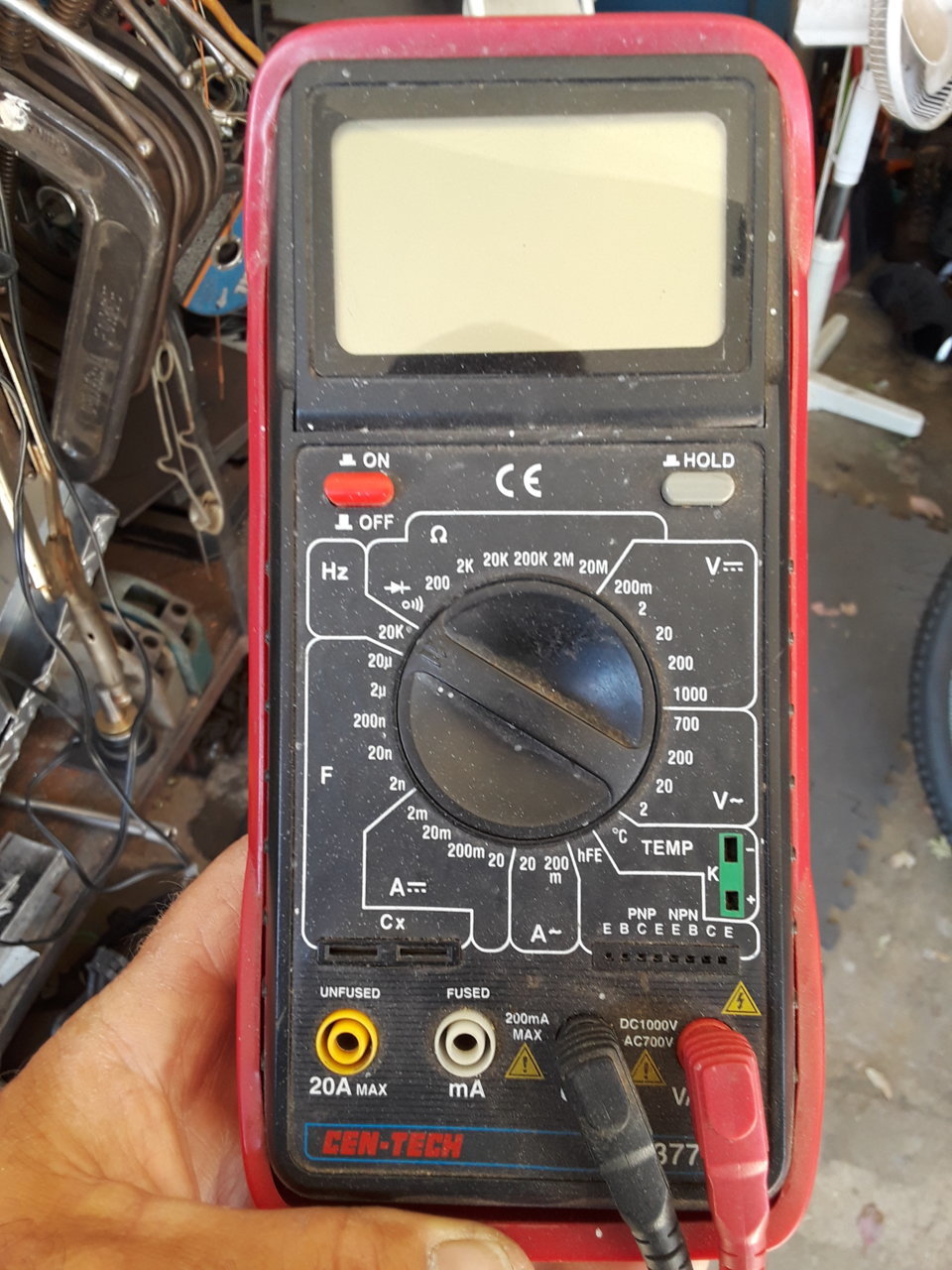

    No data sheet, I do have a multimeter15576874735293706914385320105779.jpg 15576875221474824626857386495457.jpg

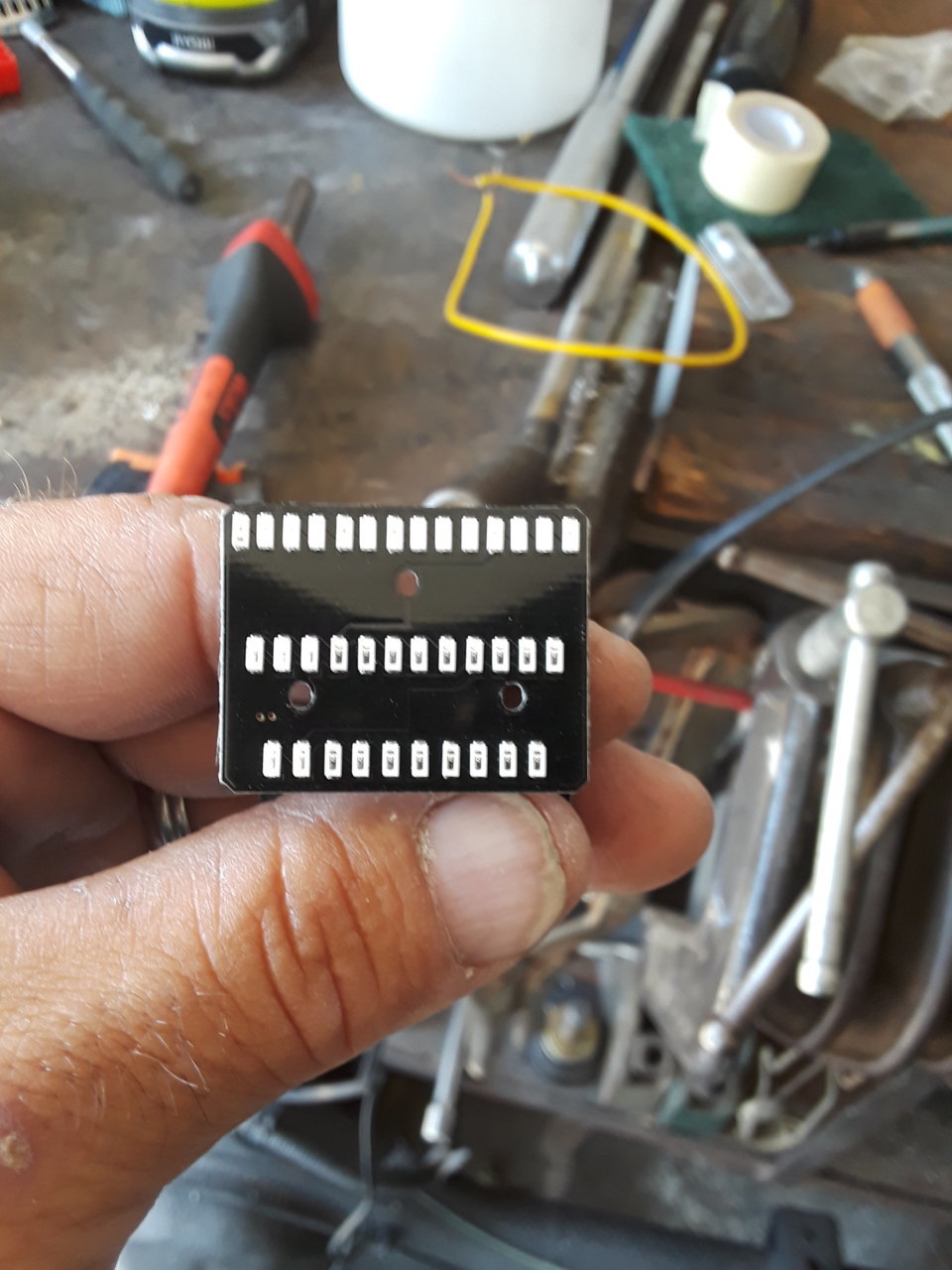

    There's only a positive and negative wire coming from them, here is the hole fixture
    The one on the top is it, they are red OLEDs, and the plug fits into a 12v supply,15576891999583999286575381793064.jpg 15576892589805103599037116641796.jpg

    This would be so much easier if it weren't for those black pcbs. Looks like there's a bridge rectifier on the first board so you can plug it in either way and it'll still light up, and then a couple of transistors for managing the current, probably one for each set of LEDs.
    I think my next step would be to just plug it in, put my meter across the two pins on the board you want, and see what that voltage is with them running. Then I'd disconnect the red wire, put the meter in current mode, and put the meter in its place to measure the current. Then it'll be just a matter of setting up some resistors to match that.
    EDIT: Although if we just do resistors, they'll change brightness when the voltage of the truck changes. An actual regulator would be more better.

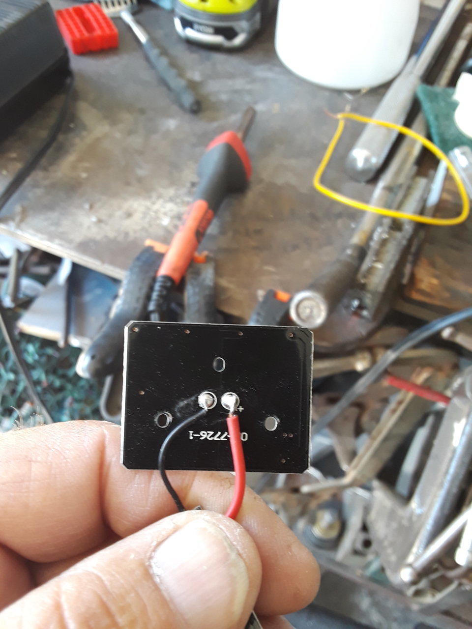

    The voltage is 7.9 to the one I want, not quite sure how to check the current, here's what I got1557692091063424302212032835623.jpg

    Since I'm not entirely sure how much current this thing pulls, we'll do it the safe way and try not to blow up your meter.
    1) cut the red wire to the board you want in the middle. Strip each side of the cut.
    2) move the black meter lead to the yellow plug. (20A MAX)
    3) Set the meter to the 20A DC setting (just past 6:00, to the left of the vertical line and to the right of that little 200m, in the section with the A and the solid line over the dashed line)
    4) Connect one meter lead to each side of the red wire, so that the meter is in series with the LEDs. Use alligator clips if you got them.
    5) Turn the power on.
    5) If the meter reads less than 0.2 A, you can shut it all down, and move the black meter lead to the white plug, and then change to the 200m DC setting to the left of the 20 setting to get a more accurate reading.
    EDIT: When you're done, put the black wire back to the COM port. Leaving it in the amperage measureing position is a great way to blow up a meter when you forget about it.

    I got zero on both settings,

    No I didn't, but with the wire disconnected, it reads 8.3v verses 7.9 when connected if that means anything

    Hmm. Sounds like the meter isn't conducting. If you had another meter we could check your meter.:D
