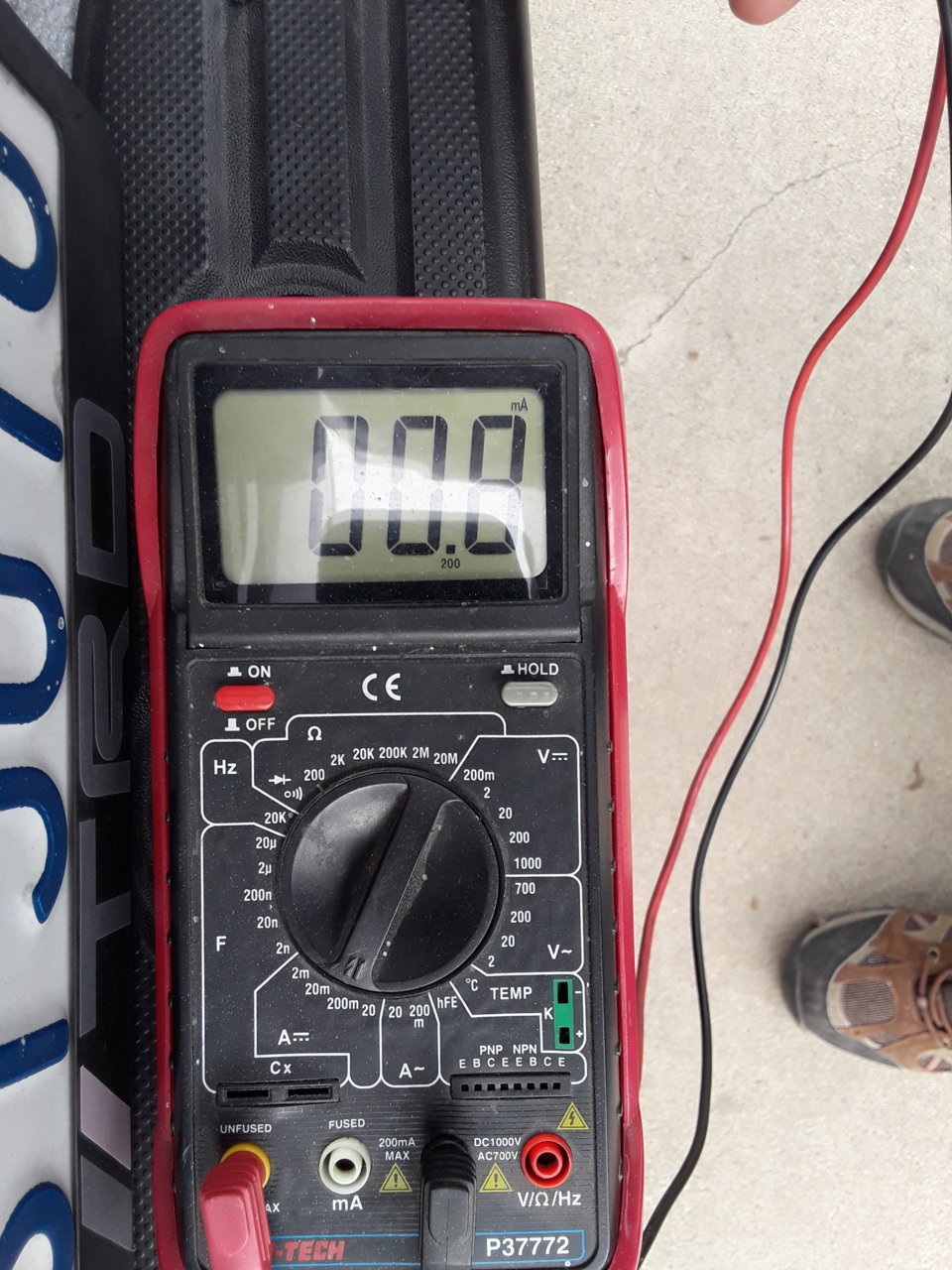

    If you could get a pic of the meter, that would be great.

    Move the red lead over to the white plug.

    80.1
  6. May 14, 2019 at 3:28 PM
    #46
    0xDEADBEEF
    Mar 2, 2019
    #285037
    19,847
    2000 reg cab 4x4 flatbed MT
    Thats more like it. I'll draw a picture of what I think you've got.

    Actually 78.5 is where it tops out

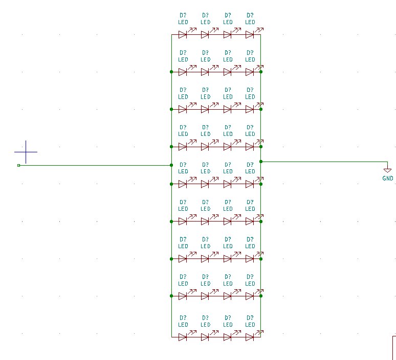

    I guess this is what it is. There are 36 LEDs on that board. If they're split into 9 groups of 4, then each LED gets about 2V of drop and each group gets a little less than 9mA if that measurement was right. Seems reasonable if they're trying to get a nice long life out of the LEDs.

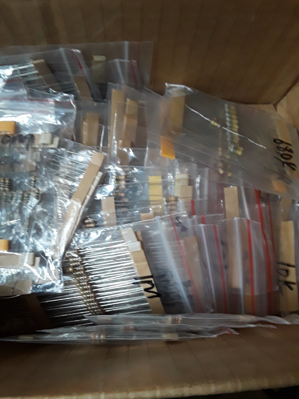

    Actually, what resistors do you have handy?

    I have a giant bag full, maybe 1000 or so15578774947091531711498245812808.jpg

    Well, if you can turn some of those resistors into a 65 ohm resistor, then you can just run it off 12V that way and it'll be pretty close.
    So, for example, 4 16 ohm resistors in series hooked to the red wire.

    I used 5=15 ohm resistors and bam works like a top, 4 and it's super bright and 6 is to low. Thanks again for all your help

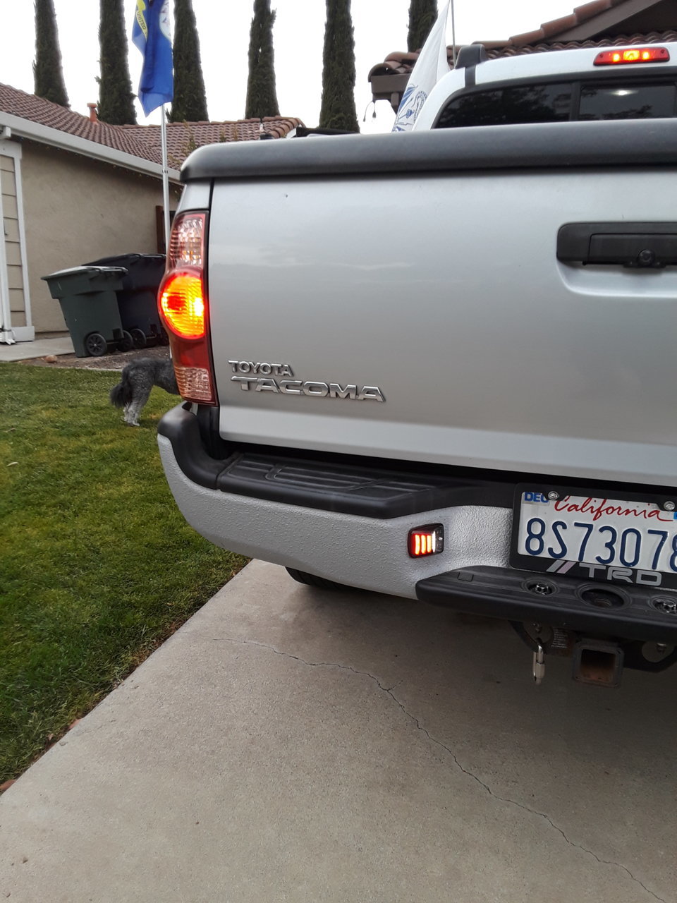

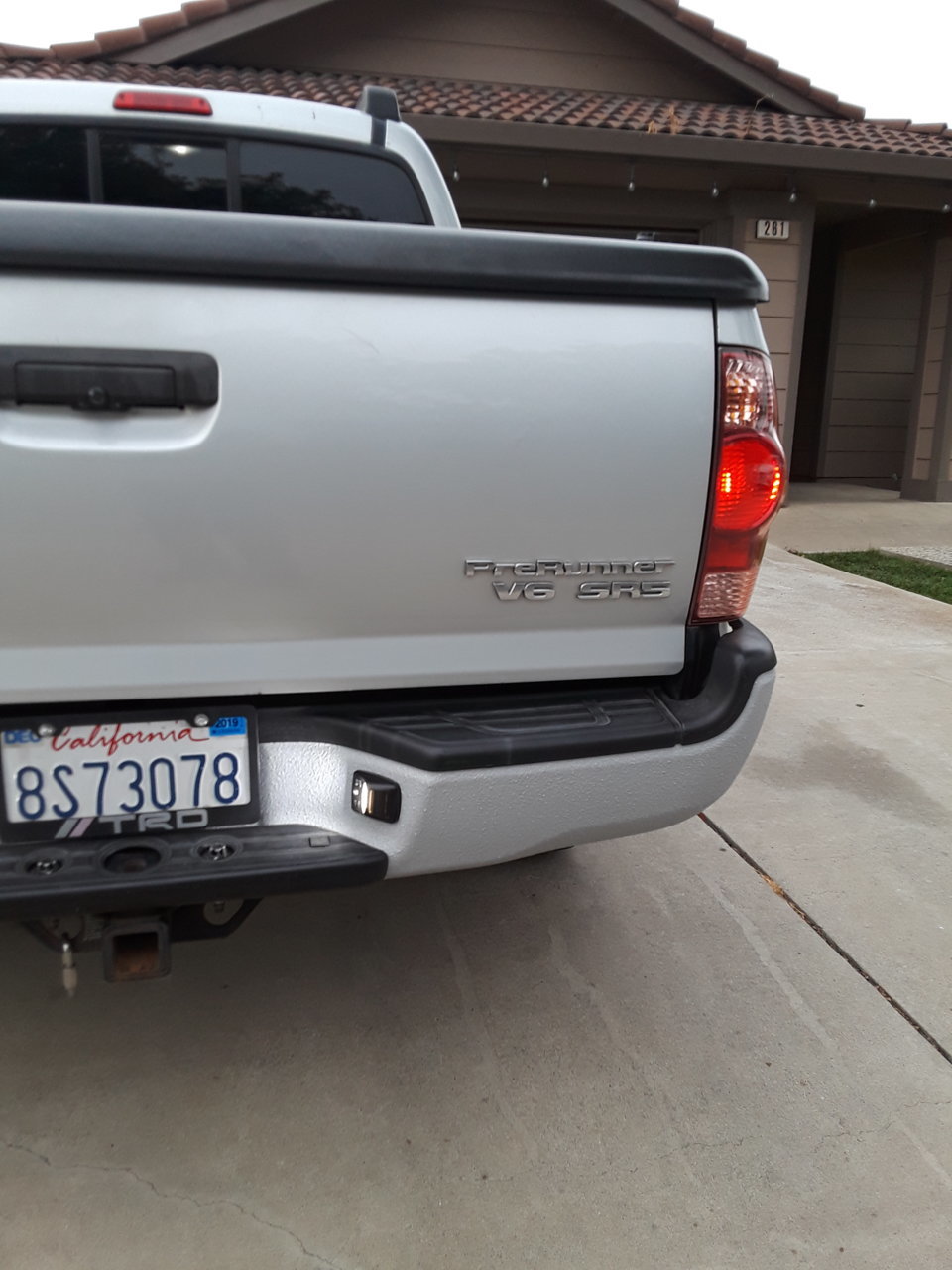

    This is what I've done, license plate light third brake light, doesn't look bright in the pic but it is very bright. 20190514_193413.jpg 20190514_193408.jpg
    0xDEADBEEF[QUOTED] likes this.
  20. May 14, 2019 at 7:59 PM
    #60
    0xDEADBEEF
    Mar 2, 2019
    #285037
    19,847
    Faaaancy. Looks good!
