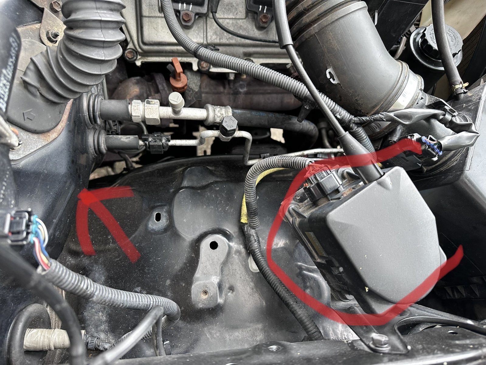

    Is anybody have relocate the cruise control module to make space for the air compressor?

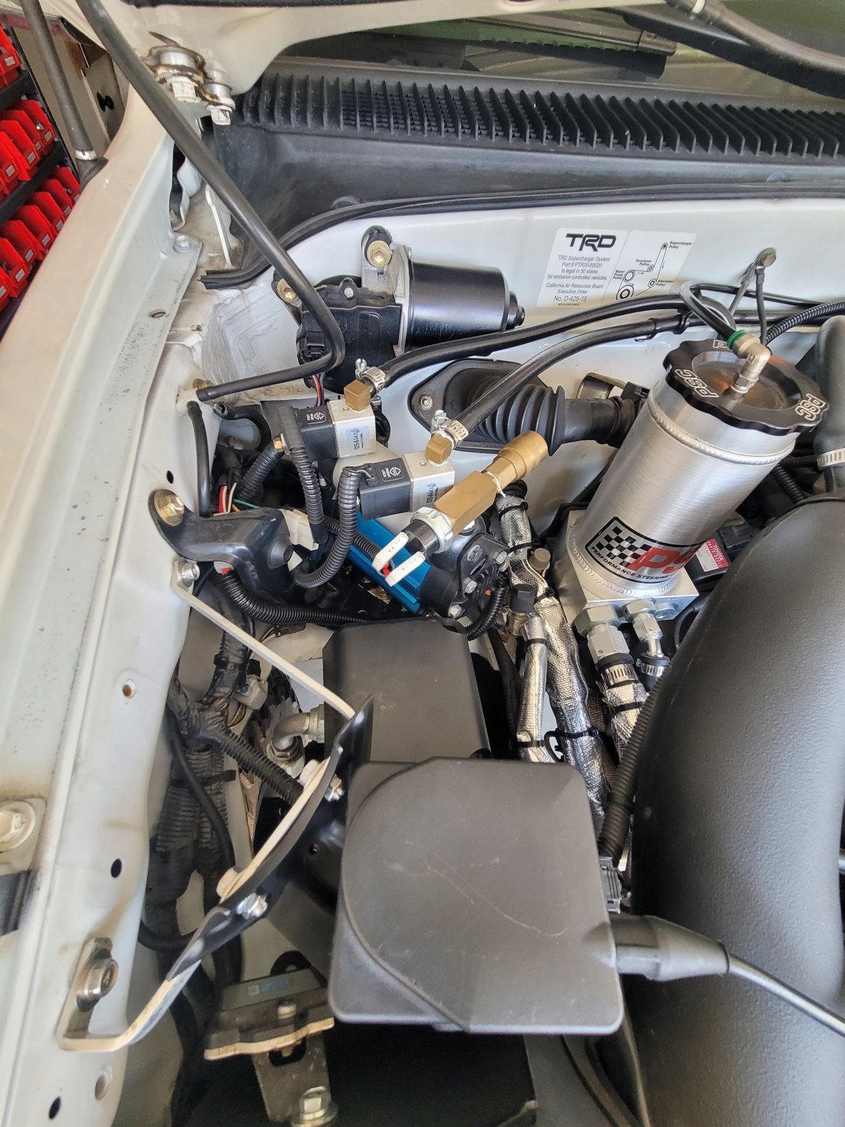

    Make your own bracket. I did.
    I relocated it again a few months ago. That's an old picture but similar location.

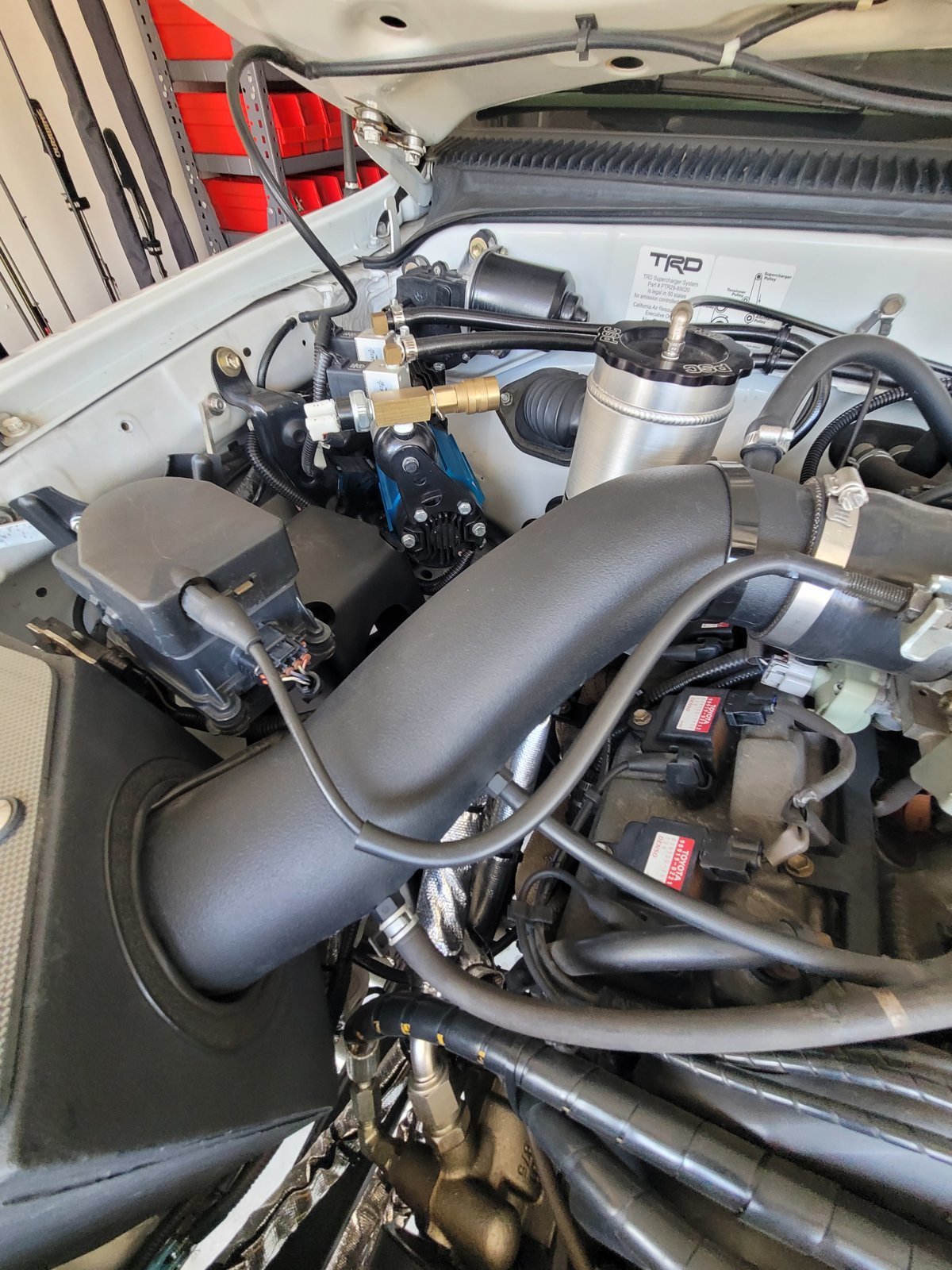

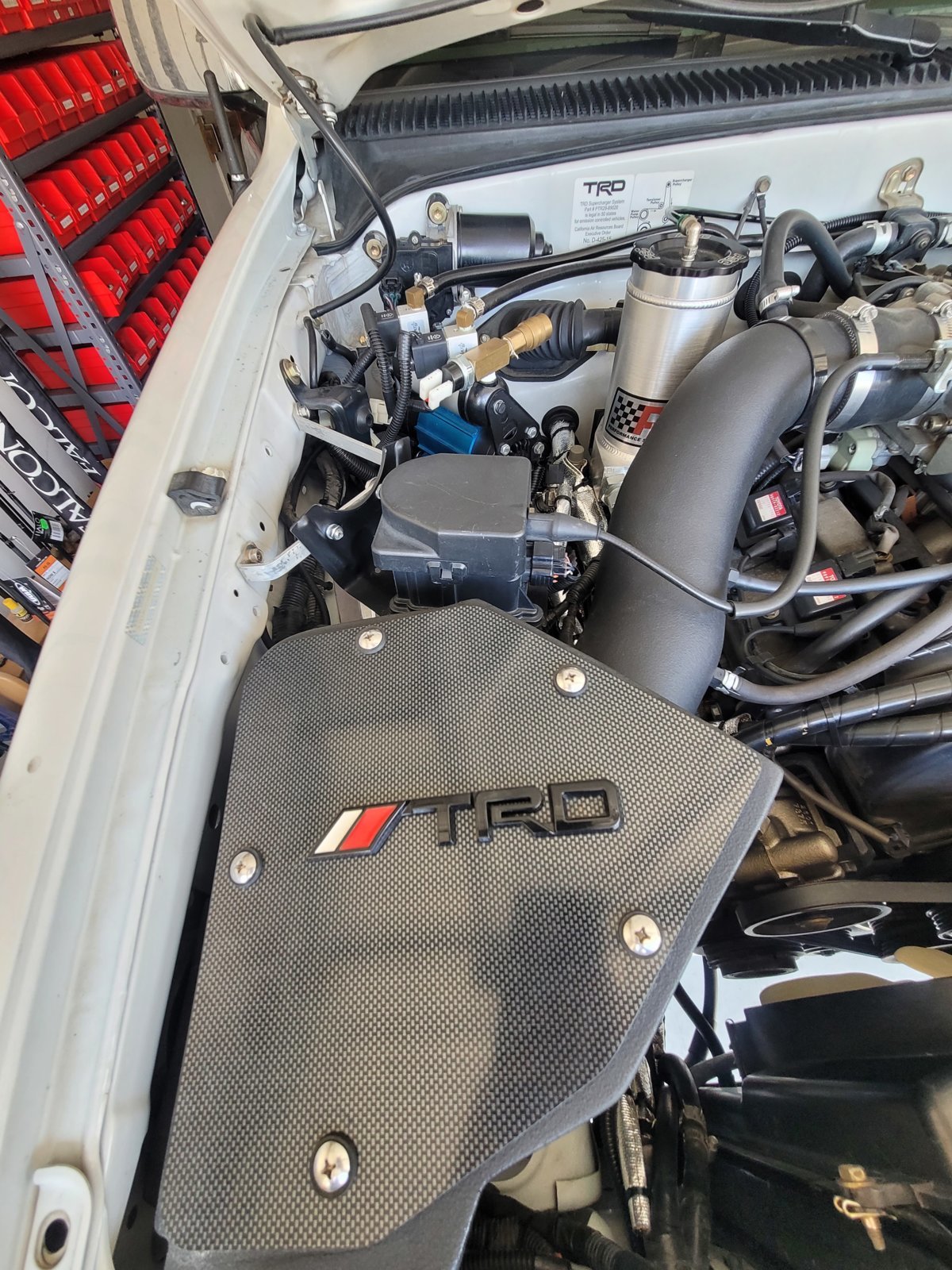

    Current and final location.

    A welder is not needed. If you look closely, it's a half inch aluminum flat bar. I bought it from lowes and bend to shape. Drilled some holes and relocate the CC. Simple and easy.
