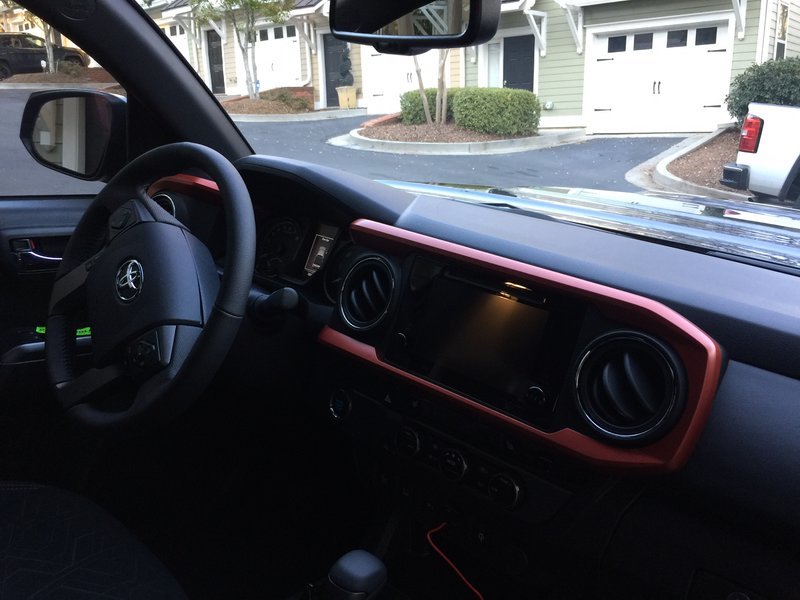

    I like the orange trim on mine. Looked a little unbalanced at first so I got the color matched insert letters for the glove box and that tied it in a little more. That the orange stitching in the seat and one or two more things I think it'd look even better.

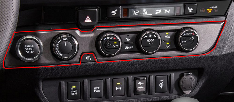

    Has anyone attempted to remove the trim piece outlined in red? tried to pop it off but it seems to be a little stuck.

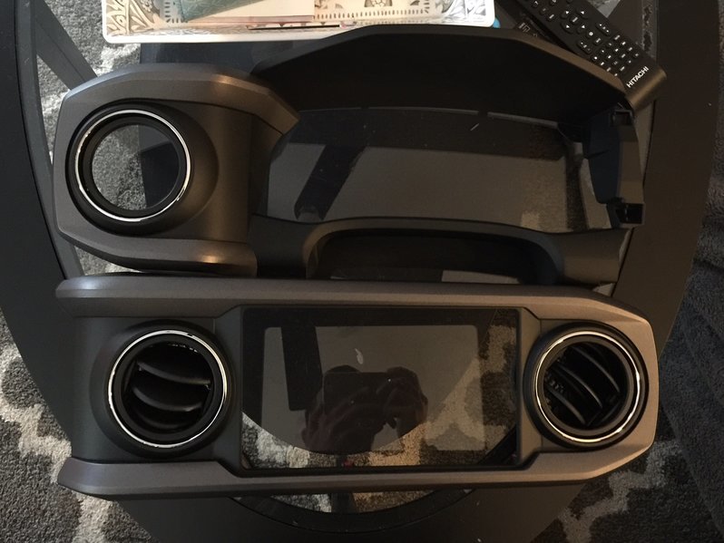

    Me and a salesMan pulled off trim off a new truck to see how difficult it was before I ordered a black interior , but it didn't go on easily , we had to send it to service to get them to put it back on. The AC vents were not setting correctly and left side didn't want to clip in any tips? Should the AC vents be placed on the dash ?

    I haven't tried it yet, but another member told me he did it by pulling out the stereo and coming at it from the back. I might try it soon.

    subbing. just picked mine up and the only thing I dont like is the orange. not sure If ill do carbon fiber or what but ill thing of something cool. maybe a matte gunmetal (car is the magnetic metallic grey)
