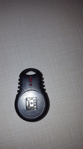

    Hello,
    I bought my tacoma new in 2006 and have loved everything about it except this anti-theft immobilizer thing that won't allow my truck to start without having it in the truck. It is now in very rough shape and even with a new batter in the device it won't let my truck start without hold this small button.
    I have no idea what to search for to find out what the name/brand of this device is or even how to remove it from my truck. See attached image.
    Thanks for any help.

    This transmitter (key fob) seen attached in the picture is slowing dying and will soon give out I assume. There is no writing on it and the replacement has already been broken. If I can find and program a replacement that would be a fix as well. I just don't know what to call this thing to be able to search for one. My first method would be removing the receiver from the truck wherever it is.

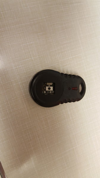

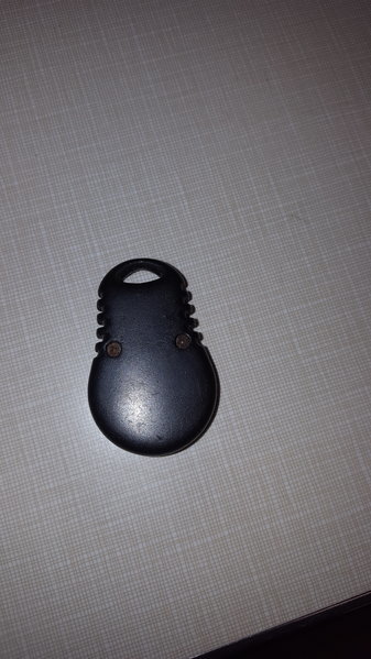

    Just in case. Some pictures with better light. attached. Where the open square is showing the small button there used to be a rubbery sticker with a thumb print on it.

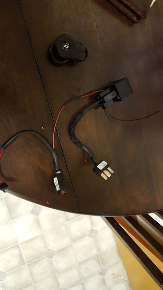

    Update: It was much easier than expected. This guy was attached to the Starter relay location in the engine compartment. Pulled it out and bought a new starter relay. Couldn't be happier.
