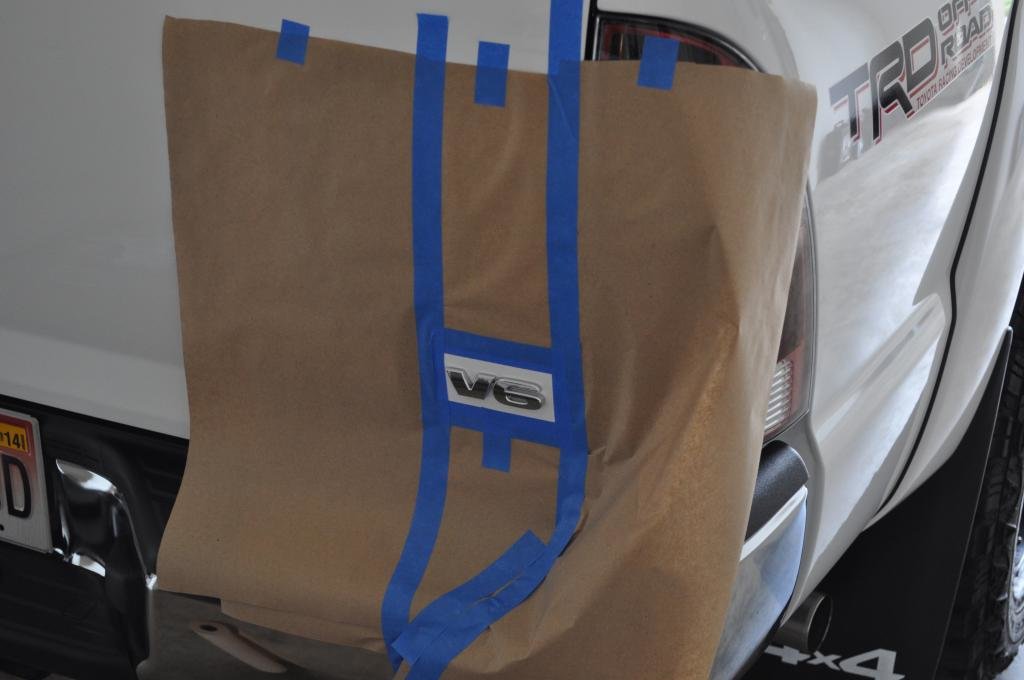

    This is how much I left around each badge.
    The way that I did it was spray everything down with Windex and wipe it off and let it dry.
    I then used 10 coats of Plasti Dip on the badges and the paint of the truck with a 20 min drying time in between sprays. Between coats turn the can upside down and spray to clear out the paint otherwise it will splatter on your next spray and give you a texture you don't want.
    On the last coat I let it dry for 10 mins and then took the dull end of a sewing needle and peeled away at the corner of the tape. It comes right off the paint but sticks to the emblem perfectly.
    Since I put so many coats on this project took most of a day but the results turned out perfect and you can't tell they aren't factory.

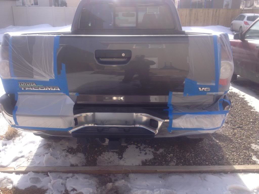

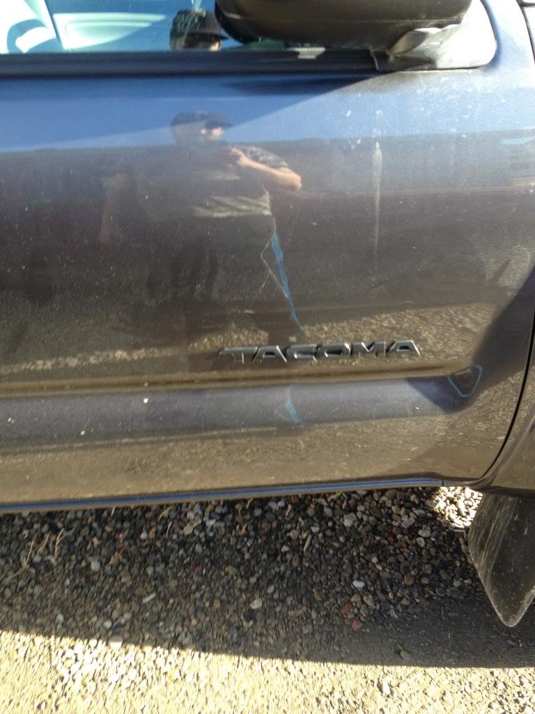

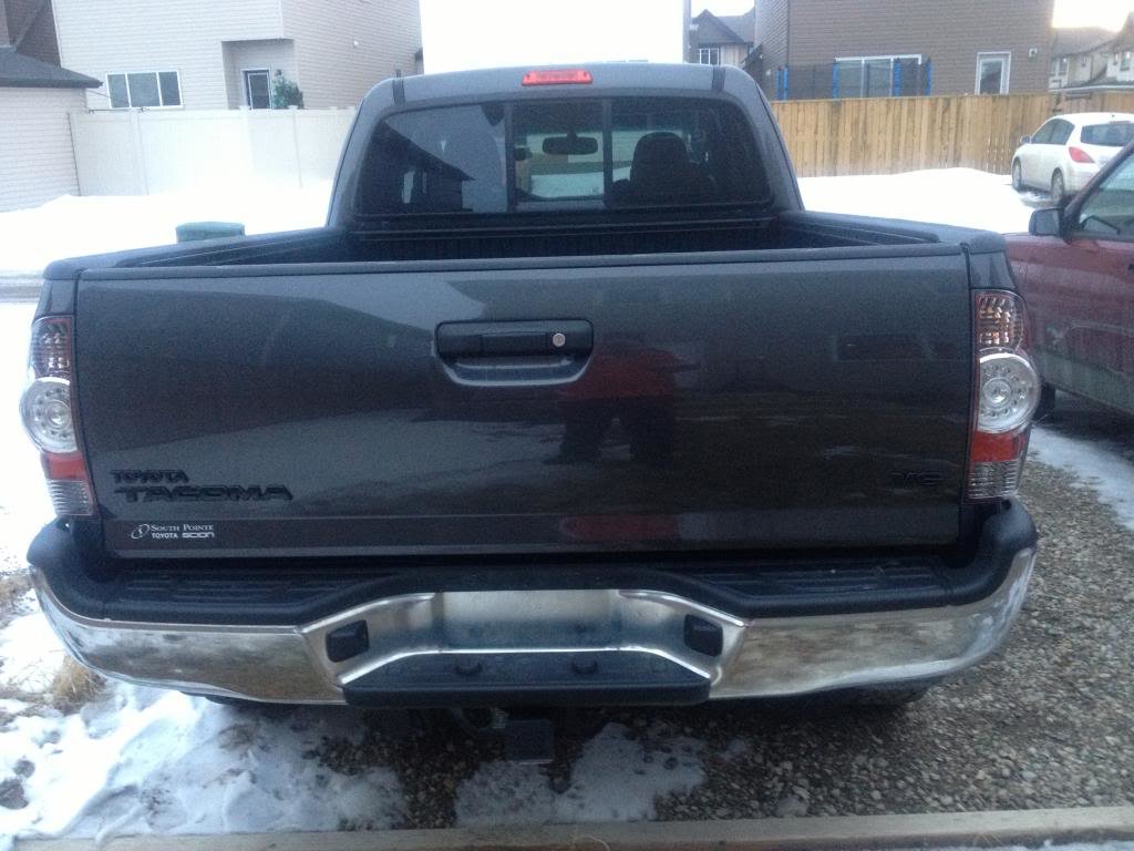

  13. May 15, 2014 at 9:24 AM
    #33
    jw1983
    jw1983 Well-Known Member
    Sep 18, 2011
    #63738
    2,999
    Jason
    Alberta
    13' Tacoma Access 4x4 OR

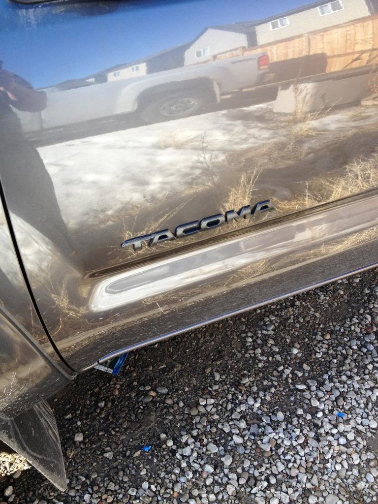

    Your conditions on where you are dipping matters too. If you're dipping outside and it's 25C outside then you're dip is going to dry fast. Just as fast if you're dipping in direct sunlight. The emblems I did in March 2013 and you can tell that there was still snow on the ground. I did 20 minutes of drying time in between coats and 5 minutes on the last coat(since it was cold out) so I could get the dip between the emblems with a toothpick. I'm going to redo them this year, maybe even a different color. Leaving a space between the emblem and the tape when you pull the tape it will leave some dip around so you can pull with your finger or toothpick. The good thing about that is you can touch it and see if the dip is still sticky or dry enough to pull without pulling it from the project.
    I did 6 coats of black and used aftermarket DYC nozzles. For a first time doing it on a vehicle, they turned out amazing.

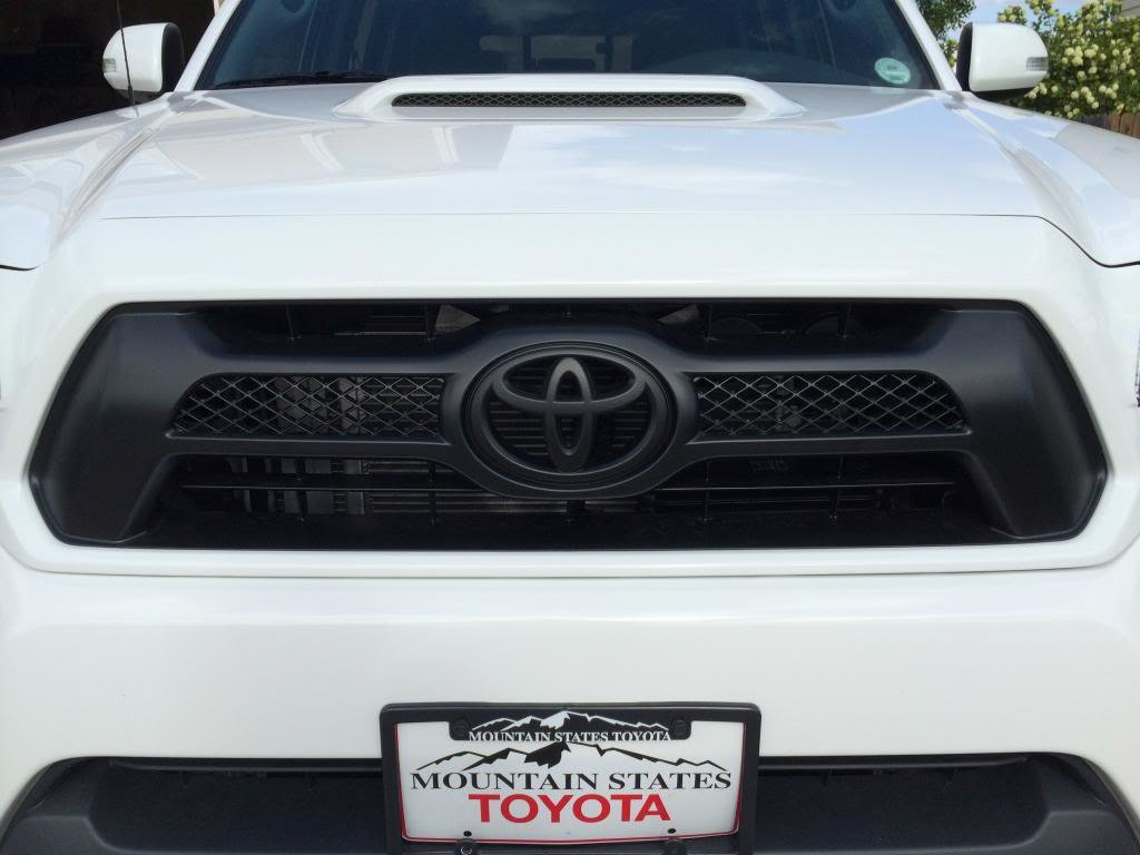

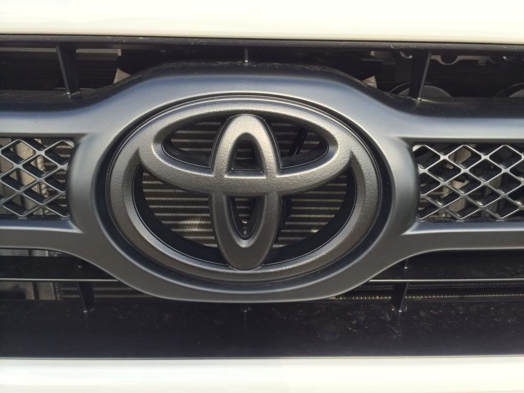

    Did the front emblem. Good practice for the sides. How's my technique?
    Before:
    After:

    After looks awesome.
