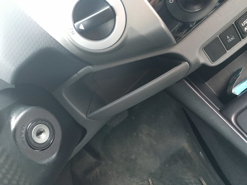

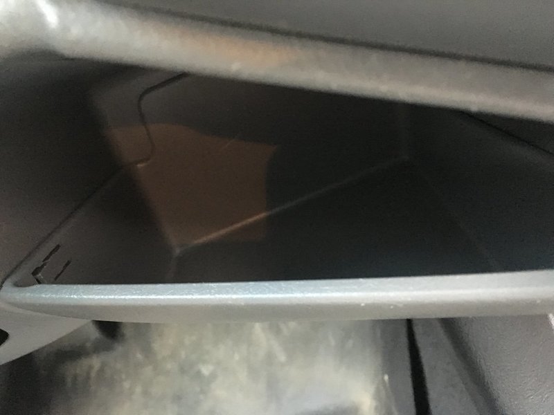

    Trying to remove this piece and put some felt on the sides because it is rattling. Any ideas? I notice there is a small clip of some sort on the left side...

    yank

    x2. It just pops out. Reef on it.

    I can't tell you how many plastic pieces I broke on my 1st gen, just yanking. Can you elaborate?
    Pull down towards the floor? Out towards the wheel? What's the clip all about?

    Ok copy that. I'll give it a yank then.

    Pull straight out.

    4 yellow clips on backside. They are tuff, I've pulled mine out plenty of tine and it snaps back in.
    Pull straight out.

    I remember grabbing it on both ends and lightly pushing those ends inward as I lightly pulled out. I guarantee you if I, who knows nothing about vehicles besides gassing them up (wait, fueling them up, lol) and changing the oil, you can do it, too.

    Yep comes right out with a firm yank. It needed some extra felt where plastic meets plastic to kill a rattle.
