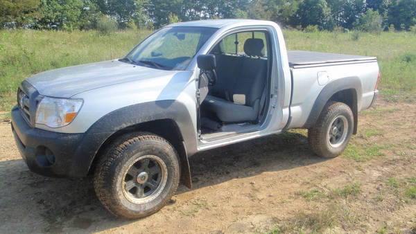

    How difficult is it to remove the driver side and passenger side doors? I have 08 base 4x4 regular cab, I think the only electronics in the doors are for speakers. I'll probably need to get some kind of replacement driver side mirror to make it street legal? Anybody try doing this yet? Not sure if I want the removable bar doors yet like on the other thread, just want to drive around without a door first.

    Well I tinkered and tried it out. I had the base pkg standard cab so the only connection I had to worry about was the speaker wiring, but there is a quick disconnect for that inside a rubber boot near the hinges. Seat belts weren't an issue and functioned properly. After I did it once or twice I could remove both doors in about 15min. The dome light did stay on so if I left them off overnight I would disconnect the battery. I know Jeeps have clips you can buy that clip to the door panel to shut off the dome light, but I never tried one to see if it works on the Tacoma.
    It felt awesome driving around like that and I thought it looked pretty cool on the standard cab. It was definitely fun and got a lot of heads turning. My mom thought it looked red-neck though lol. Having said that I'll confirm what everybody else is saying about the safety issues: doors protect you. Even on some tube-door websites they post disclaimers warning you not to go off-road without doors because of the lack of side-safety in the event of a rollover. Tacoma doors are pretty beefy and have a built-in I-beam for protection (I know because a deer hit mine and bent it in, costing me over $800 for just the exterior door panel + I-beam).
    I never had any problems with the cab torquing, the doors always went on fine afterward. But I also wasn't doing anything as extreme as guys in Moab; my truck was still kinda new and I didn't want to f* it up yet. For the side mirror issue, I fabbed up a bracket from a piece of metal conduit, spray painted it gloss black and mounted a cheap mirror from auto-zone to it. Drilled some holes to match the door hinges and bolted it on. I'd pull up next to cops at stop lights and got passed by one on the highway and nobody ever said anything to me about it; I just figured if Jeeps can do it why can't I?
    I would recommend having a safe place to store them with some carpet or towels on the ground and all around them or they will scratch pretty easily. If you like the look, try it, but be safe while having fun. I also can't guarantee you won't get pulled over by a Statey lol.
