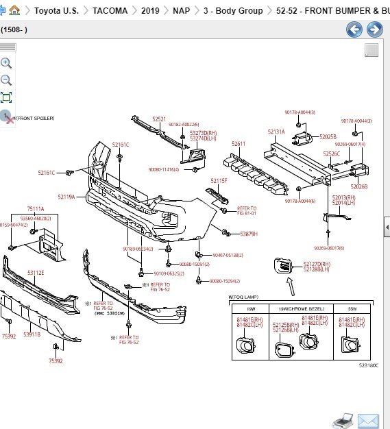

    ^^Yeah, it's a couple of clips at the bottom. This might help. See figure 5 in the BA bumper instructions. I know I sent you the instructions for a 2nd gen, but it shows it better than the instructions for 3rd gens.
    Also, here's a schematic of the 3rd gen front bumper.
