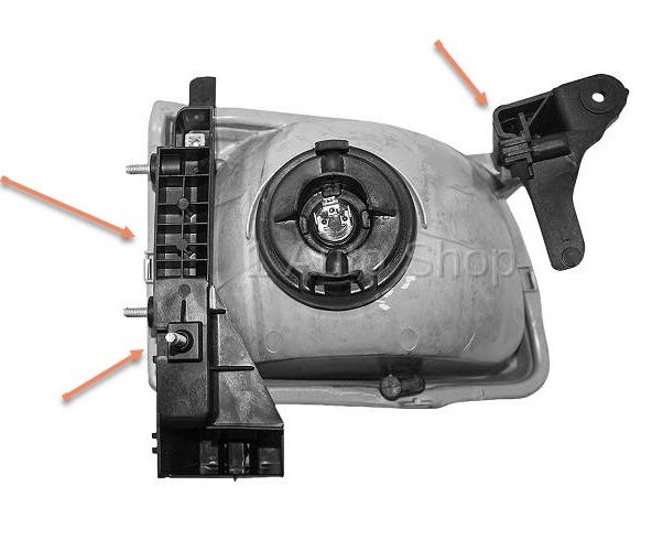

    Hey guys, how do you remove this bracket without breaking it? I attempted to remove one of them when I installed my retrofits but I snapped it thinking it was just pressure fitted on. Any insight?

    Squeeze the white clips inside with needle nose pliers or a flathead and pull up on the black plastic handles
