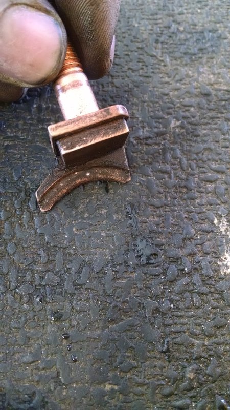

    i used the dorman kit...kinda had to piece it together with the factory pieces and stuff...and had to reuse the plunger, but she hits the first lick everytime now...so it must have worked...top bolt on the starter is kinda a pain, but swivels and my air gun got it off...and y'all with the 4wd's had me worried it would be a pain to remove, so i didn't hold it when i removed the last bolt...sob fell out and came down 7 feet and smacked the ground haha...prerunner ftw, i guess...
    anyway, here's one of the contacts
