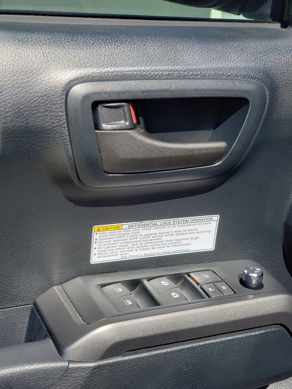

    So it was easy to snap the @MESO door handle covers on, but how does one go about removing them? I can't get the back part to un-snap :(

    May have to remove door panel to access the handle and get a good grip.
    Once door panel is removed, the handle part slips out on its own.

    I did this today. Pull handle part way out and pop them off. Mine popped off as easy as they popped on.

    Cool, I got them off now. Needed to do what you said, then angled the covers upwards and it came out easy. Thanks!

    Your pic shows that they are a different shade of black and clearly don’t match. Mine are also like this.
    The pic on the website shows a perfect match. Not really happy with them, especially for $40+.

    agreed, that picture changed my mind on the handles. Not a fan of the mismatch in color

    The interior (at least mine) is a mix of gray with black accents. Wider photo here :
    Otherwise, I hear that Meso's MGM color matches the interior pretty close.

    I’ll post a video, but you can unsnap the fron with your hands which leaves the rear still clipped in(and tucked behind the panel) slip a panel tool in between the stock handle and my cover pushing toward the rear. This will unclip the last latch then you can pull it out.
