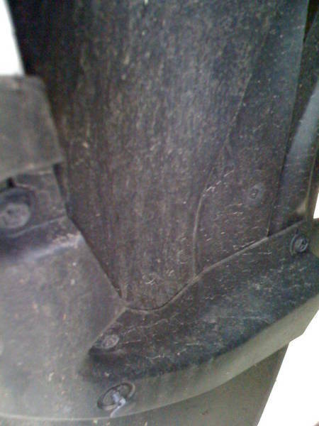

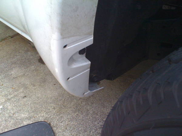

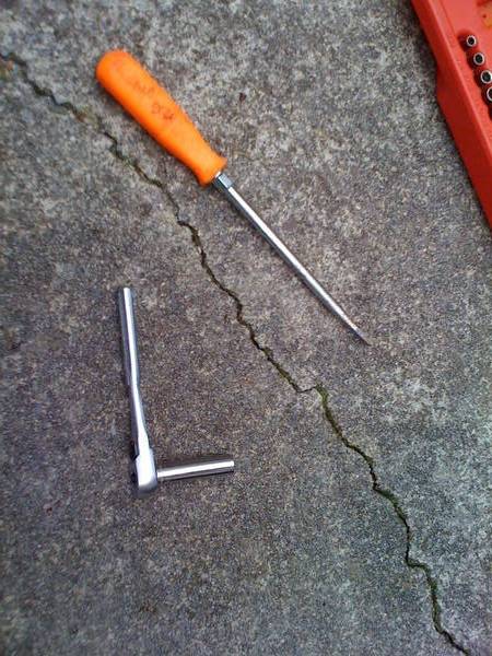

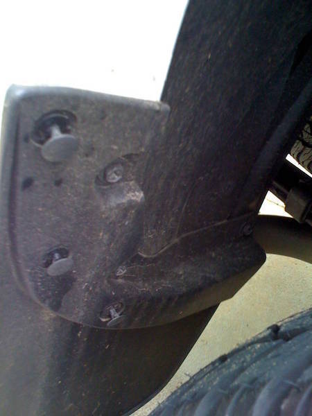

    Just thought i would show how i removed my flaps. First you need a flat screw driver and a 10mm socket

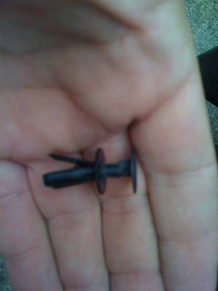

    Then take the screw driver and slip it in between the button and back (they are a push lock) yours should look like this
    Then pull them out
    Then remove the three 10 mm bolts

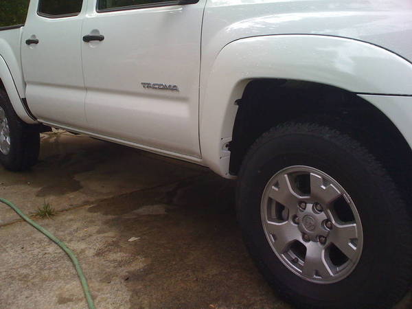

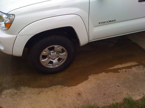

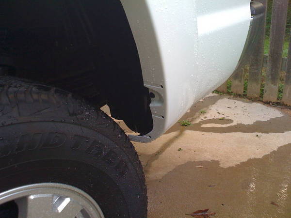

    That's all there is to it, you may have a mark left by the flap but it will wax out.
    [​IMG][​IMG]
    Just thought i would share

    Great job! Thanks for the post. I wish this was up when I took mine off. I broke all the little black peices before I realized that I was supposed to do that other thing. oh well.

    I removed mine by taking the 10mm bolts out then giving the flap a god f*****g bat with a closed fist from back to front...the hell with the little plastic clips, you only use them once anyway!!!
    Replace the bolts so you know where they are....and BTW what do you do to fill the 3 holes left!

    The previous owner of my truck put the plastic rivets back into the holes..
