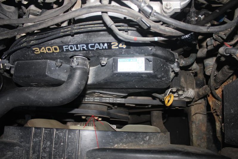

    By god your right!!! I never realized there are 3 belts.... First vehicle I've work on with more than one.... Although the power Steering belt on mine appears to be in front of all the others so I don't think I'll have to remove anything extra.... Here are some pictures, anyone know where the bolt I'm looking for is located???

    I just went outside and took a pic of my filthy engine bay. I circled the pinch bolt and adjuster on the PS pump. The big bolt in the slot must be loosened, then you simply turn that long bolt to tighten or loosen the belt.

    OK, I think I found it Steve... the big one is easy to get to... the Long one on the other hand... I might need to invest in some more tools! Thanks again

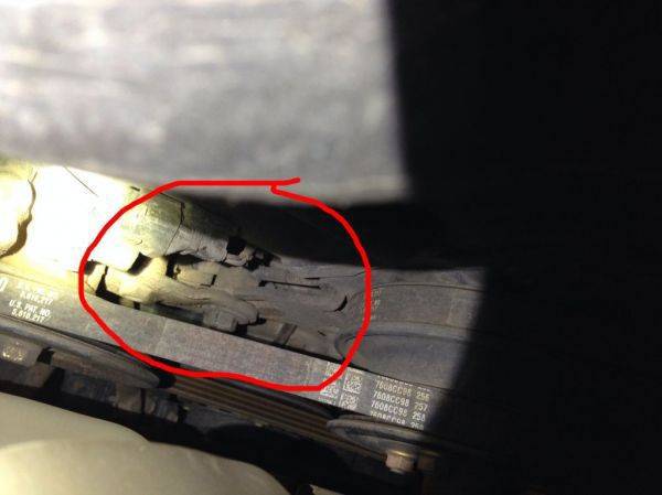

    So.... I messed with that bolt today and went from as tight as it would go to as loose as it would go with no change in pulley tension.. I noticed that the belt that I'm trying to remove is EXTREMELY tight.. more than the other 2. It also appears to be the only one that has been replaced before and I noticed that the number on the belt is different than the one you sent me a picture of. I'm wondering if its the wrong size and that is my problem?? Yours says "7608CC98" mine says "7609BA56". If this fixes the noise without having to replace the pulley or pump that would be nice!! thoughts?

    You have to also loose the bot that hold on the alternator. Put a piece of wood on it and whack it with a hammer. also make sure that the back nut of the tensioner has enough thread showing to allow it to move.
    Belts also strech over use. So id run it. It'll loosen up. Sometimes too much and you'll have to re tighten it. If you REALLY think its WAY too tight. Just go get a longer belt. 3/8'' longer or so.
