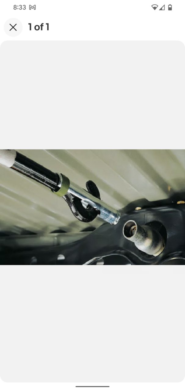

    The silver piece fits on the end of the hook. Otherwise it's supposedly operates as normal. Here's a picture of how the whole thing is supposed to work.

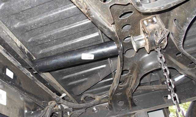

    Any chance of getting that roll pin punched out? I can't imagine you are going to keep this thing........my spare has a hoop through the spokes and a crossmember - and a padlock.
    URL=https://www.tacomaworld.com/media/guide-tube-for-spare-lift.638909/][/URL]
    This is a pipe many have fitted over the years - guides the rod right into the driver.

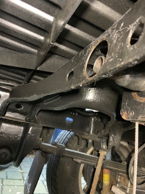

    I have that lock on my 2009 and it works just fine. Looking at your picture the lock socket part seems to stick out way more than mine does which makes me wonder if the thing is fully seated and maybe has come loose from the mechanism. If not fully seated, that would explain why it is spinning. Get under there and see if you can slide it back. I don't recall how these are attached but you may need to adjust it.

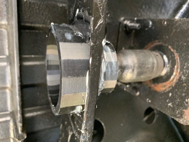

    I also found it difficult to get the key part inserted into the socket working blind from the bumper, so I made a 3D printed part that serves as a guide. You don't have to get the thing lined up exactly. The guide takes it right in, like a USAF fighter jet mid-air refueling probe.
    Have a look at the photos at the link below and you will see how this is supposed to set up. The socket part is essentially flush with the frame cross piece, not sticking out like yours. I'd bet it has slid up such that it doesn't engage the shaft on the mechanism.
    Or... if this is how the device is supposed to fit on your year Tacoma perhaps, as another poster mentioned, there is dirt in the socket keeping the tip from engaging. These things will just spin unless you get that tool inserted.
    Toyota Tacoma spare tire crank lock guide by raylo32 - Thingiverse
    Here is just the photo of the lock installed on my truck before I added the 3D printed adapter.
    With 3D Printed guide
