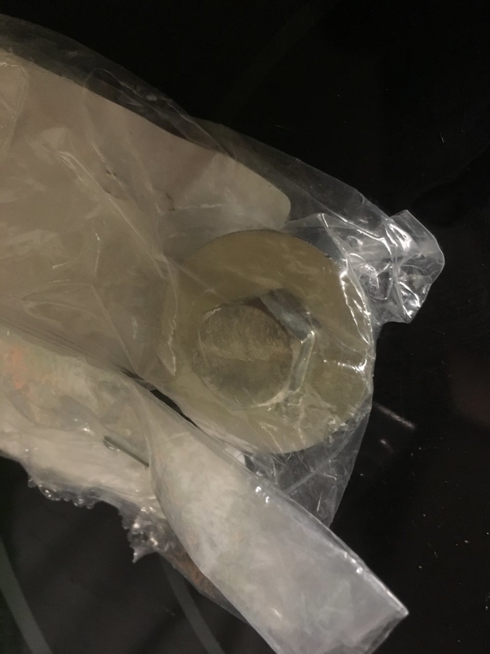

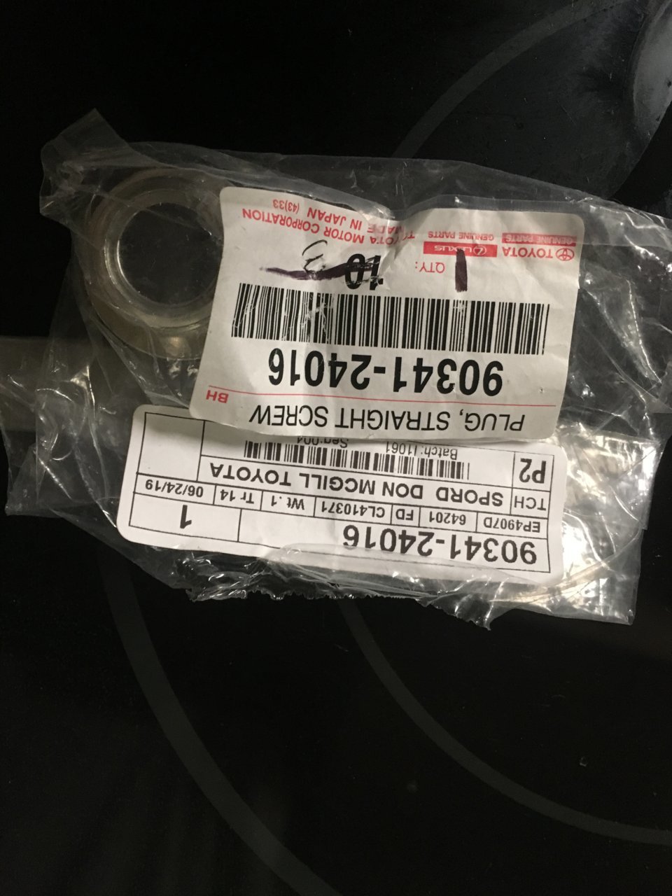

    I saw this some where else on here but can't remember where. There is a Lexus plug for an RX300 or something like that that will work and it has a 14mm head I believe. I called Toyota and they couldn't find it but Lexus had it in stock. It's "Lexus part number 90341-24016 SOP Plug, Straight Screw" and that is what the part number on the bag says. Now just need to find time to get back under there and do it.

    Yep, that's it. Strangely enough though, even if you walk into the Toyota dealer with that part number, they can't get it for you. You have to go to the Lexus dealer to get it. At least that was my experience. But, the crush washer is a Toyota part number that you can get at either Toyota or Lexus.
