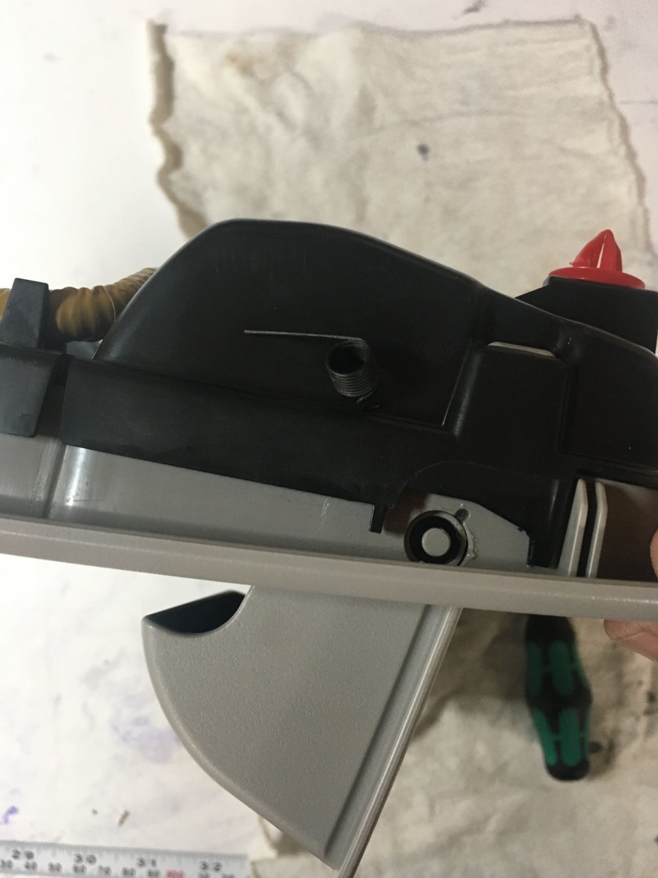

    I know this thread is old, but it's still the top hit for this question. Here's what I figured out (3rd gen), maybe it will be helpful:
    - First, remove the console - pull firmly, many threads about this.
    - On the passenger side, remove the spring that preloads the door. I just flicked it down with some pliers and it popped off.
    - On the driver side, pop the gear out with a small screwdriver (red)
    - Then, pry things apart and slip the pivots out, driver side first. Notice that the driver side pivot has a chamfer, which helps it slide out.
    The gear hole is big enough to slide connector through, so you don't even need to drill for a switch panel cable!
