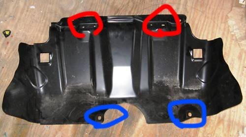

    Step (1): skid plate - there are two 13mm and two 12mm bolts holding up the skid plate. Skid plate weighs roughly 20 pounds. Can be held up with forearms, or another person if not strong enough. The two bolts furthest under the truck have 2 collars on the interior of the skid plate (can't be seen), don't lose those.
    Pictures were hard to get so I'll use one of it being off also.
    The 12mm are the front most bolts circled in red. And the 13mm bolt location is circled in blue

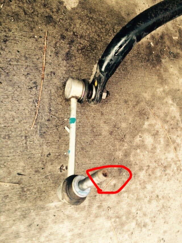

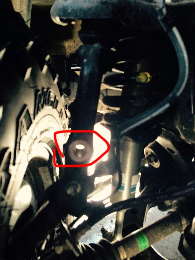

    Step (2): removing driver side end link - when working on the driver side, turn the wheel full lock to the right, this allows for a bigger area to work in. Insert the 5.5mm Allen wrench into the whole at the end of the end link connected to the sway bar. Use the 17 mm wrench to loosen the nut (I loosened the nut by holding the wrench and hitting it with a rubber hammer to get to to budge. Some people say spraying with WD40 helps also). Once the nut is loosened, you can hold either the wrench or Allen wrench, and loosen with the other. Once the nut is off, hit the bolt with the rubber hammer until it pops out of the spindle.
    Red circle shows where the Allen wrench inserts, and around this bolt would be the 17mm nut
    9EA9C756-89B4-4BDB-900C-F7BEE1511D58_zps_2a0cff5ae6e7956199e350d4ffe3454a348125dc.jpg
    This picture shows where the end link connects to the spindle. The big hole is obviously where I removed the end link bolt

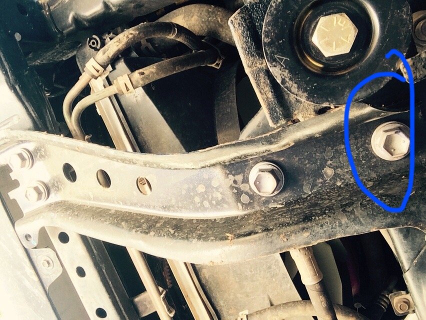

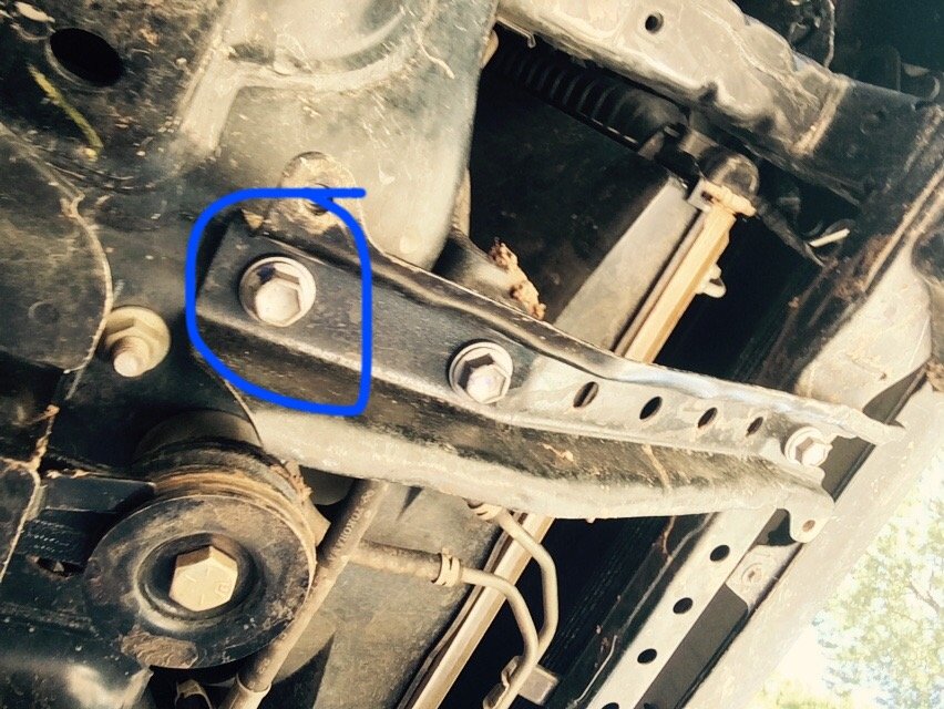

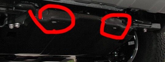

    Step (4): Loosening the cross members - once you removed the skid plate, you may of noticed 2 members that go from the frame to the front bumper part of the frame. These two members inhibit you from removing the sway bar. You can either completely remove these two (one with 3 bolts, one with 4 bolts) with the 18mm socket, or you can remove all the bolts except the bolts furthest under the frame. If you choose to suspend the members, you remove all the bolts except the furthest bolt on each member. This bolt you want to loosen until there is a 3inch gap between the members and frame where they bolted to. This allows for enough space to remove the sway bar, but takes a little more finess.
    Here are the pictures of the two members, the bolts circled in blue are the ones I used to suspend the members, but can easily be removed for it all to be out of the way.

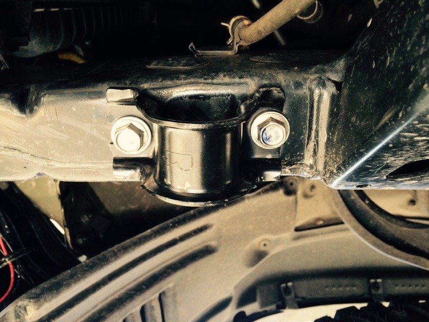

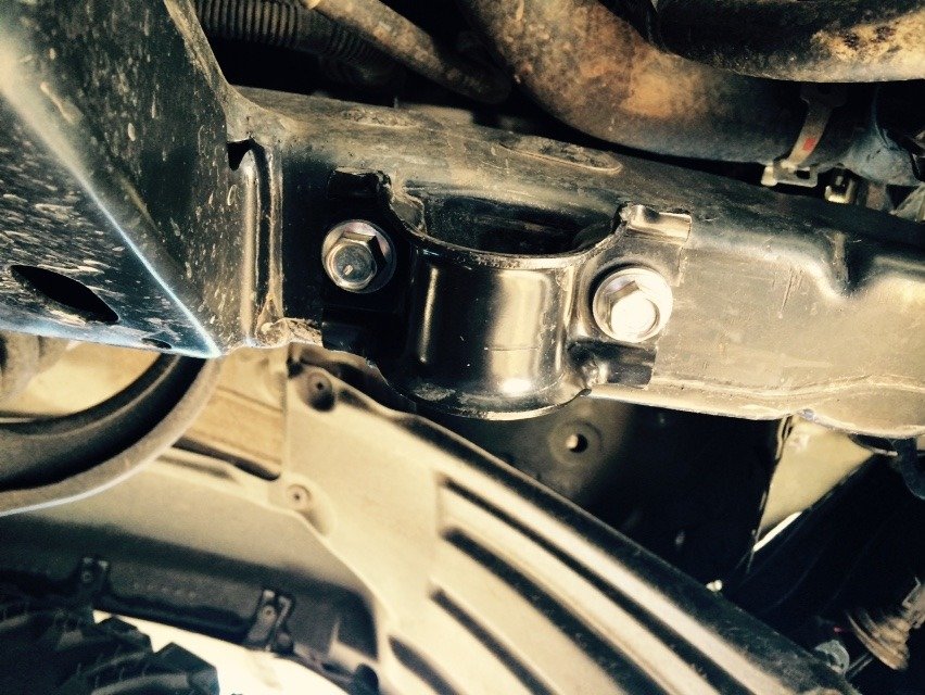

    Step (5): loosening the sway bar - there are two U shapes plates that are holding up with sway bar. There is a rubber piece between the plates and the bar, with two bolt per plate. Remove these 4 bolts with the 14 mm socket, this will allow the sway bar to fall free, so be aware the sway bar weighs roughly 40 pounds.
    16AC1F77-EE1D-4888-AF83-0EE769D94340_zps_8591358dc6d31aaf758977e514f4be8af352e5e2.jpg
    7604D02D-5F99-4125-8C4D-71FBB00B5D53_zps_d64b6d02d11dd257e45ecae972ca78467e604a24.jpg

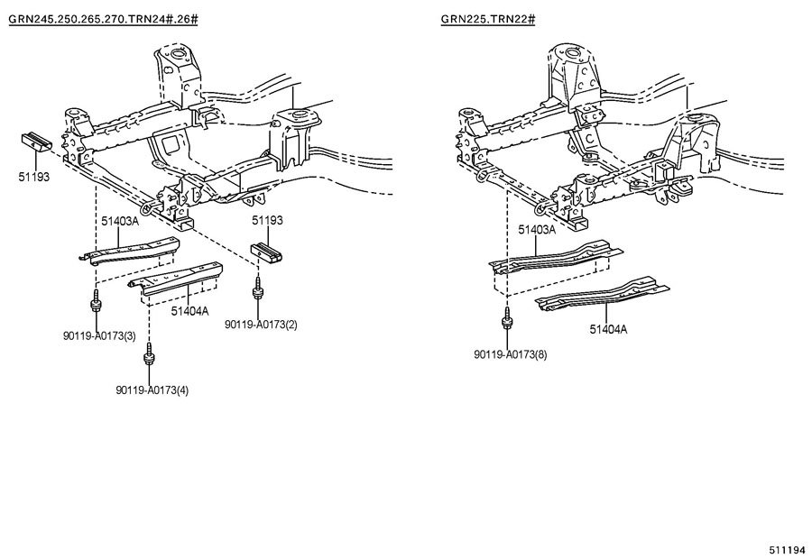

    Added note from another member DoorDing;
    Drop the IFS skid and both "Brace Sub-assembly, Front Suspension Members" (Part #51403A & 51404A), then remove the stabilizer bar. It's a lot easier than dicking with it flailing around. To reinstall, lay the stabilizer bar on the floor, rotate the end links into position, and loosely attach them to the steering knuckles. Pivot the bar on the end links to get it into position, and mount it to the frame. Brackets are side specific. Install the braces. Best data I could find indicates the bolts should be torqued to 60 ft/lbs.
    (See Steps 5 & 9).
