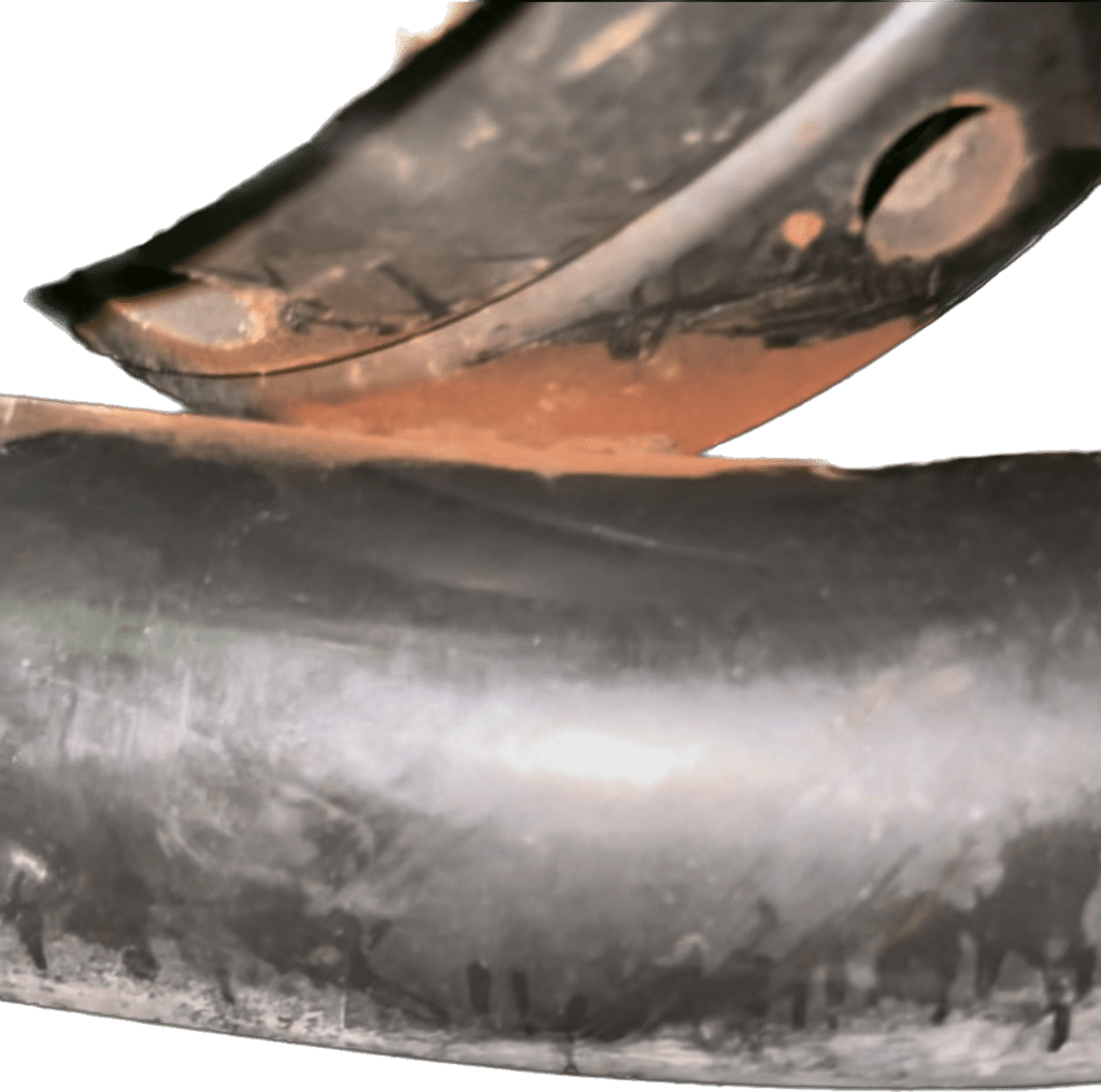

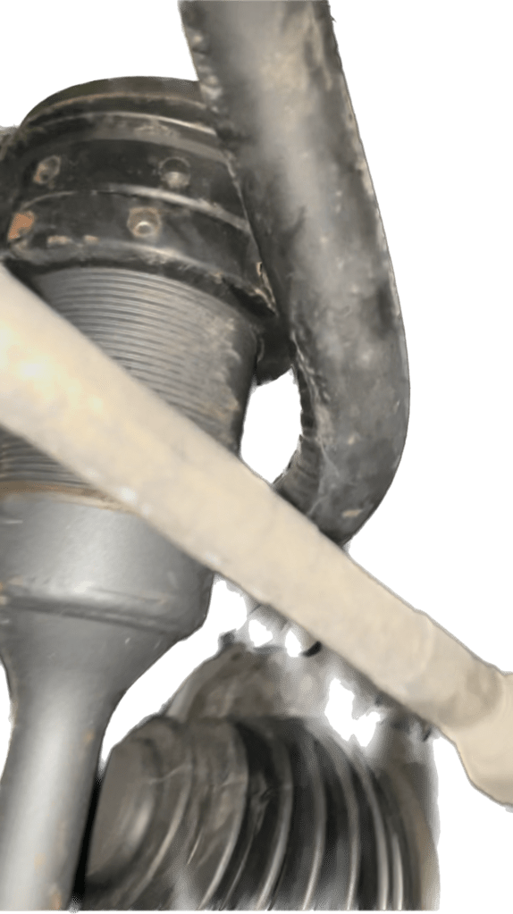

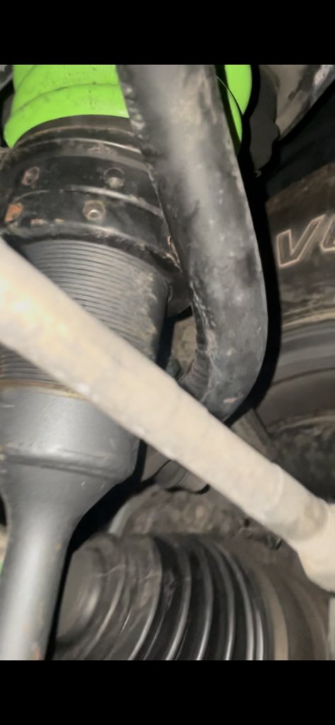

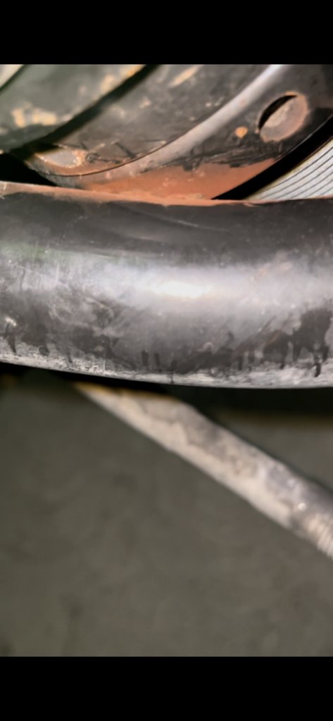

    Pulled the trigger because I noticed signs that my sway bar made contact with my Ironman foam cell coil overs.
    I believe the UCAs would have solved this issue but that’s not in my budget right now.

    Sorry for all the extra photos!! I had some struggles and thought I deleted those
