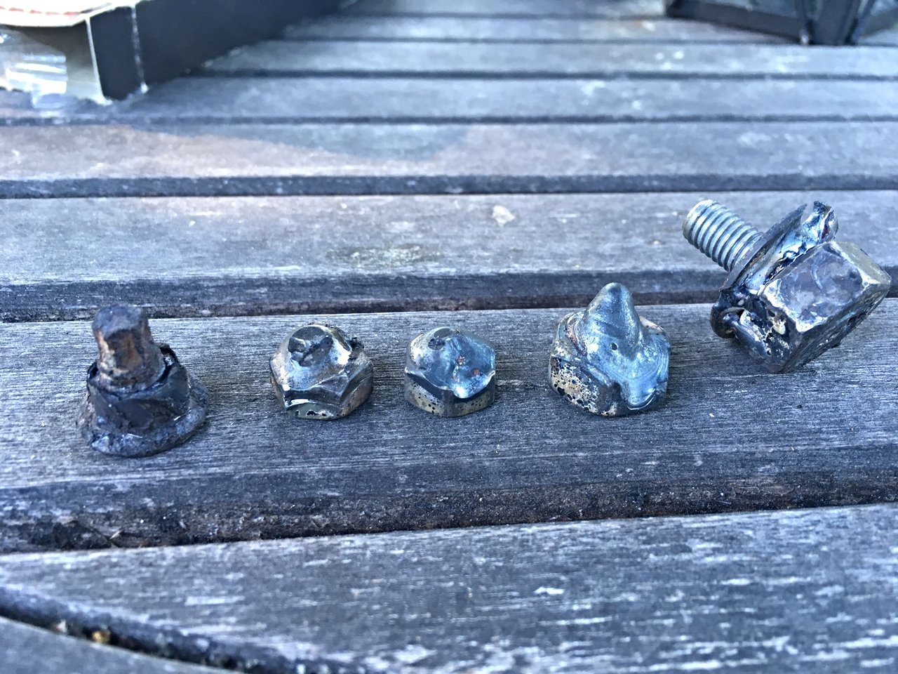

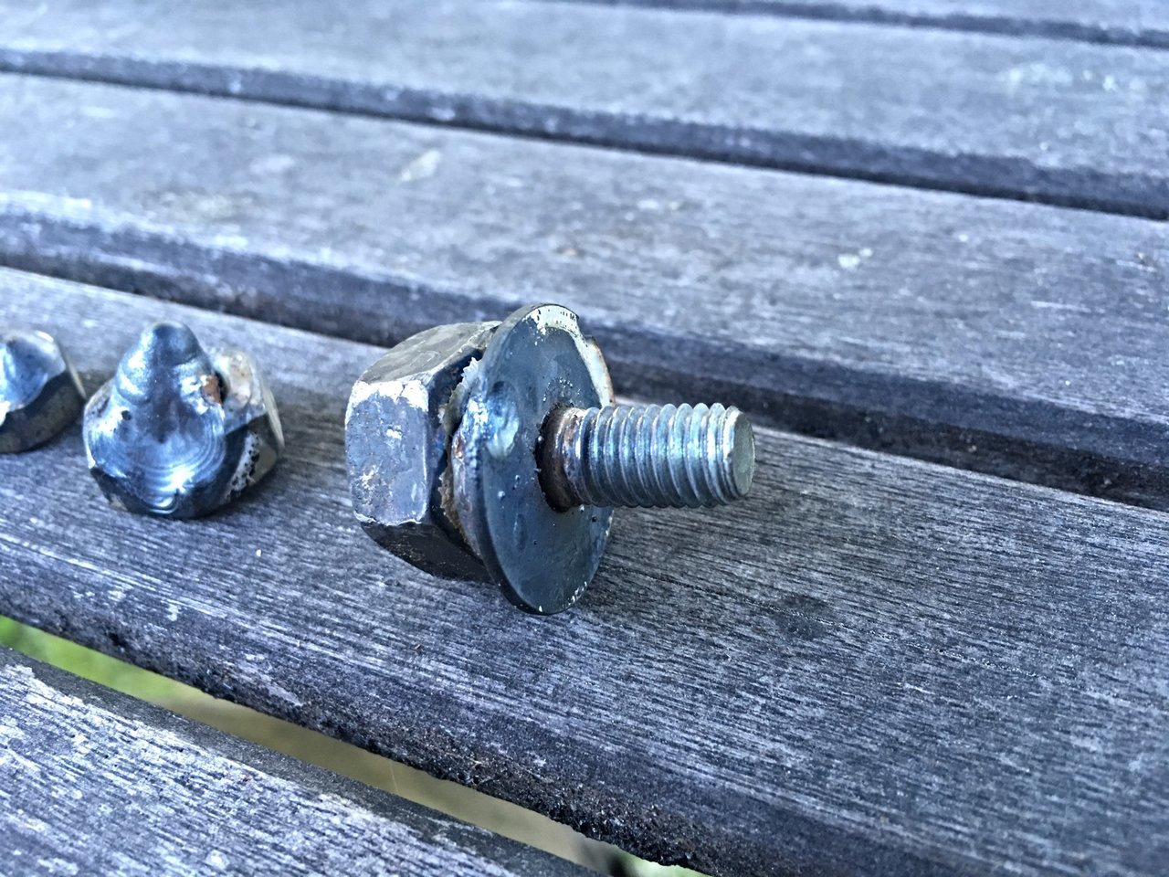

    Well... started to change the URD headers I bought. Quite a job to get the old exhaust out, 11 years and 130k miles at an area where is winter and salt. You can guess that the rust is a big problem.
    Despite of heating (by a little gas welding torch) every exhaust manifold nut before turning, one stud snapped.
    Few tries with a MIG and nut and I got it out.
    I have already bought ARP stainless steel studs and I'd like to install them. But I have not courage enough to try to turn the old ones out, I think I'll snap more of them and getting them out by welding is really, really PITA. They are really stuck, I don't like to turn more.
    Any tricks what to do? I know some induction heater would be nice, but I don't know where to borrow/rent one.
    And why they are so stuck? The snapped one's thread looks great.
    Or maybe I just use the nuts&washers of ARP's set, they become a little thicker than OEM nut, so no thread is visible/exposed to rust. With a copper paste they would work.

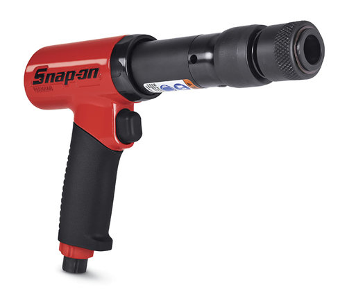

    ^ What's that gun?

    air hammer haha

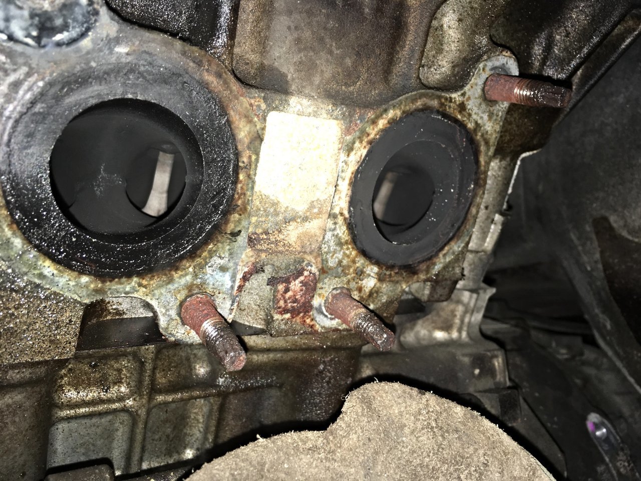

    Did you have as corrosied/rusted studs? I only changed the broken one and left the rest, I felt I may snap them too. Installed the new headers with the ARP nuts.
