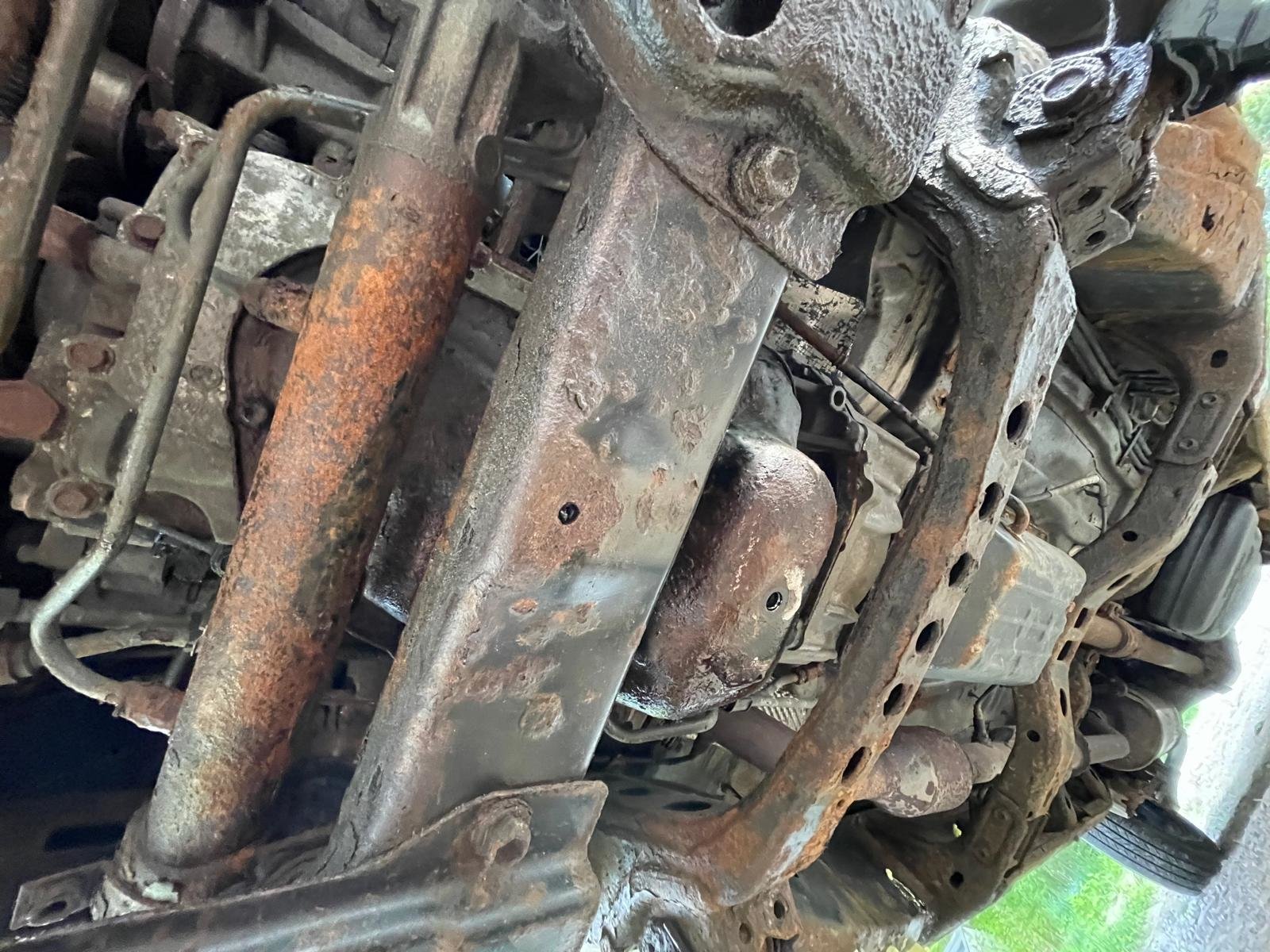

    Have you carefully inspected the rest of your frame and the ancillary attachments for rust failure?
    Only asking because an oil pan rust out indicates a real corrosion problem, and it would be a shame to spend the $ and time for a pan change of the frame is near failure
    Pictures?

    Valeri67
    Valeri67 [OP] New Member
    May 15, 2024
    #449767
    3
    Valeri
    2009 Toyota Tacoma

    That frame looks scary. Unfortunately the worst corrosion is often inside where dirt and salt collect and it never dries out.
