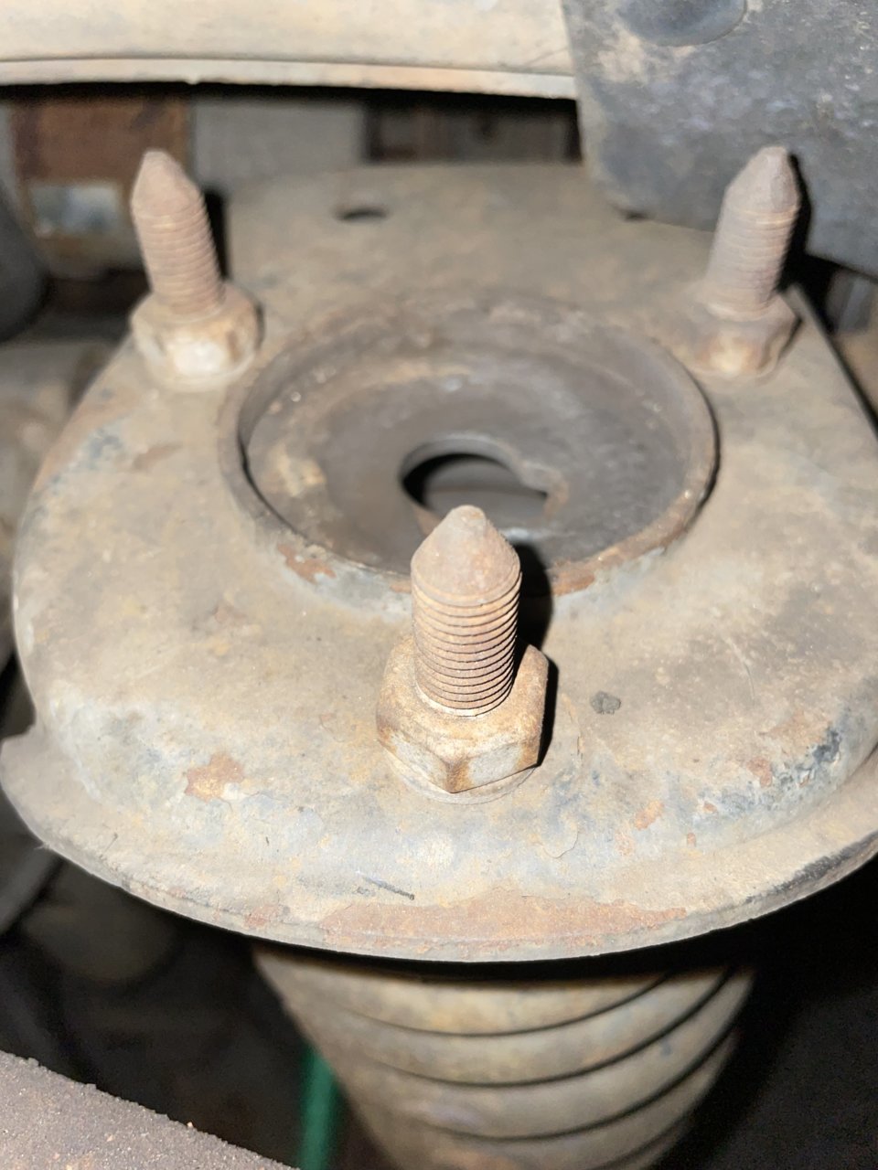

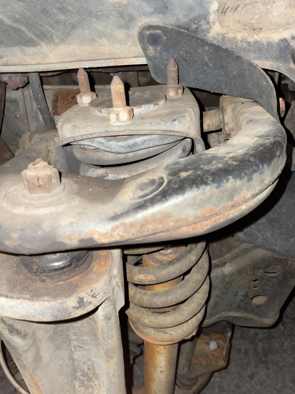

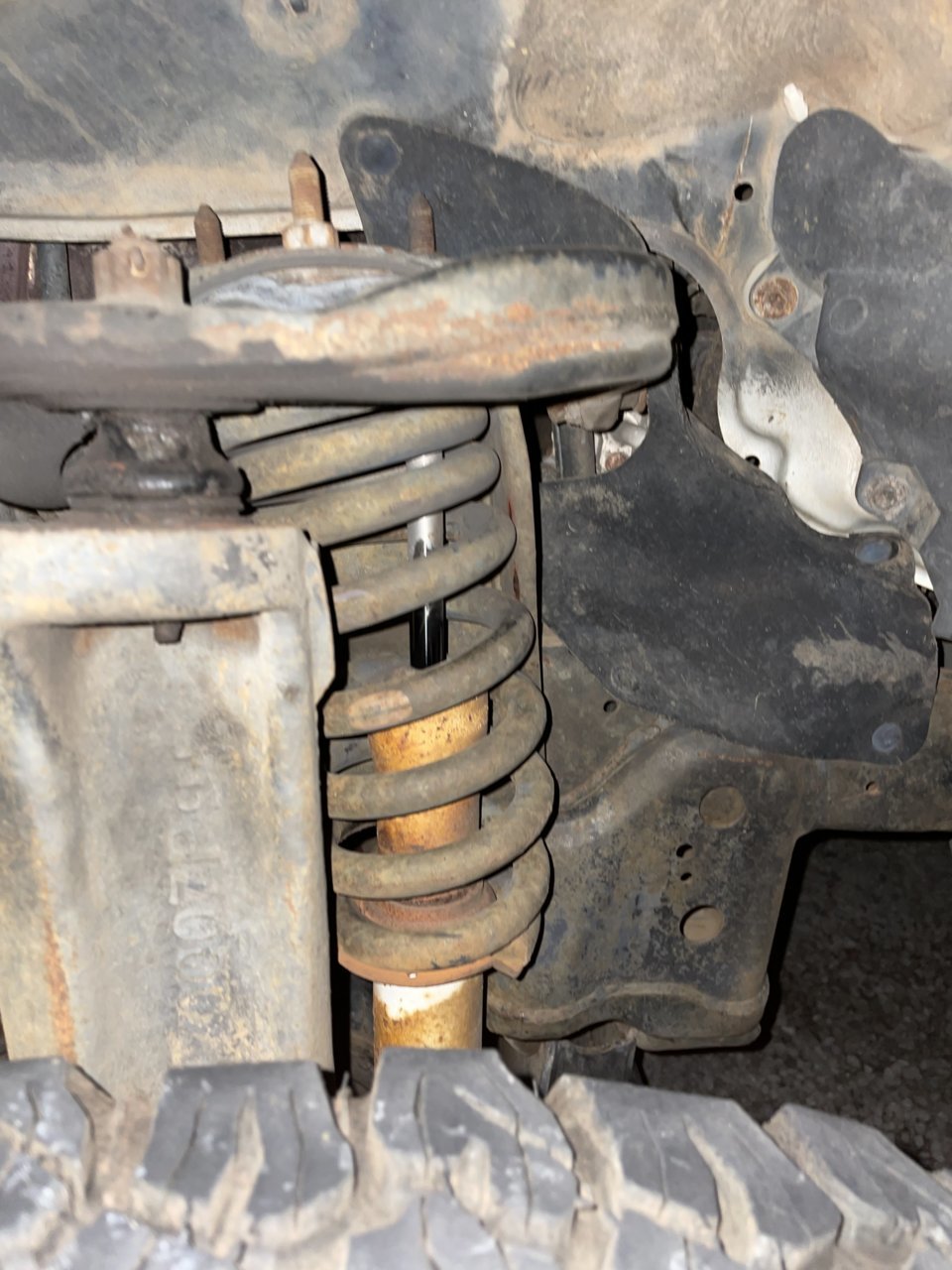

    Is there a way I could remove the strut safely? I would imagine that the pressure on the spring is resting on the top hat and the bottom mount which would make it difficult and dangerous to remove… thanks….82757784-CCD0-48B0-BB34-39D2C5294D94.jpg 95CAB103-499E-4010-A395-E96B35BE9A67.jpg B6BA339A-F451-4C83-BC36-F85B412F5842.jpg

    Wow, thats nuts. It be afraid the spring would let go. If you do it yourself id want to attatch some spring compressors to the spring first. But, may be better off paying someone to do it. Id dont want to see a news article about some guy that lost his eye and right nut to a broken coilover removal.

    Do the following at your own risk. This can be dangerous.
    I think you could jack the truck up.
    Place it on jack stands.
    Take the jack and place it under the lower control arm. Jack it just enough to relieve pressure from the shock bolt. -BE CAREFUL HERE- Disconnect the lower control arm from the spindle. The. Let the pressure of the jack. You’ll also want to loosen the LCA bolts.
    This could be dangerous. So do it at your own risk.

    The shaft is about 3/4 the length it should be…it snapped when I was wheeling

    As soon as you Jack the truck the spring looks like it'll fall out. So the only thing keeping the spring in place is the weight of the truck since the shock shaft is already broken.
    Might need to loosen the the lca bolts to let the arm swing away. But the shaft breaking means you already relieved the tension on the spring

    Since the shock is what limits the down travel, but now the shock is broken, all you'd need to do is jack the truck up until it droops enough for the spring to loosen. It probably won't even be enough to make the CV bind up, but since it's not moving that probably won't be a big deal.

    okay sooo….. I ended up doing it by myself, I jacked up the truck and let lca droop as far as it could then I proceeded to remove the top three nuts. Once I got them off I loosened the bottom bolt and placed a pry bar in between the mount and lca. I then took the bolt out and carefully removed my pry bar and………it shot out like a mf.. for anyone in the same situation as me I 10/10 recommended you to take it to a professional, I was just too damn hard headed and didn’t wanna spend the money
