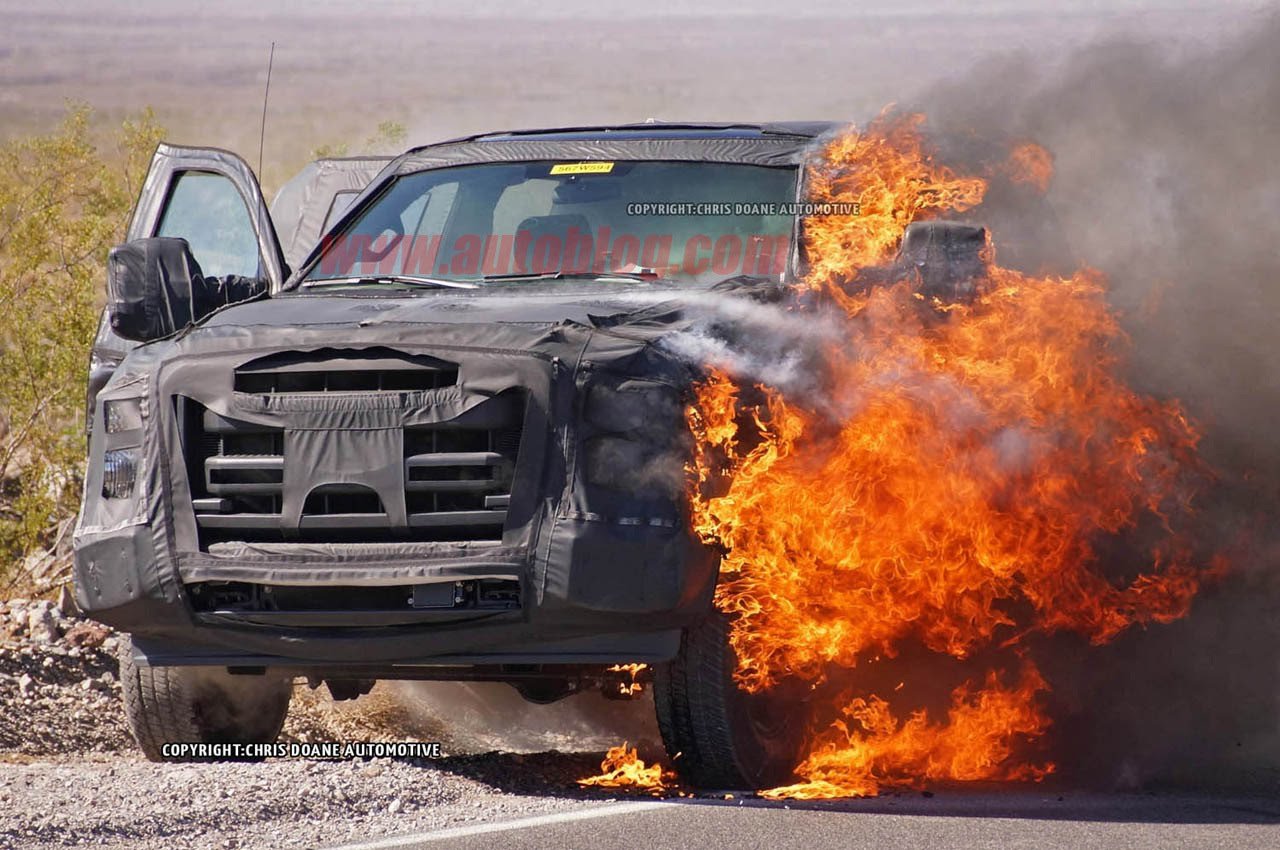

    Well, they wrap test cars in camouflage material when they test drive new model trucks and cars in Death Valley, but I don’t think wrapping with flammable materials is that good of an idea...
