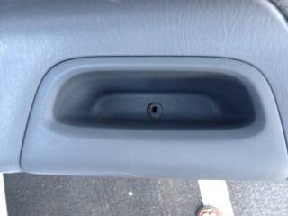

    Start by using a phillips and unscrewing this screw
    Using a phillips unscrew this screw
    Then remove this plastic holder by pressing in the middle indent with the phillips then use finger nails to pry out

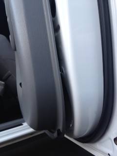

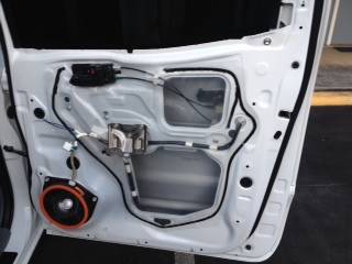

    Now starting at the bottom sides of the doors where you feel you can get your fingers in the crease between the door panel and the frame pull straight out, you will hear a pop.

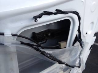

    Work your way around the door bottom up the sides(There are none on the top edge where the window is) now lift the panel straight up toward the window, be careful it will still be attached by some wires to the power window button, you can either unplug the wire like i did and remove the whole panel or let it hang gently.
    as long as you have access to this space

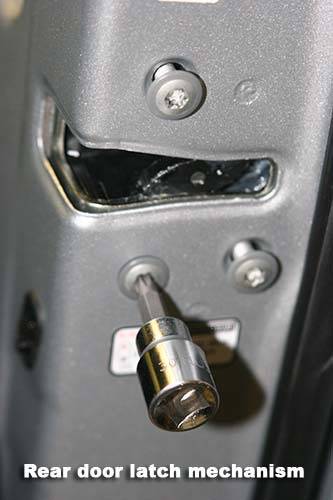

    Now take the torx and remove these bolt completely

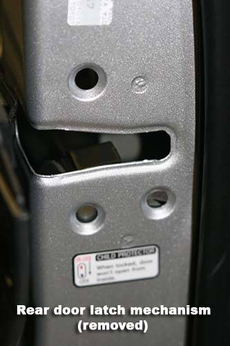

    Then reach inside here
    and move the latching mechanism down like this

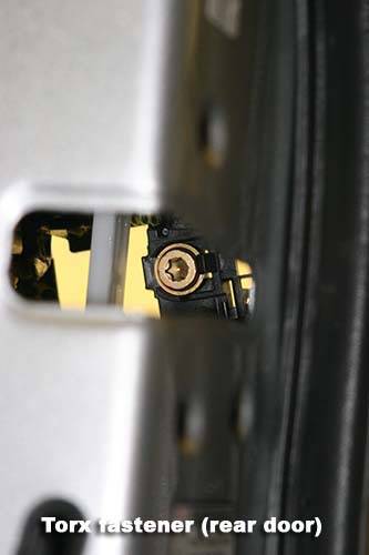

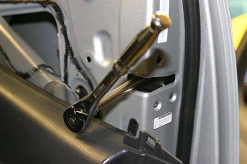

    Now you can see the torx you need to loosen
    Now put your torx bit in the extender and loosen, it wont fall out as it has a retainer clip.

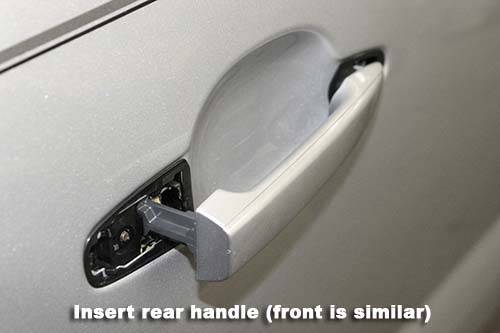

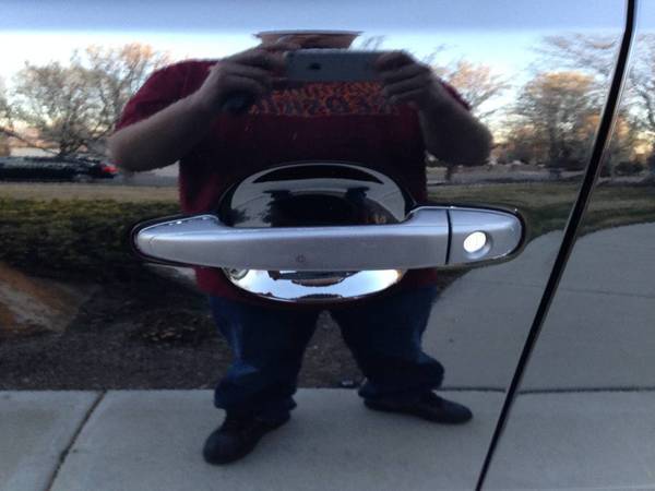

    Now Remove the little lock cover piece by slightly prying then getting your nails under it and wiggling straight out, just like the front doors. Then remove the handle by pulling back and opening.
    Replace the color matched handle by putting the front end in first then the rear. Then put the lock cover on and secure it with the Torx and the extender, then put the latching mechanism back and secure it. Follow all the steps in reverse to reinstall the door panel.
