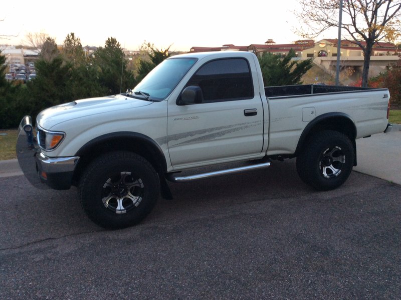

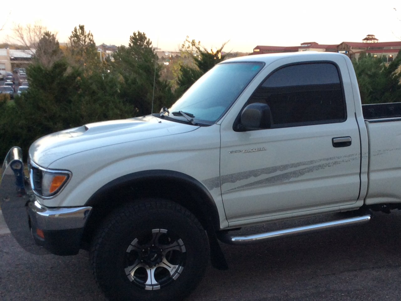

    Buy only the OEM mirrors, I replaced my old small mirrors with 2004 mirrors,
    They work perfectly, no rattles, no vibration, no issues, just a new coat of paint
    and now after the car wash I don't have to try and adjust the mirrors anymore
    and they fold away if needed

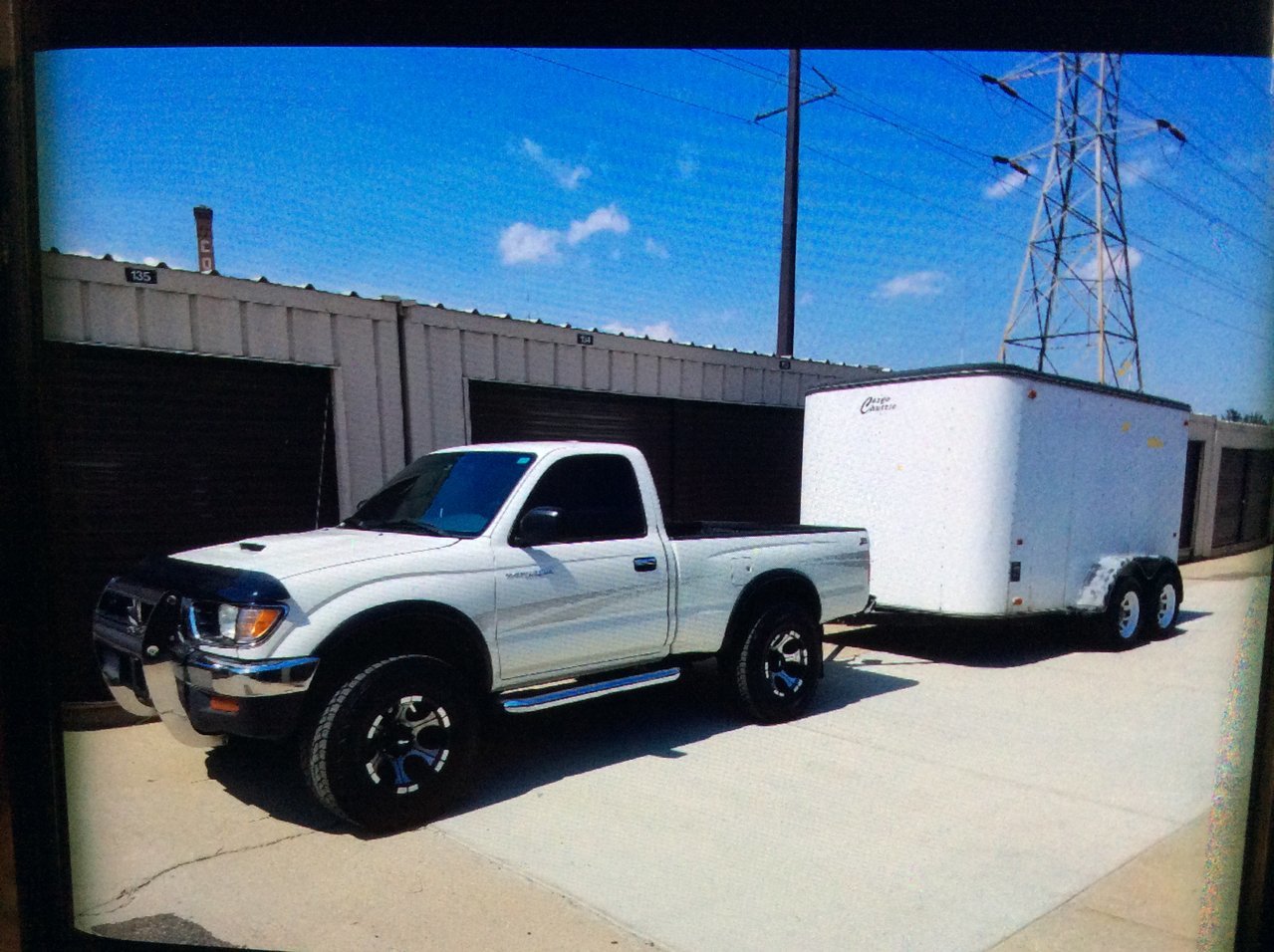

    If you have a trailer these 2004 mirrors will definitely help as they are larger footprint, they are OEM, they fold away also and snap back to THIER original position when snapped back, no adjustment needed unlike the original mirrors that
    need adjustment every time they get bumped
