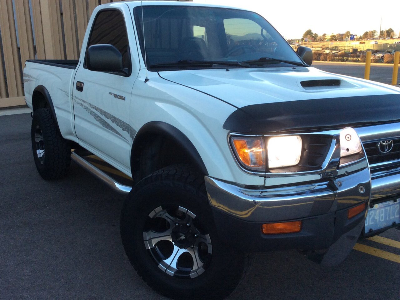

    Let me think about it, I would need a control remote and to be honest once I set the mirrors I have not had to adjust them because they sit inside the housing

    Mine were electric off a 2004 Tacoma
    I dont need the electric parts.
    Once you set the position it doesn't move.
    If the mirrors get hit the mirrors break away and snap back into their original position

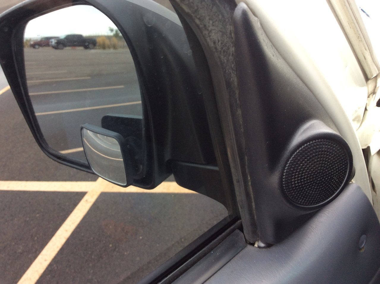

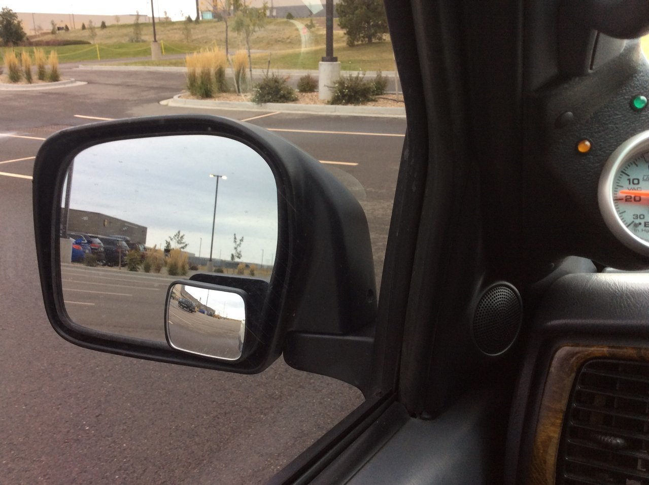

    The hood was from a 2000 4runner,
    The pillar pod speakers were 4runner
    Mirrors were 2004 Tacoma
    The mirrors were from a 2004 Tacoma and were electric but I didn’t wire them up
