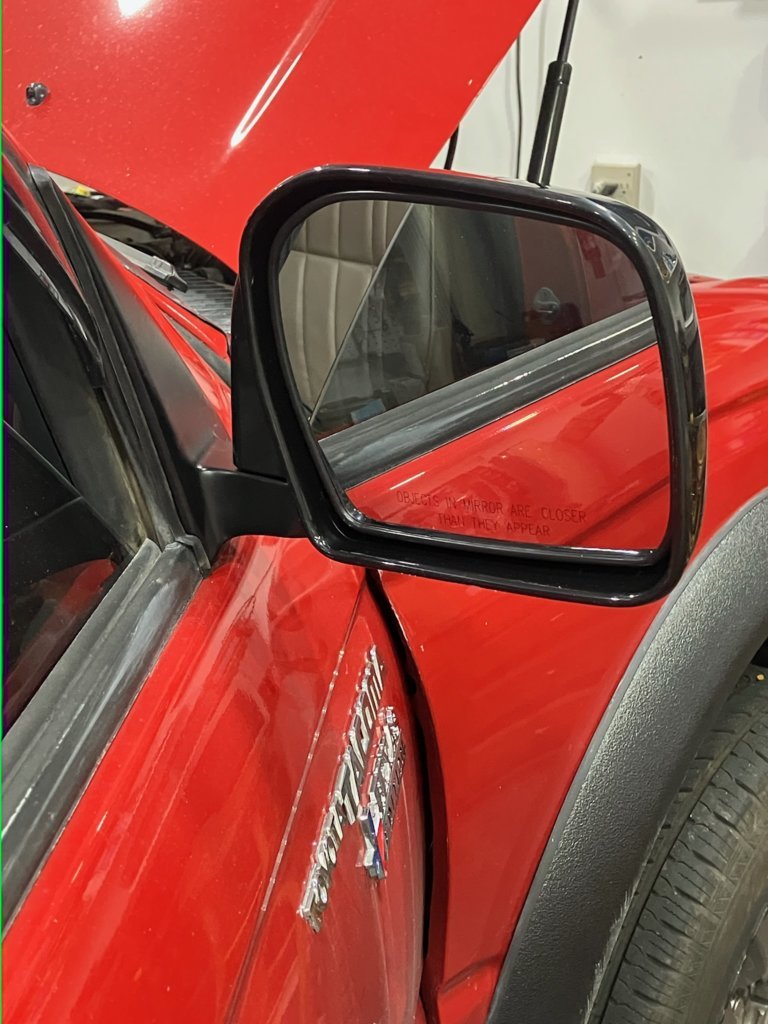

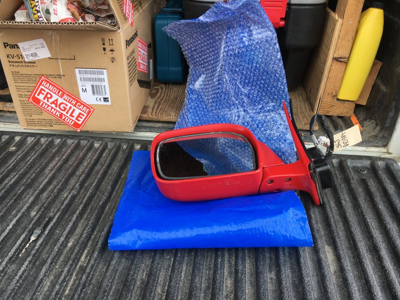

    8701331B-5BC8-42AA-AF31-97425B668BB3.jpg Well, I picked up a set of power mirrors off of a 2000 4Runner, wrong color but that can be changed.
    It took a slight modification to fit-the LH mirror, probably the same on the RH side. There is a small sheet metal screw and socket, that I had to drill a hole for, some wrestling with the bolts from the original mirrors but the first one fit pretty good.
    I will try the second tomorrow, if everything goes well, then pull them both off and sand them and paint them semi gloss black.

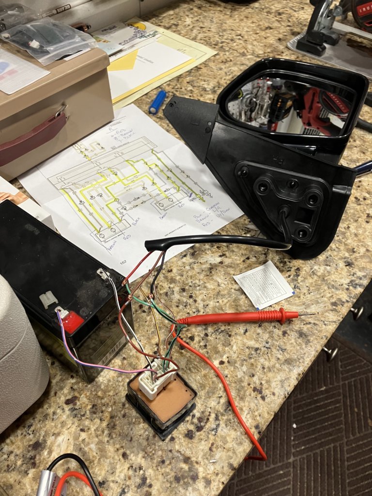

    I have bought other TRQ parts and they have been decent quality. I'll be sure to let y'all know if these vibrate at highway speeds and they will get returned to Amazon. These mirrors have Red, Brown and Black wires. The RED wire is the common wire for these mirrors

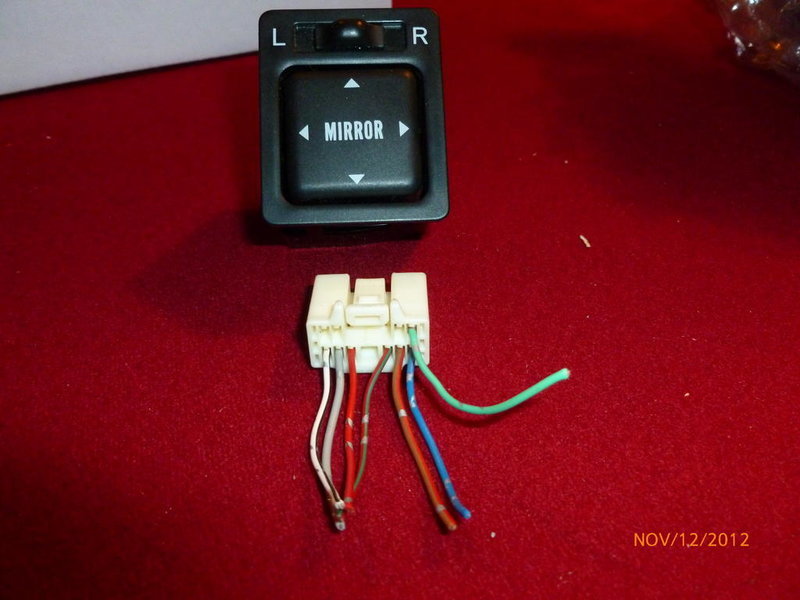

    The switch I got was the Camry switch that looks like this one. It has 10 pins.
    I just finished confirming the switch and mirror wires for my mirror and switch combo and here is the pinout:
    Left Mirror:
    Red to Pin 6
    Brown to Pin 5
    Black to Pin 1
    Right Mirror:
    Red to Pin 6
    Brown to Pin 8
    Black to Pin 7
    Pin 10 = Ground
    Pin 9 = Accessory Switched +12V

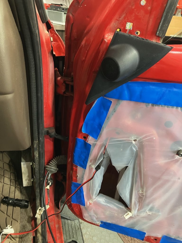

    I used this three conductor 16gauge wire for my mirror runs to the switch:
    https://amzn.to/3UtTKml

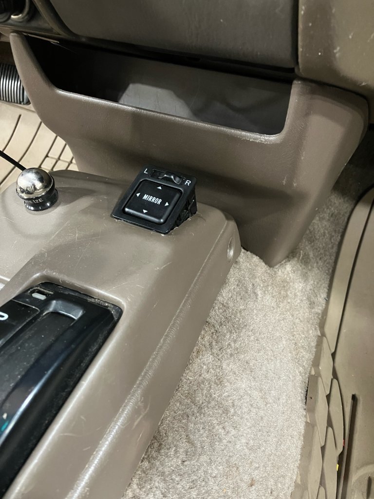

    The project is complete and ops checks good on both mirrors. The switch had to be mounted at an angle to clear shifter structure underneath the cover. My clock is now a functioning voltmeter display so I was unable to use a clock delete plate for the switch location.
    since I had the door cards off to run the mirror wires I replaced my non-functioning door checks and now have doors that don’t close on my leg.
