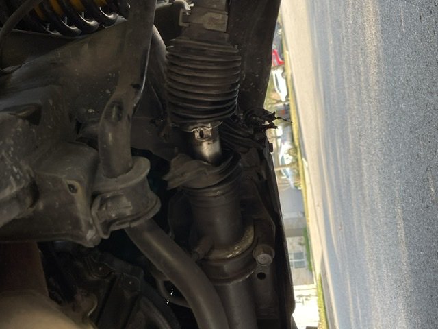

    I’ve done about 50,000mi on this torn boot, and something is starting a low squeak whenever I turn. Not sure if it’s because the rack is going out, or low power steering fluid. Are there any guides on how to replace this boot?

    If the boot has been shot for 50K miles my guess the CV joint is (also) shot.

    That’s the steering rack, not the CV.

    If the steering Rack has been exposed to dirt and road slop for 50,000 miles I venture you have more to worry about then just the boot.
    Simple to replace remove the inner tie rod and slip the new one on. Depending where the truck lives getting the Jam nut(lock nut) loose can be exciting.

    Take care of that quick; that could turn out to be a "where's the cheapest place to buy a new steering rack..." thread.

    Rack and pinion OEM is surprisingly cheap online… only $530, I thought it would be closer to $1,200. I’ll fix the boot until the rack gives out
