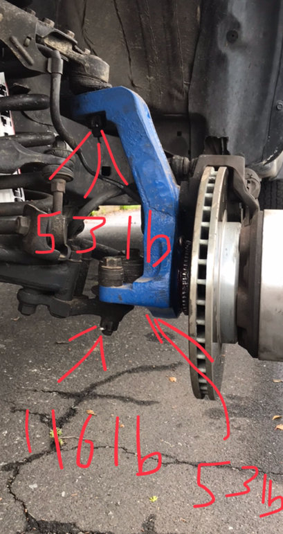

    This is to show how to replace upper and lower ball joints on a 5lug tacoma
    (Note i hve lifted spindles but al steps are the same for a stock truck)

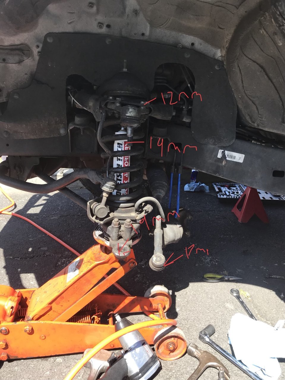

    12-19mm wrench
    10-19mm sockets
    Tourqe wrench
    Breaker bar
    Impact gun

    1. Jack up truck
    2. Support with jack stands
    3. Remove tire

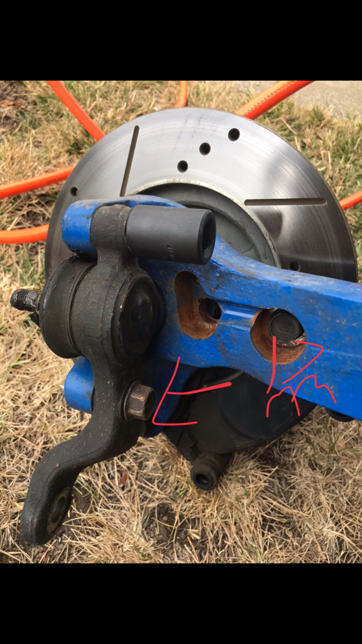

    4. Use 17mm wrench and remove caliper and hang to the side

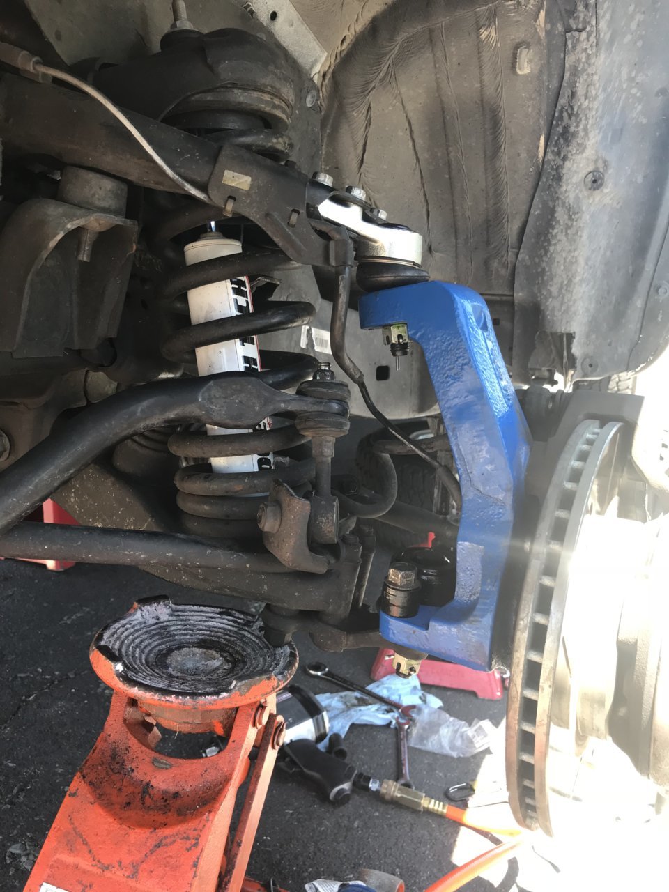

    5. Support lower control arm with jack
    6. Use 10mm socket ti remove abs sensor ( for models with abs)
    7. Remove all cotter pins
    8. Use 17mm wrench and remove castle nut on tie rod, then break free tie rod.

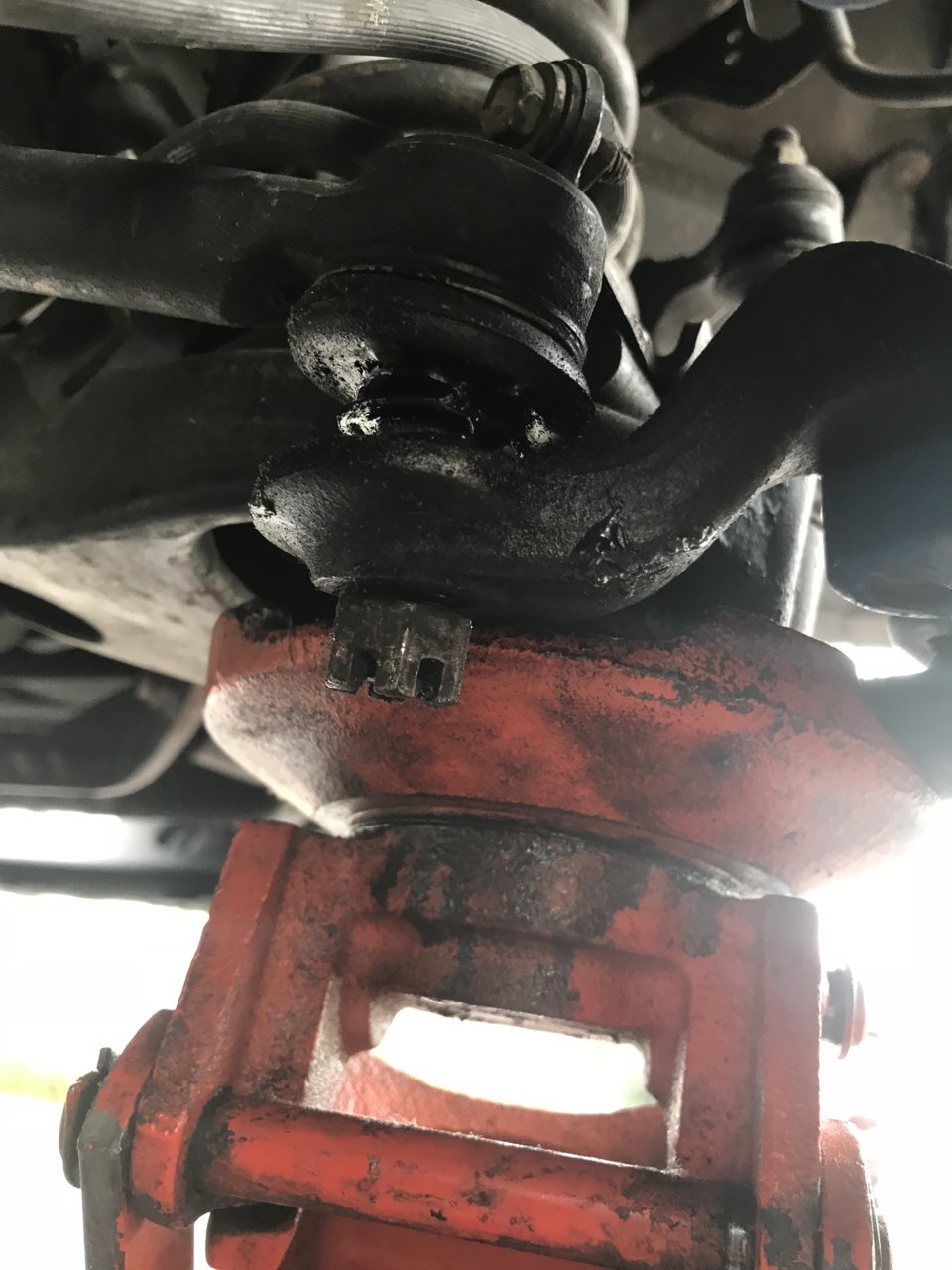

    9. Use 19mm wrench and remove castle nut on lower ball joint then break free ball joint.
    10. Supprt spindle with cord so it wont fall
    11. Use 19mm wrench and remove castle nut on upper ball joint and break free
    12. Place spindle to the side
    13. Use 12mm socket wrench and remove 4 bolts holding ubj too control arm
    14. Use 17mm wrench to remove lbj fron spindle
    Now you have everything disassembled, clean all parts that are going back on your truck
    And get everything ready for Assembly

    1. Place lbj on spindle and tourqe to 116ft lb
    2. Attach ubj to uca and tighten
    3. Place spindle on lca and hand tighten the castle nut
    4. Place ubj into spindle, i found using a crow bar to push the uca down into place works well, then hand tighten castle nut
    5. Place tie rod on lbj bracket, hand tighten castle nut
    6. Tourqe ubj and tie rod to 53ft lb
    7. Tourqe lbj to 116ft lb

    11. Reinstall caliper
